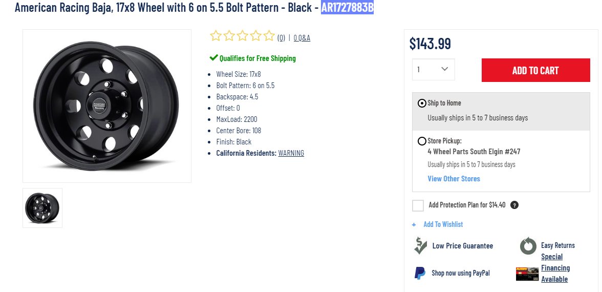

    i have the 17s, but i am planning to rotate tires this weekend and can look to see if there is room and report back....

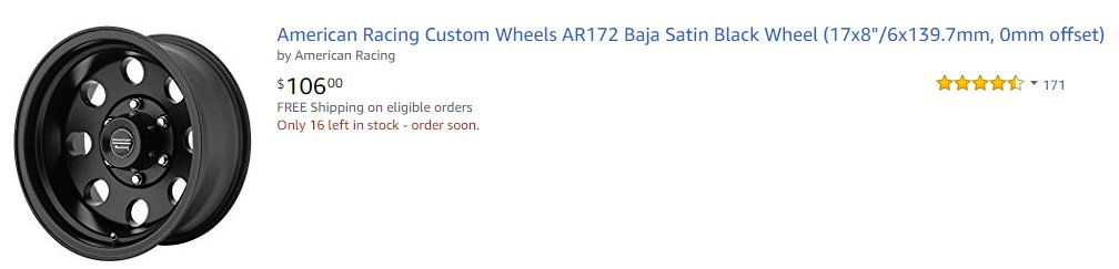

    fyi i was able to get 4wheelparts to match the Amazon price which was the cheapest I could find....

    Thanks I would appreciate it! Do you know what your off-set and backspacing was on your 17's?
    And I will have to checkout Amazon on pricing, thanks for the heads up.

    upload_2018-10-2_9-52-45.jpgere you go.

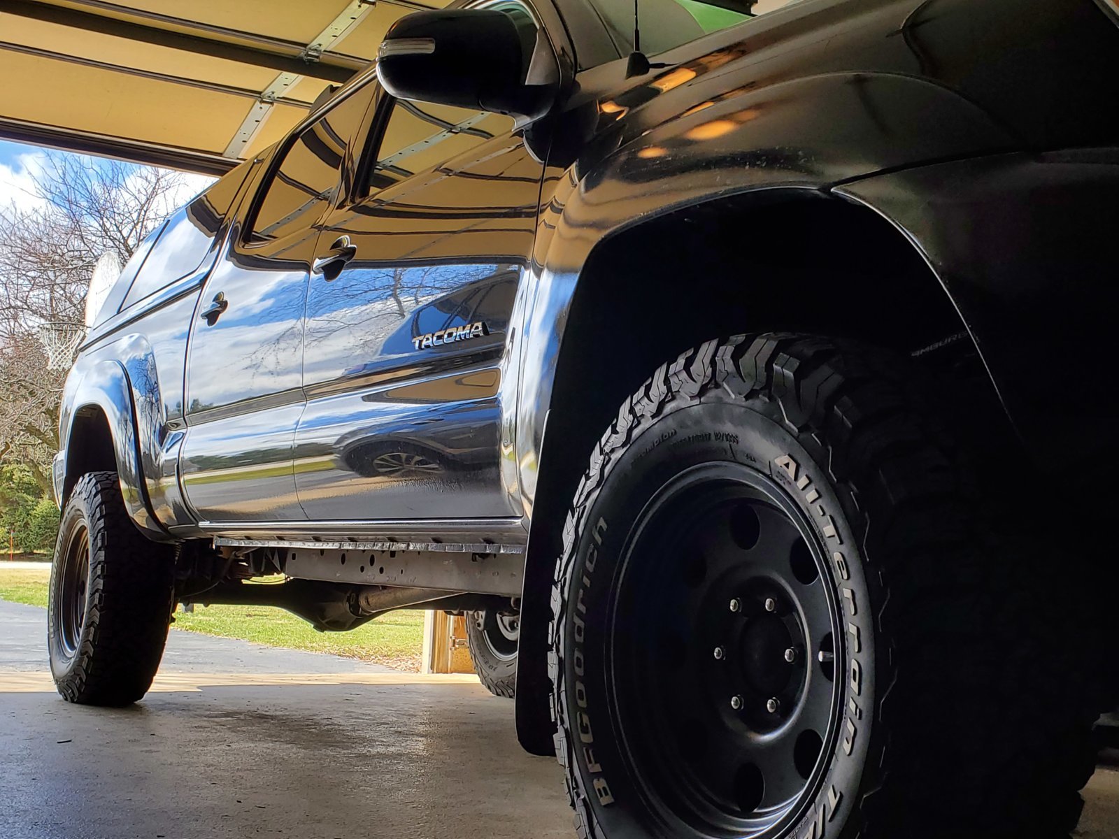

    Thanks for the input. I see that Amazon actually has the 16x8's for $88.25 and free shipping..... very tempting! Are you on a stock suspension with the 265/75/r16 tires? Any rubbing or issues?

    Yes, stock suspension.
    A little rubbing on the back end of the front wheel well during tight turning over a bump, but trimmed it with a utility blade and painted the white part of my truck that you could see with matte black farm equipment paint... can't tell at all.

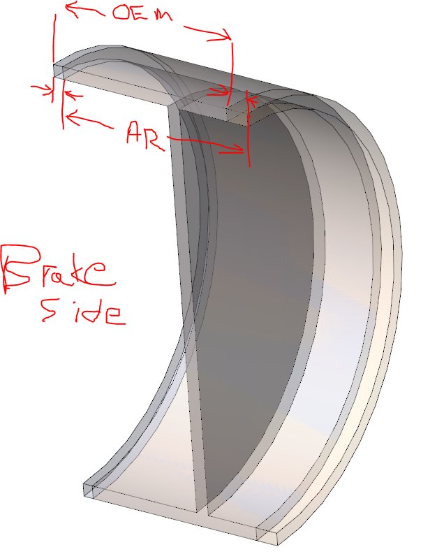

    ..... I assumed you were looking for the clearance over the brake caliper....way back when i was considering these rims, I took the measurements and drew the OEM vs the AR172 and overlayed them to see the difference.....these rims give additional clearance between the tire and UCA (roughly .4"-.5" more - if I recall correctly with OEM rims, there was barely enough room to put my finger between the tire and UCA) .....as well as stick out farther (roughly.9"-1.0"), giving about a 2" wider stance....... I never measured to confirm my calcs when all was said and done, but it was right in line with what i had expected to see.... my suspension is not stock so I can't speak about rub.... hope this helps...

    Yes my exact concern is the brake caliper. Thanks for the sketch and the clarification. Your thinking is the same as mine.
