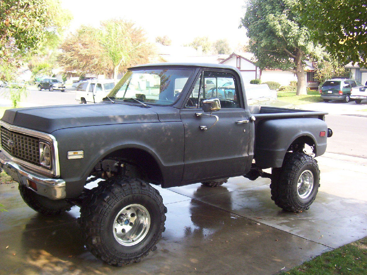

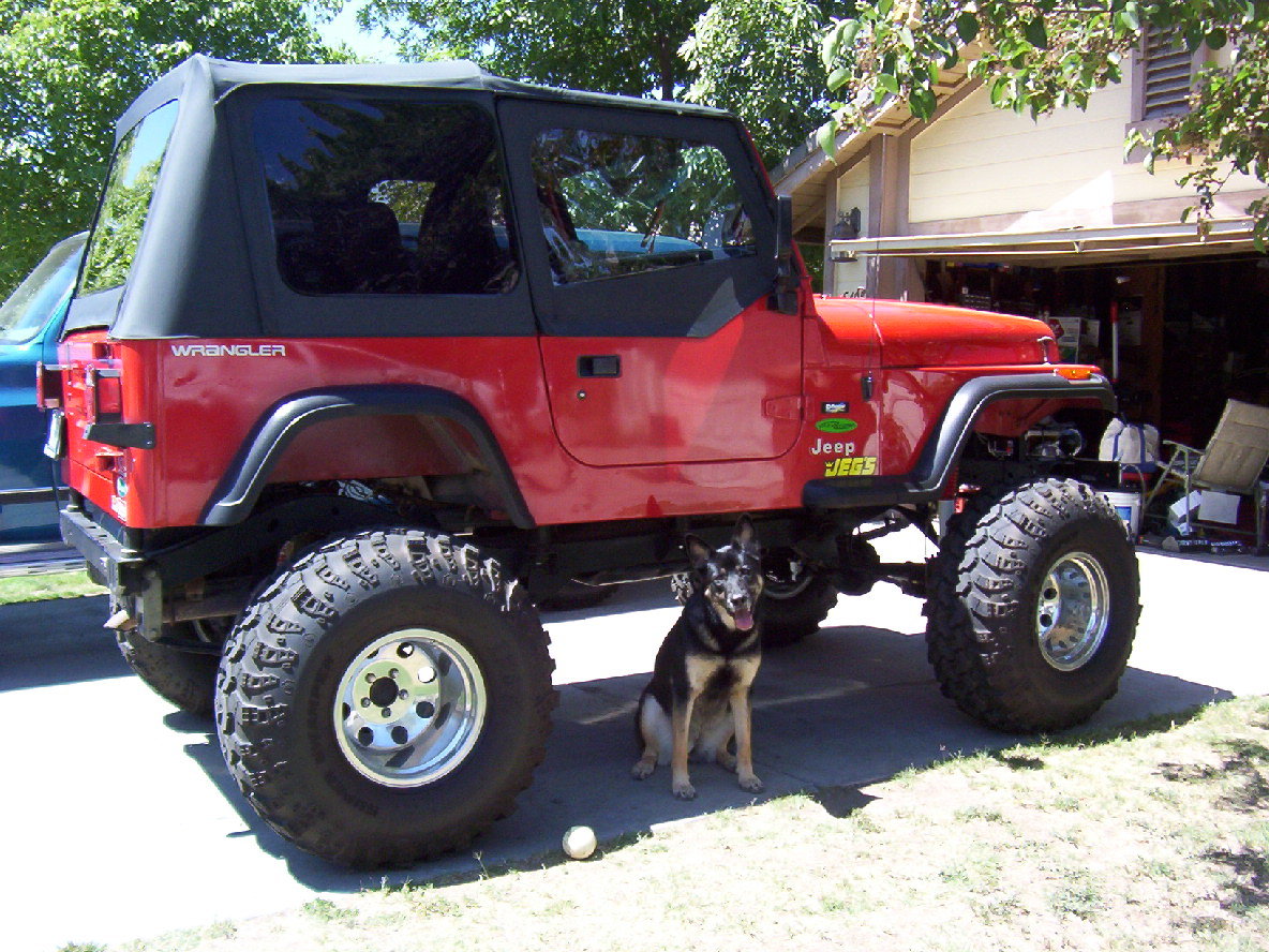

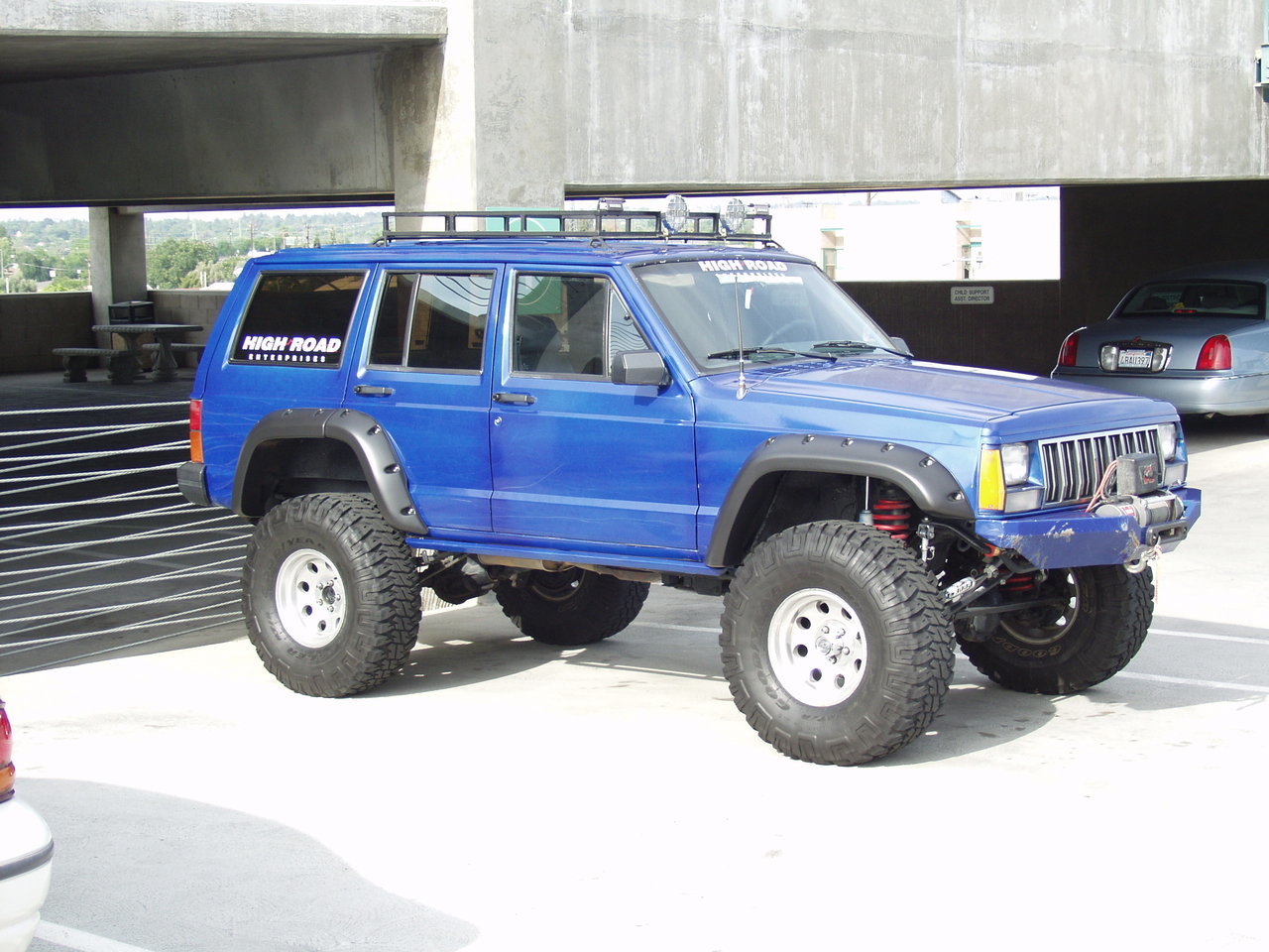

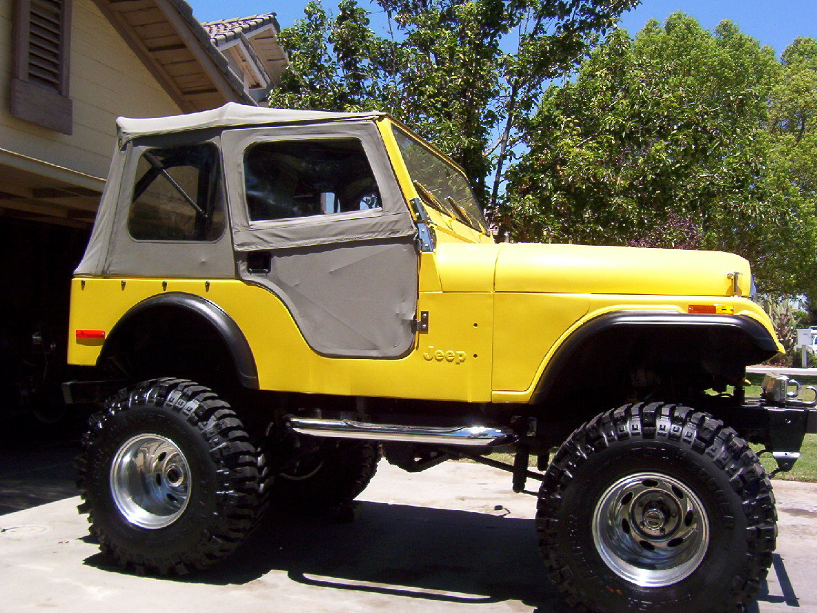

    ARB lockers are the cream of the crop. I run Detroit's in all of my toys. Never have they failed, and you do have to drive easy on the streets with them. Here are just a few of my toys with the Detroit locker.
