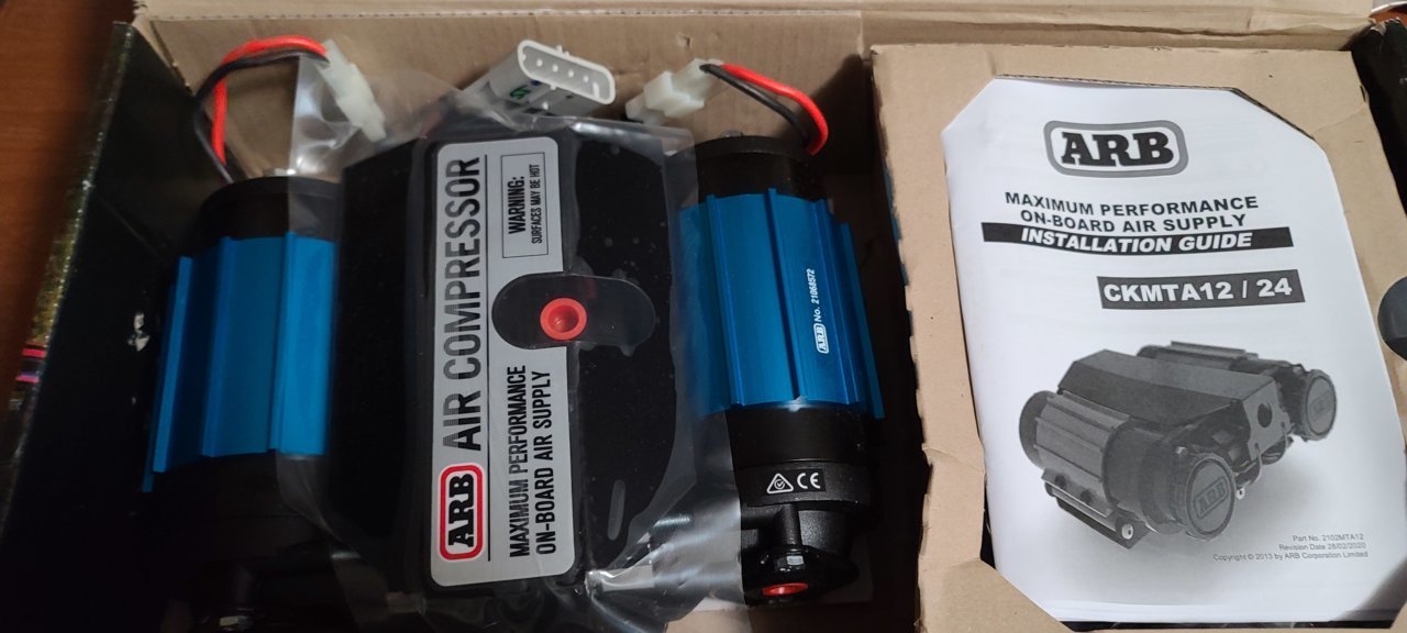

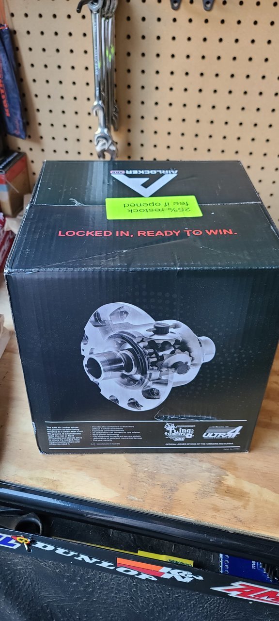

    Is this all I need to install my arb lockers on my truck or I'm missing something. Just want to have all the parts I need before I bring it to a shop

    I think it comes down to having a place to mount the valves if you are using solenoids. The air tank isn't necessary for the operation of the air lockers, but I guess his recommendation was to have it to mount the valves to.

    You definitely need the air locker solenoid. That's what it's for. The other thing is an air tank but that's totally seperate and only necessary when you're running your compressor constantly. Aardvark 13 is mistaken the two things... Coldfuzion is right.

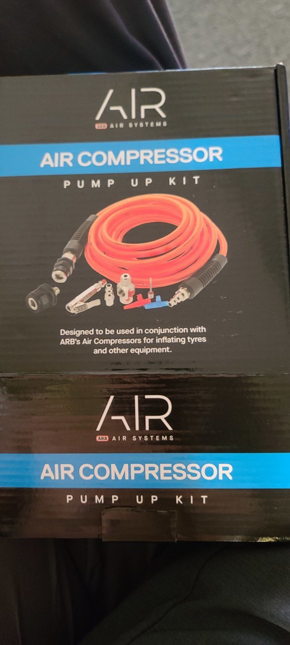

    Sounds good. What about airing my tires with the same compressor. Do I need other parts for it??

    Nope you add your quick chuck to the manifold and can hook your air hose there to fill your tires.

    Nope! You're good. You'll be able to do both.

    All I said is the air locker does not need an air tank(manifold). Yes solenoids are necessary, or you can use pneumatic switches. Air tank is not necessary except its a handy place to mount the solenoids if you buy arb solenoids..

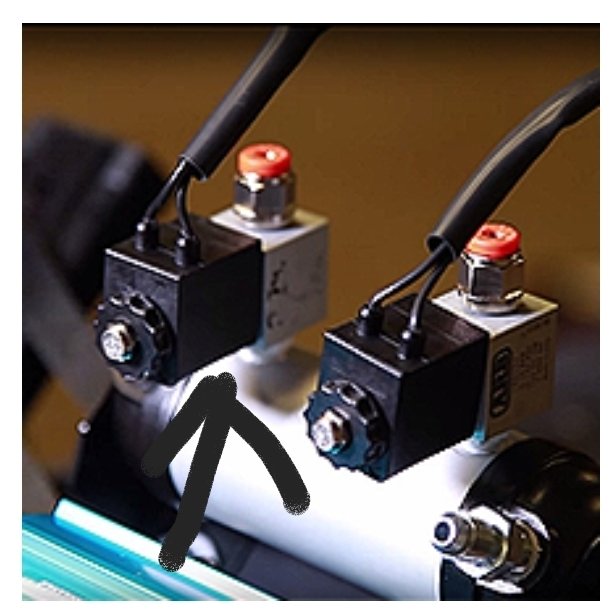

    What about that part???

    The solenoid should of been in the box for the air locker.

    Thank you I'll go check
