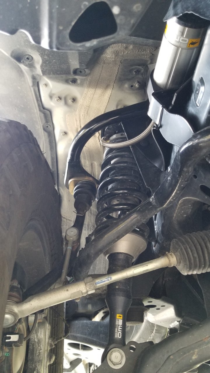

    Can someone tell me if I'm seeing this correctly, the thing I assumed to be a stone shield is on the back side of the shock. Shouldn't that be on the forward side? Seems like it isn't going to do much except pack in with mud.

    Yeah it should be facing forward.
