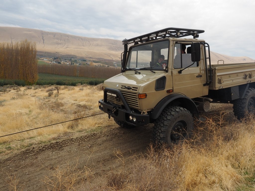

    With our Unimog sold we set our sights on new adventures.
    After two big projects I'm ready to do less building and more using. My mind set is changing for now, I want to do as much camping and traveling as possible while my son is at the right age. This build will be more about bolting stuff on than fabricating.

    Awesome start to your build but do you have a pic of your old Unimog? :)

    Sure...also a link to the build report in my signature line :)
