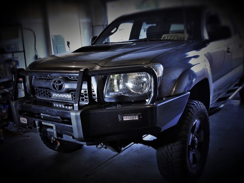

    I've had the ARB Standard bumper (w/o Fogs) for almost 2 years. I love the bumper, but I've always wanted to install some addtl. auxiliary lighting for it.
    The turn signal lamps on the ARB seemed to be expendable, and would provide a good mounting area for some LEDs, so I started hunting for a light that would fit. With the angle of the ARB's "wings" this would throw a wider beam out to the sides and provide better "ditch lighting" and provide a more-complete spread pattern when combined with the headlights and/or the 10" LED Bar I have mounted in the grille.
    This is the area I wanted to install them:

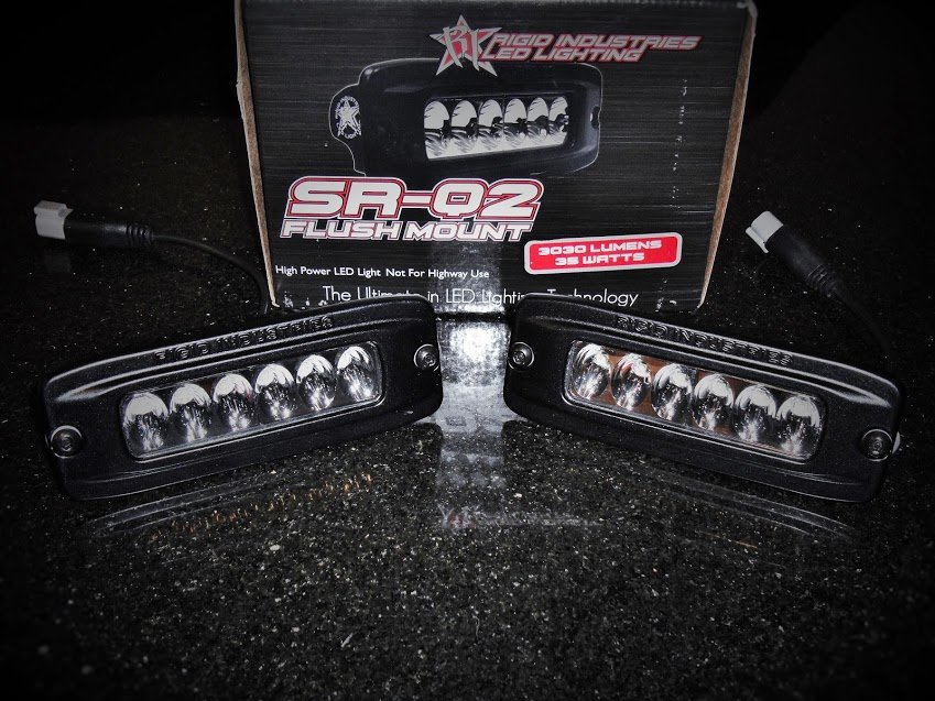

    After researching a few options and cheap "import LEDs", I finally found the ones that would work (with some minor modifications, of course ;))

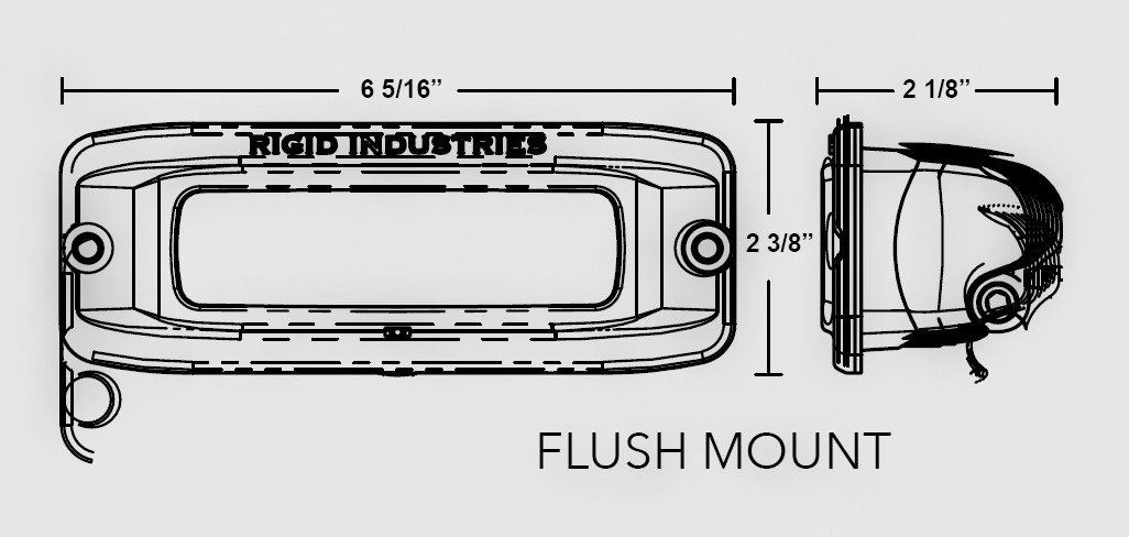

    Rigid SR-Q2 Flush Mount (Driving Beam Pattern) - Part # 93531
    HSsmRQp4gL3WTJaFxGNOQ4lHg0oI4kIXK6XJKsY7_6eb1fb8be1c68671ad8aee9eb7d2618e2987d6b6.jpg
    7FRu5-e3jf1hydjCJ-3bFPwSeGTYgu0RKcWC_T1d_ce104386d24c5743116db661430ef7415f7de771.jpg

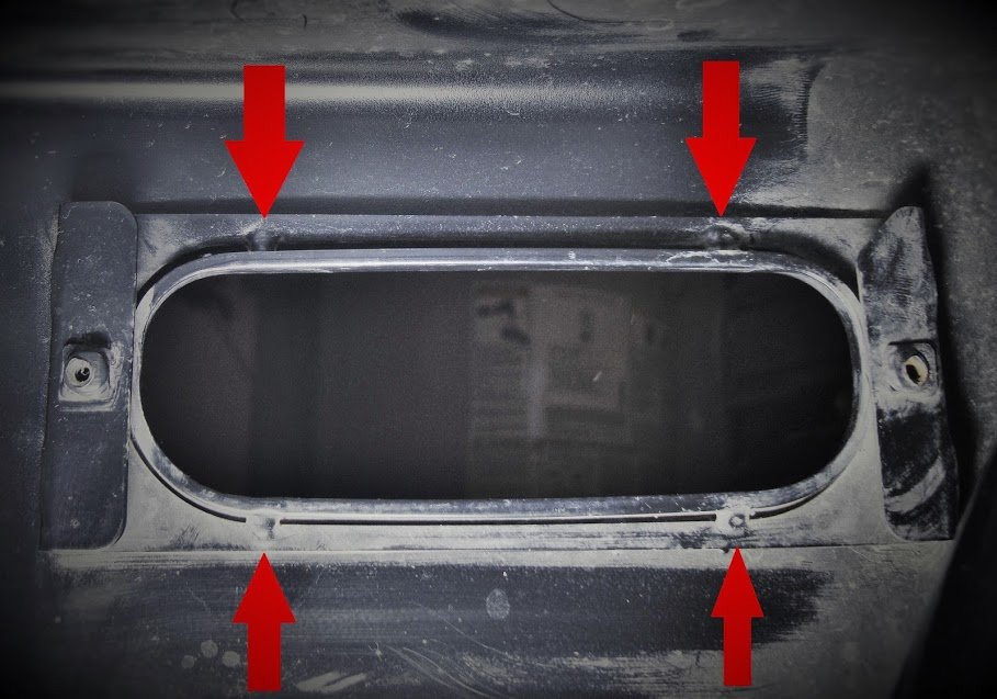

    1. Remove the light bracket for the stock ARB signals
    2. Cut/grind the opening to fit the Rigids
    3. Wire them up to the stock Fog Light harness and switch
    4. Mount them with Security Torx screws

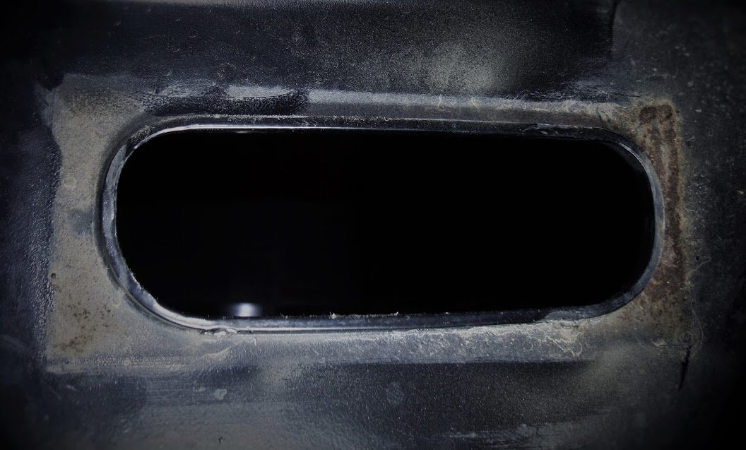

    • I started by removing the turn signal mounting bracket on the ARB Bumper
      XaY2f59oDLTQ75CboSWF8JMMczzzSfeTvLXM-WRG_f806d752e3d71cf6d38411e48a0d364b414aa126.jpg
      G8ju6IXbs_k7v8FEaA0BtmHd71CzwSvzgRGrag9z_f1f331a2aa9aad93491fc1294b573bbc7c514d82.jpg
      -Hj9XYXr8DS8vKTPiaUR50eFJ0ZGJ8o_wTwVtwXy_712b5b227e9df1dcda94708dd7904dea4e56d802.jpg

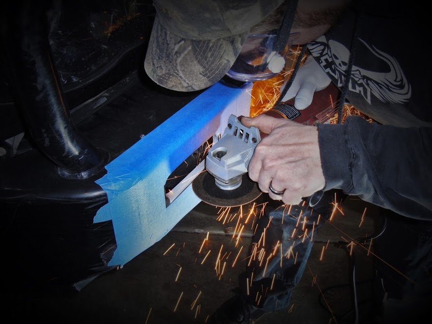

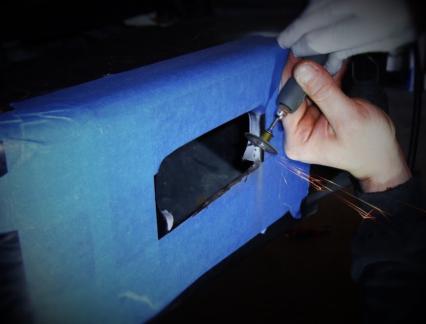

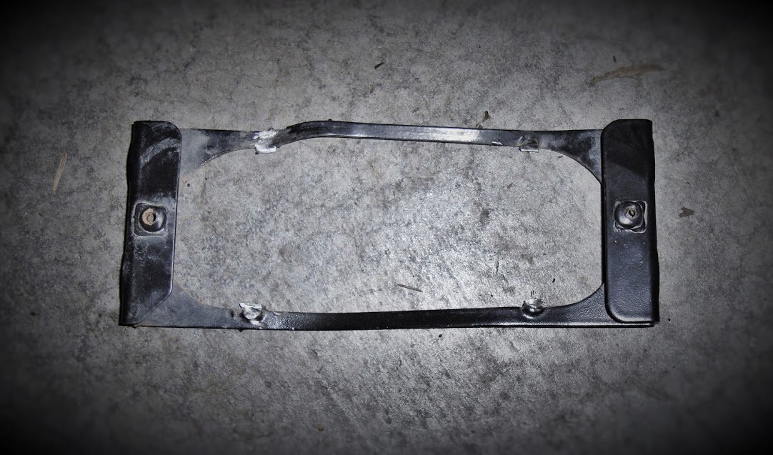

    • Next, I had to grind the opening to fit the Rigids. I also had to "create" a small tab to drill a mounting hole into. I was able to notch the edge of the opening and bend it into a tab that could be drilled.
      11lovQsqnvkYHnlj1LGB35d8UAfFZDBHbHYCurEQ_035a1ace9c6d8c1a1ec97e534a592dcd166629a5.jpg
      -N_eha348vXumld23NASloO0WRIYQm4N7q1ufcwW_11a6b07e92c4f16647e7cb5993c70089539e4d1f.jpg

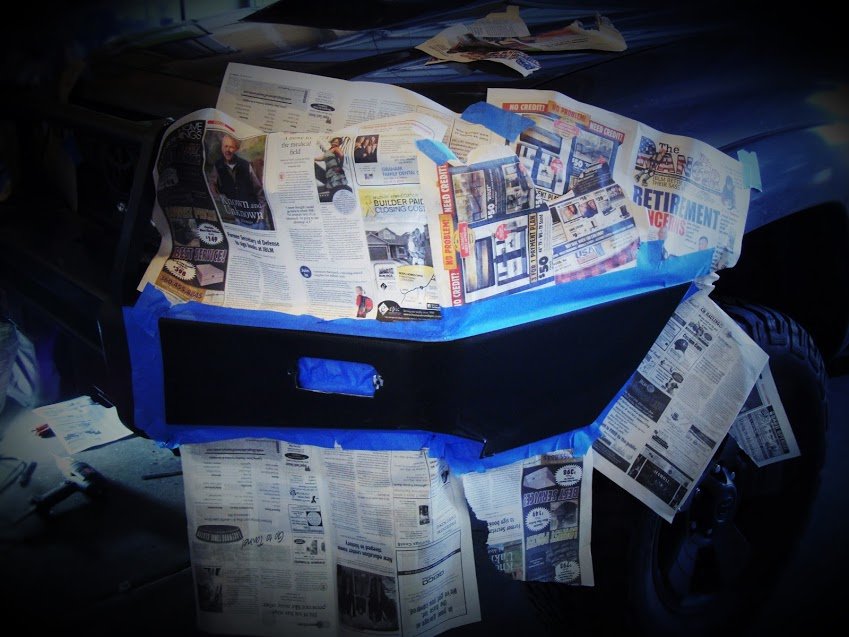

    • After I ground enough to get the Rigids to fit, I taped-off the wings and rattle-canned with some Rusto Satin Black (this is almost a perfect match to the ARB's finish)

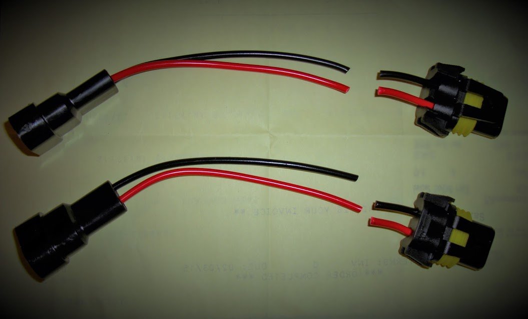

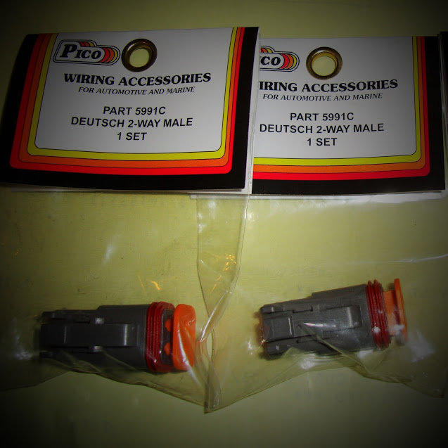

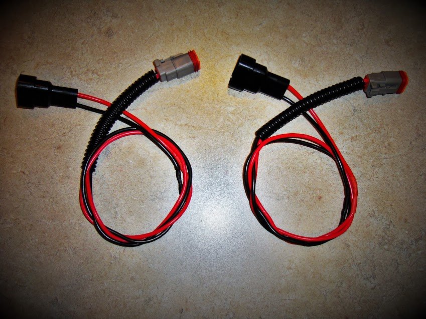

    • Next, I had to figure out the wiring.
      I wanted to use the stock Fog Light plugs and switch to make things simple. You can buy a "harness kit" from Starkey for about $30, or you can make your own harness for under $10. Just get (2) Male 2-Pin Deutsch connectors, and an H10 extension harness. Clip the Male end off the H10 extension, and connect your Deutsch connectors. I ran an extended length of wire to ensure the connections could be tucked-up and out of the way.
      wqh25M8Df6Z3hSS5Q2JDGSYhrLbJxzpHkvHK64G3_6046ce124e722959dfd81e8fe211080b8a87e806.jpg
      S9Wl-mlVNhTgyU4ypAmd9gnPbDwqCKEH6Qe1rLFE_fb745148bbf617dfa971b3ebf5536bd77273d030.jpg
      UWPcmvpmGLd--ffQXXQu_WqmkVEgQh6KsvHJOS84_a172be174454f929c391bf1a1cf08d0eb3d170f7.jpg

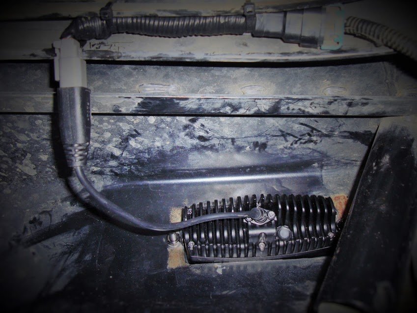

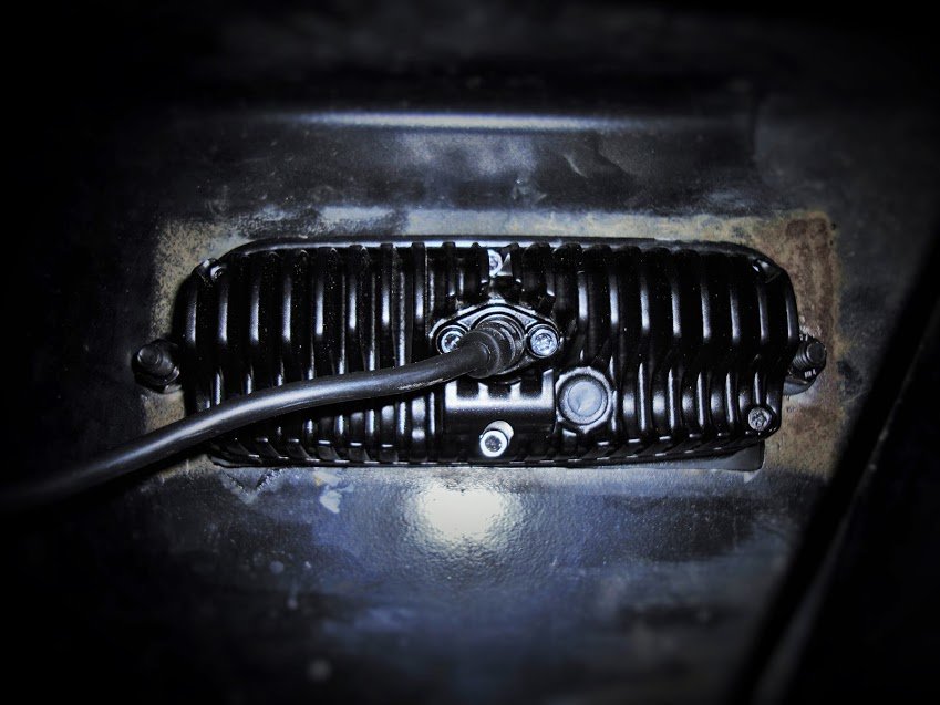

    • All that was left was to mount them.
      I used some Security Torx bolts and Nyloc nuts to attach them. You can see the plug/harness tucked-up and zip-tied out of the way. This makes the lights easy to remove, if needed.
      l8NSDI2CLAyVhsd7muje_qk3Pb4uHvMCcVURqo_l_b3c397af3f3c71987ca315705dd37d31e5fbe737.jpg
      xm-IYrBUgBSymxFI7HuJpxSilyRIYo8-RXIB9GV__f64718314137987c520eb1ceb622c94643585e23.jpg

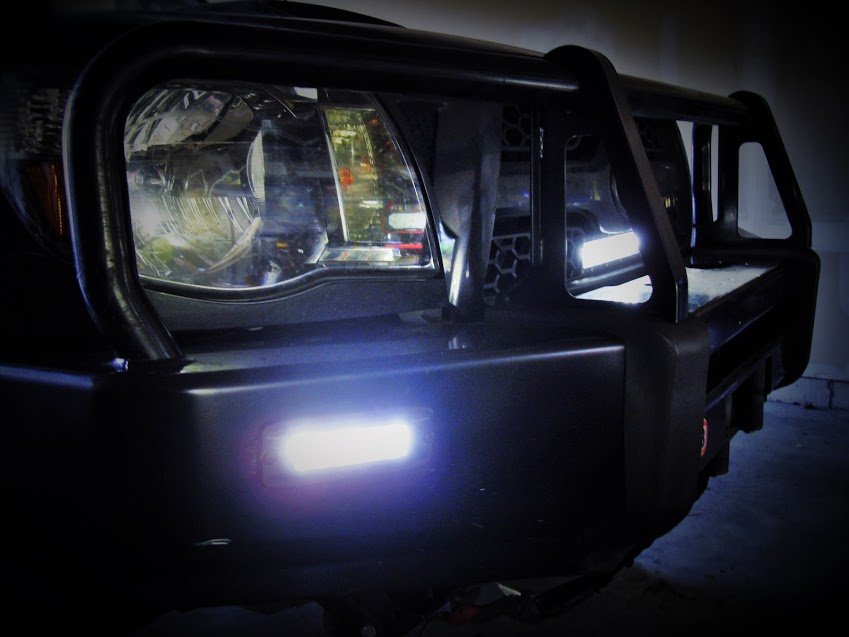

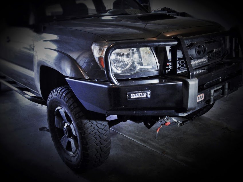

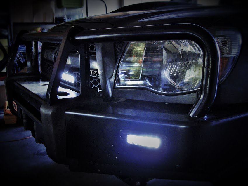

    • Finished Product
      hdniBBTe9NFN1CRuibIZlcRpVZR7cN46Odb8mqVv_bf266dcb99e07c466b8bd56bf74fa88ad83daaab.jpg
      Qb2lEm30DUi1aWgklQEB4C8j7k6TUztdwdhS3MSN_c0dd0bcf97f079a288d11548ae6097783c1af928.jpg SKbqf_fqBm4XTiworSepTfwnp6CzWoA75lDFZHFL_bf4ff3c5f722eaedc289b3ca97066198281f3f6c.jpg
      -oBhq9GLzDG9bnz6pESuukPbUZsI2DAF4OOZU4kD_ca4ba5ce7626d3d9d3c79336caa23ea276459dde.jpg
    • Wrap-Up
      These little bastards are downright incredible :eek: - now I can see what all the hype is about, and justifiably so!!! They throw just as far as my high beams and the Driving Pattern is the perfect combination of depth/width/height to fill the whole field-of-view with brilliant white light. It is amazing how much light can come from such a small package :cool:

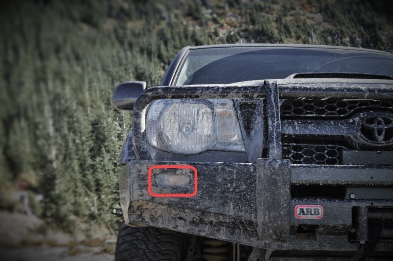

      After running them flush-mount for a few weeks, I decided to add the angled "wedges" to see the beam difference if they were to be angled in a few more degrees. I decided this pattern would be much better suited for my needs:
      • It was still off to the sides enough to assist with SAR Missions (sometimes your head is on a swivel looking for any movement/clues/disturbed brush etc. on either side of the road or trail, so being able to illuminate both sides is VERY helpful)
      • It provided a much brighter spot in the center. Even with the 10" Light Bar (not a Rigid), the SR-Q2s provide a much brighter spread.
    • All in all, I couldn't be happier with these lights! :thumbsup: The install went smoothly, and I now have VERY functional and bright auxiliary lighting that will last for years, instead of an extra set of useless turn signals and DRLs.
