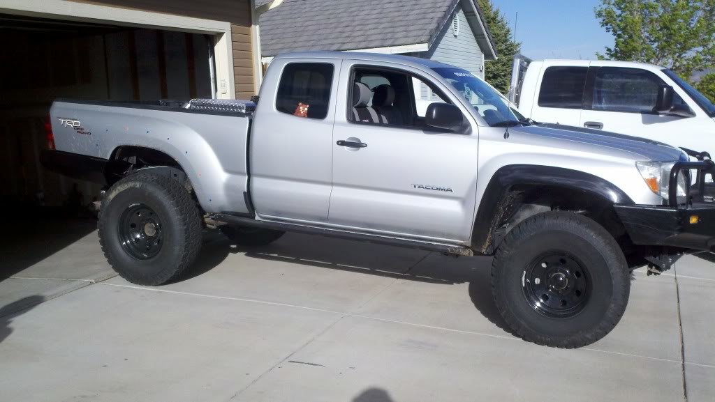

    This was a un finished product but you get the idea

    :popcorn: you can sell and buy a new one.....buy a new one.....cut the arb...or live with it. thats about all the choices there are. I would just get a cut off wheel and go to town and call it done.

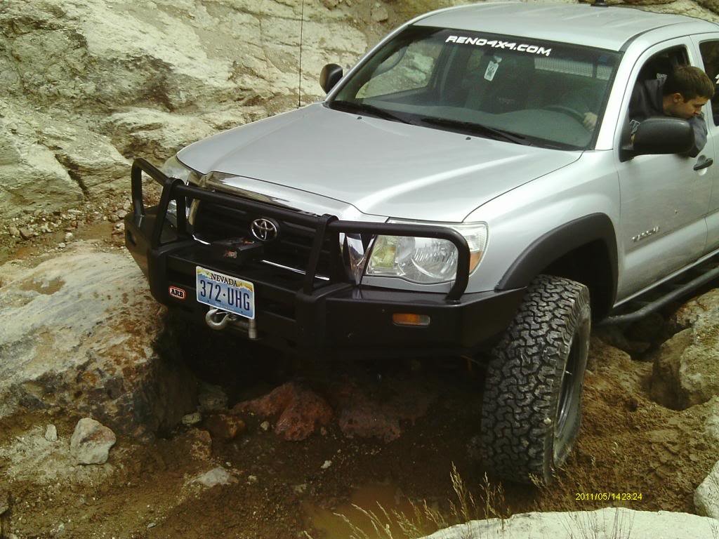

    With the 285s and stock flares I barely rubbed the ARB so I imagine if you just drew an arc from the top of the arb and made a circular cut you could make it look real nice. Or maybe just made more of an angle and took a straight cut from the top and back an inch or two from the bottom you would clear.
    It would take you less time to cut prep and paint your ARB than it would to buy/install a new bumper. :rolleyes:
    Fabbing up a front hitch might be a different story but even then you'd have to go custom and that could be a while.
