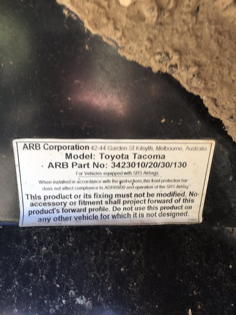

    I found a Arb Bumper for sale and the guy selling it says that the part number for it is
    3423010/20/30/130
    I looked on the forum here with no luck, and Arb doesn't show it when I go on Arb USA.
    Anyone know what year Tacoma this bumper is for?

    That 'part no.' doesn't make a lot of sense by itself - it covers four different ARB bumper part no's.
    IE 3423010, 3423020, 3423030 and 3423130.
    I assume you are considering the below auction.

    I saw it on kijiji, the guy sent me a picture of the serial number plate. I was wondering about that number as well.
    I'll try to post a pic of the serial number plate

    I'm thinking he sent you the serial no. found on the subframe of the ARB bumper, upon which 020/030/130 bumpers will mount to. 34243010 is, i think, the Tacoma second generation subframe fit-kit. The other three part no's are outer bumpers applicable to 2005-2012 Tacomas. The difference between 030 and 130 bumpers is the latter has the turn signal/spotlight positions in an plastic insert. 030 has the turn signal surface mounted on the bumper.
    Mine is a 130 version with aftermarket inserts.

    Thanks for the info! It sounds like this bumper is set up for 2012 or older 2nd gen

    That is a well worn 34243030 version with a lot of chattering through the front powdercoat. I'd be cautious about picking up a 2nd hand ARB due to the subframe having crush-cans.. if impacted, you need a new subframe for the bumper. The subframe is entirely absent in the advert photo.
