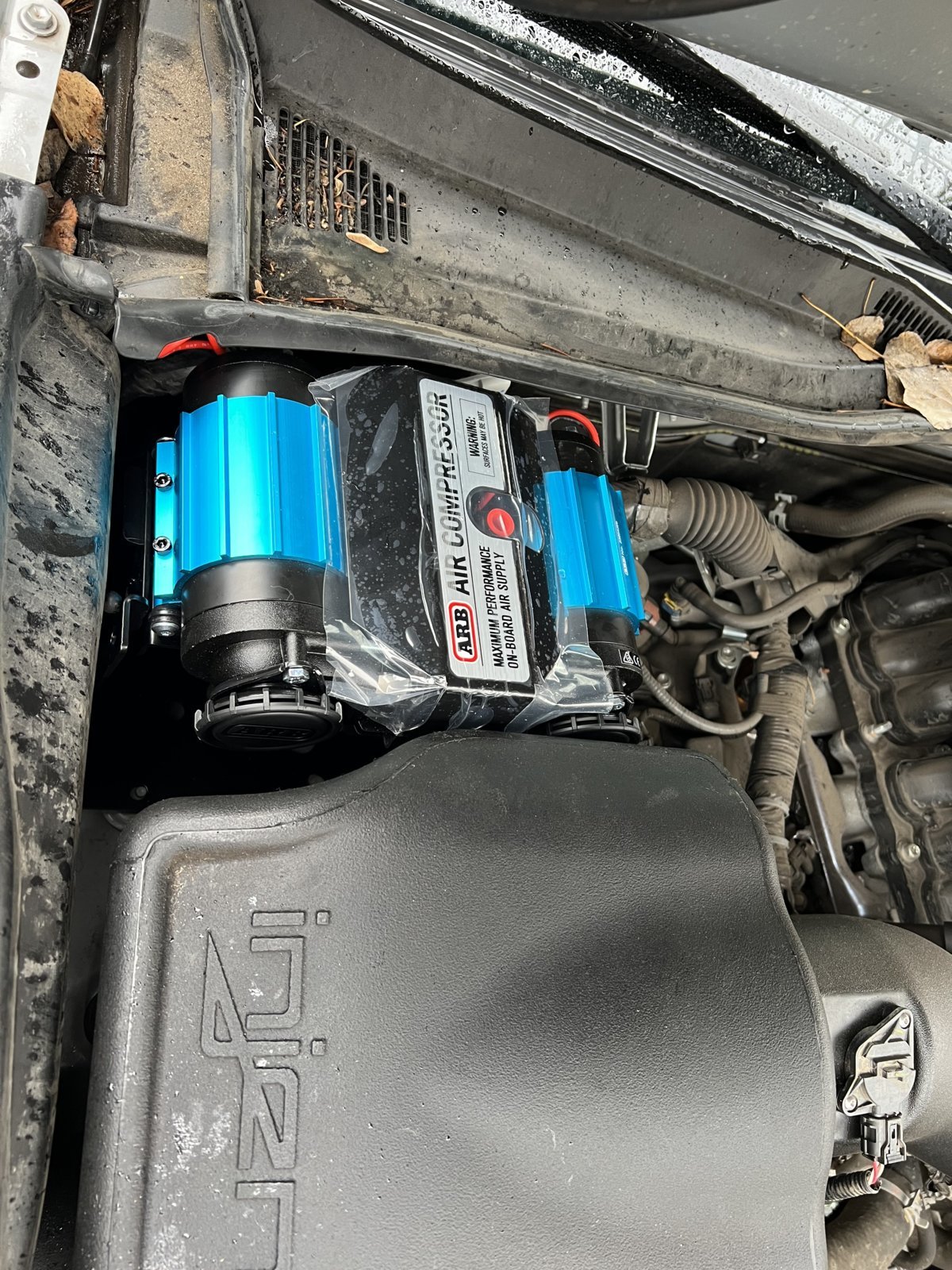

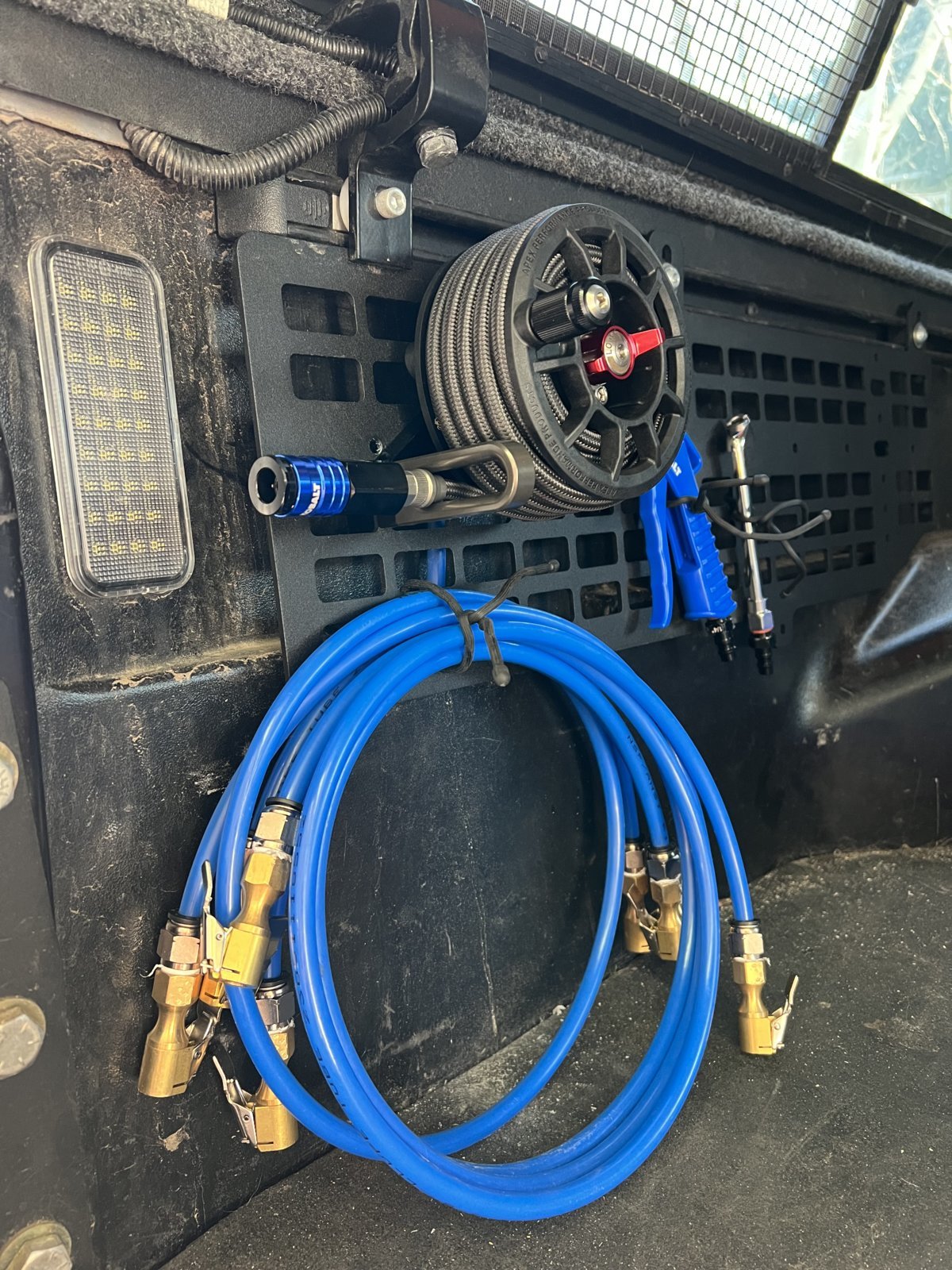

    Well, it’s all done! Wifey system and a little extra. Thanks for the help and suggestions!

    I'd look into Quickfists for that hose management/hanger... those twist ties are gonna get old fast.

    I have some quick fists for some larger items. Those twisty guys are great though! Don't hate! They are temporary until I figure out what I want to do.

    Is there room for a 1-gallon ARB tank to fit under the compressor with the Injen air intake?

    I cannot say for sure. It would be quite tight.

    For what it is worth, I swapped the spring for the 150lb spring, now it shuts off like its supposed to, rather than the constant blow offs. It has been working amazingly well. I was able to air down in about 4:30 and up in about 5:00. I have found the cord reel to be super helpful for airing up my wife's car, our RV and even an engine at work. Its rad to say the least.
