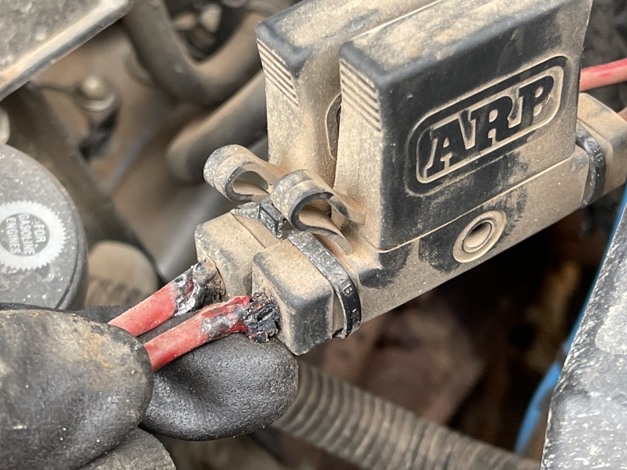

    Has anyone had issue with their ARB dual compressor wire melting? This is on the battery side of the wiring; there’s a ~6” long run of wiring from here to the battery.
    Compressor does still function, but I don’t like seeing this.

    Interesting that the wires would melt before the fuse blows. When did you originally buy?

    Assuming the wire is big enough I would suspect a poor crimp inside the housing. Just needs a bit of resistance or arcing to make a lot of heat under load.

    Engine bay also. It’s going to be already hot before you even run it and temperature derates wire conductivity. Airing back up requires sustained use which will push it further. If it’s a bad crimp it’s not surprising they’re in the same spot, repetition can be that way. I’d cut out both fuse holders and replace them(cut the other side right up against the holders). You can get them with the terminals still loose (uncrimped) so that butt splices aren’t needed and use some #10 GXL wire on the battery side.

    I hate in-line fuse holders. I have had and seen them melt in applications where the fuse is appropriately sized to the wire and wire sized for the amp draw because of shitty manufacturing.The entire fuse was melted in place on a led bar harness I just removed.
    I typically run terminals to a reputable fuse block or distro panel for everything major at this point.

    A friend of mine had his ARB Twin do this, and keep blowing fuses, too. He took it to ARB for it to get checked over and possibly rebuilt. It was a lost cause. The internals were corroded making it hard for the motor to power through, putting more strain on the system and such. If I had an extra ten minutes I could find the pics. His was probably a good 6-8 years old, and HEAVILY used.

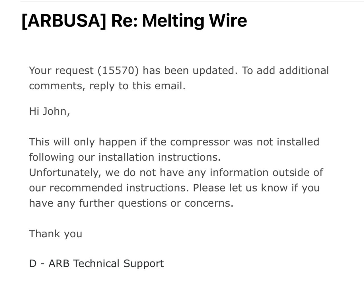

    I received a reply from ARB asking if I wired it per their diagram, I confirmed I did... waiting. :goingcrazy:

    Amazing customer service.

    Looks like more pictures are in order. “This will only happen if you fucked it up” is bs. It literally ignores even the possibility that there was a manufacturing defect. You might let them know the “ticket” is also open on TW and what's been said regarding possible causes.
