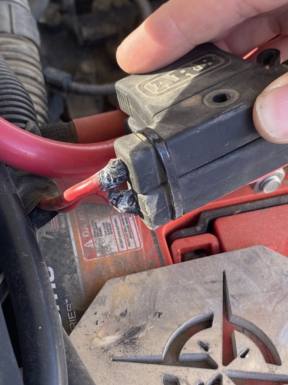

    Hmm, that looks odd, let’s investigate.
    Definitely working as intended, ARB.
    If you’re installing the ARB dual compressor from ARB USA on your Toyota Tacoma or Toyota 4Runner, hopefully your wiring doesn’t create a fire hazard like this.

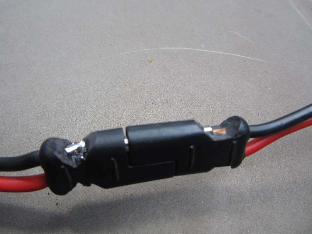

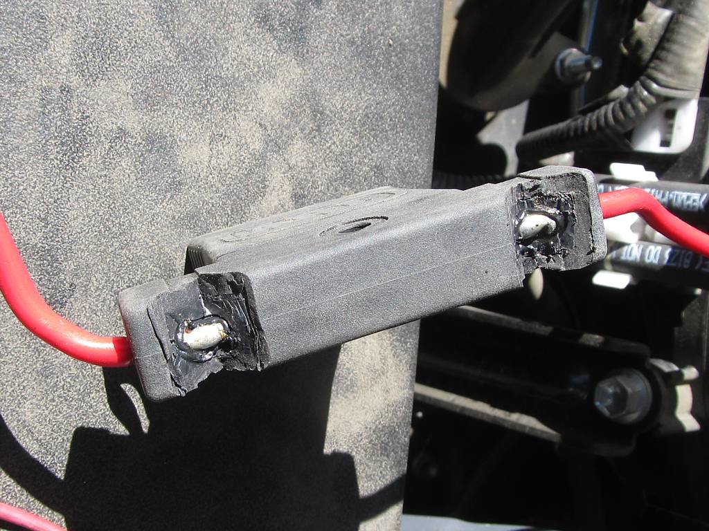

    One time I had a fuse holder (standard ATC blade type) on a set of auxiliary lights actually catch fire (a Bussman one too at that), smoke coming out from under the hood. Fortunately the flames were out by the time I pulled over and got out with an extinguisher, but there was still soot from it on the underside of the hood.
    Since then I've been cutting into these types of connections and soldering them. (sorry, no soot pic)
    As if it's somehow possible to wire a compressor in such manner to cause a fuse holder or it's wire to burn up (but not the fuse itself) if nothing is defective... What would be the purpose of a fuse then?

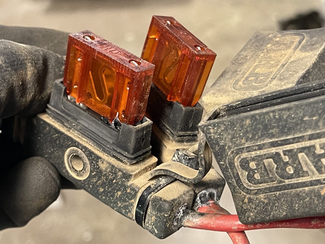

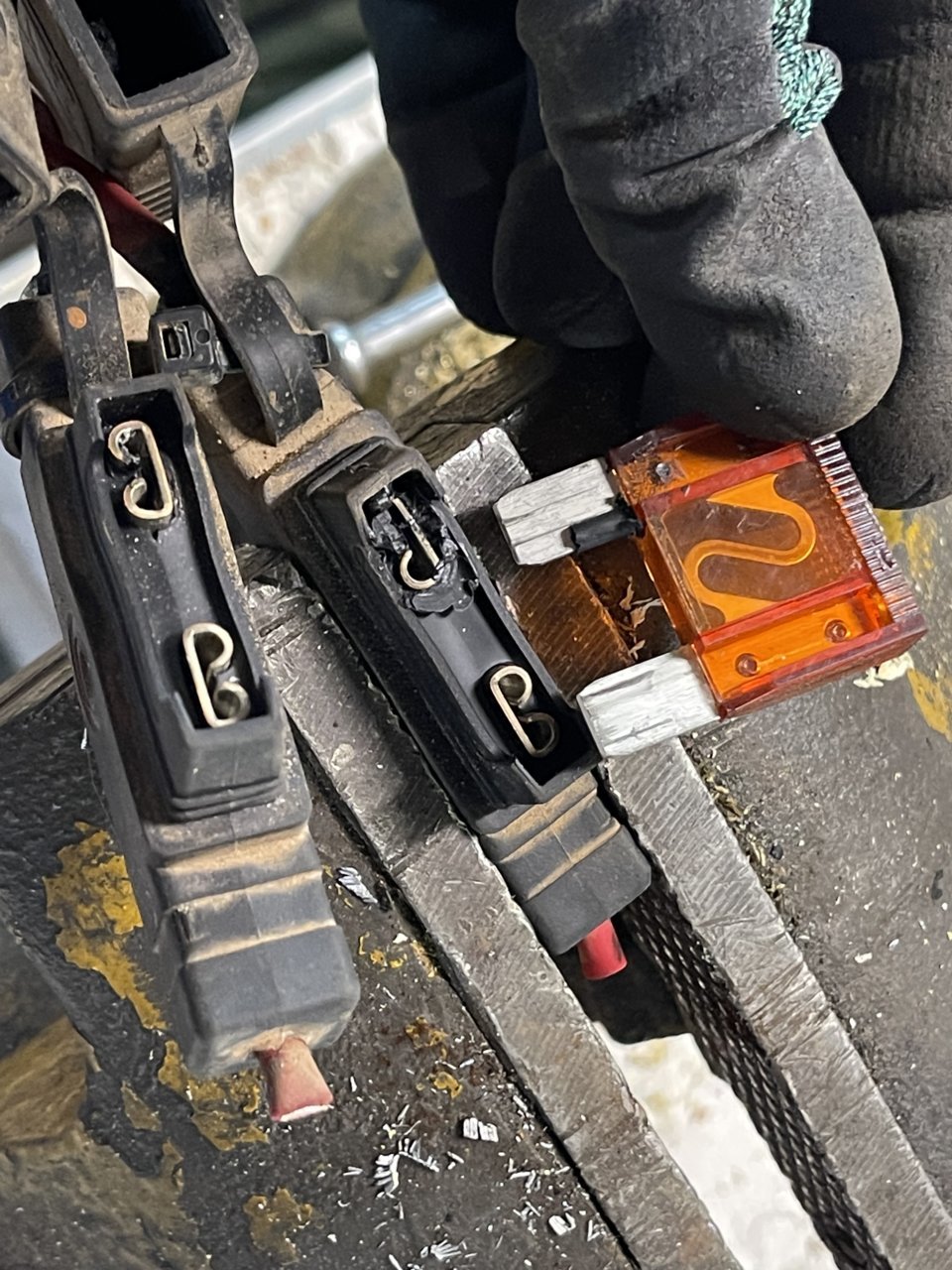

    Late to the party, but I had this happen recently.
    Naveronski[OP] and MGMDesertTaco like this.
  8. Jul 21, 2023 at 6:38 PM
    #48
    UnimogNA
    UnimogNA Member
    Dec 3, 2016
    #203931
    11
    2016 Tacoma TRD Off Road
    Icon Stage 7. Billet UCA. Dual battery set up. Leer cap with side windoors. TRD pro grill and skid plate. 235/85r16 dura-tracs

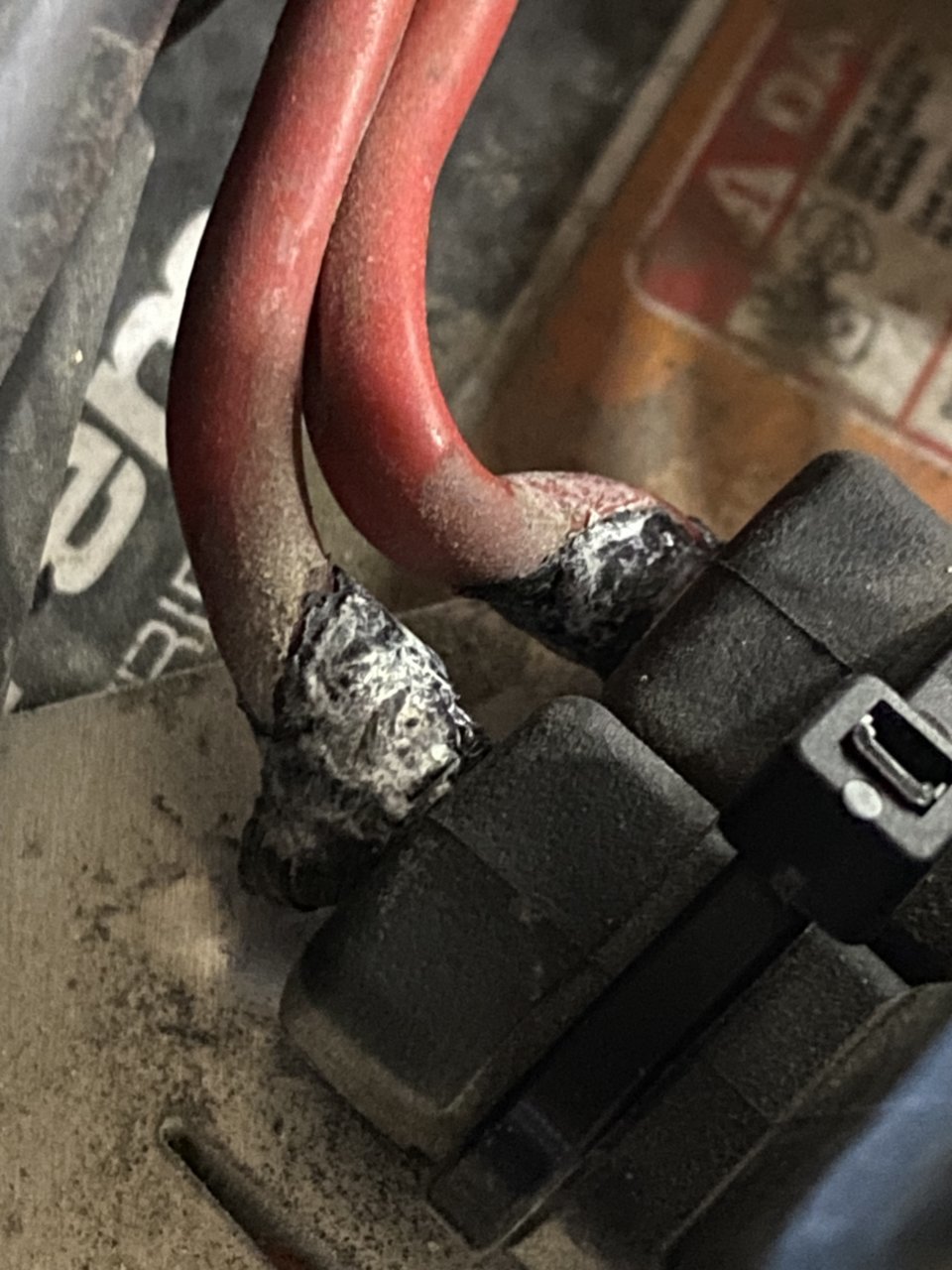

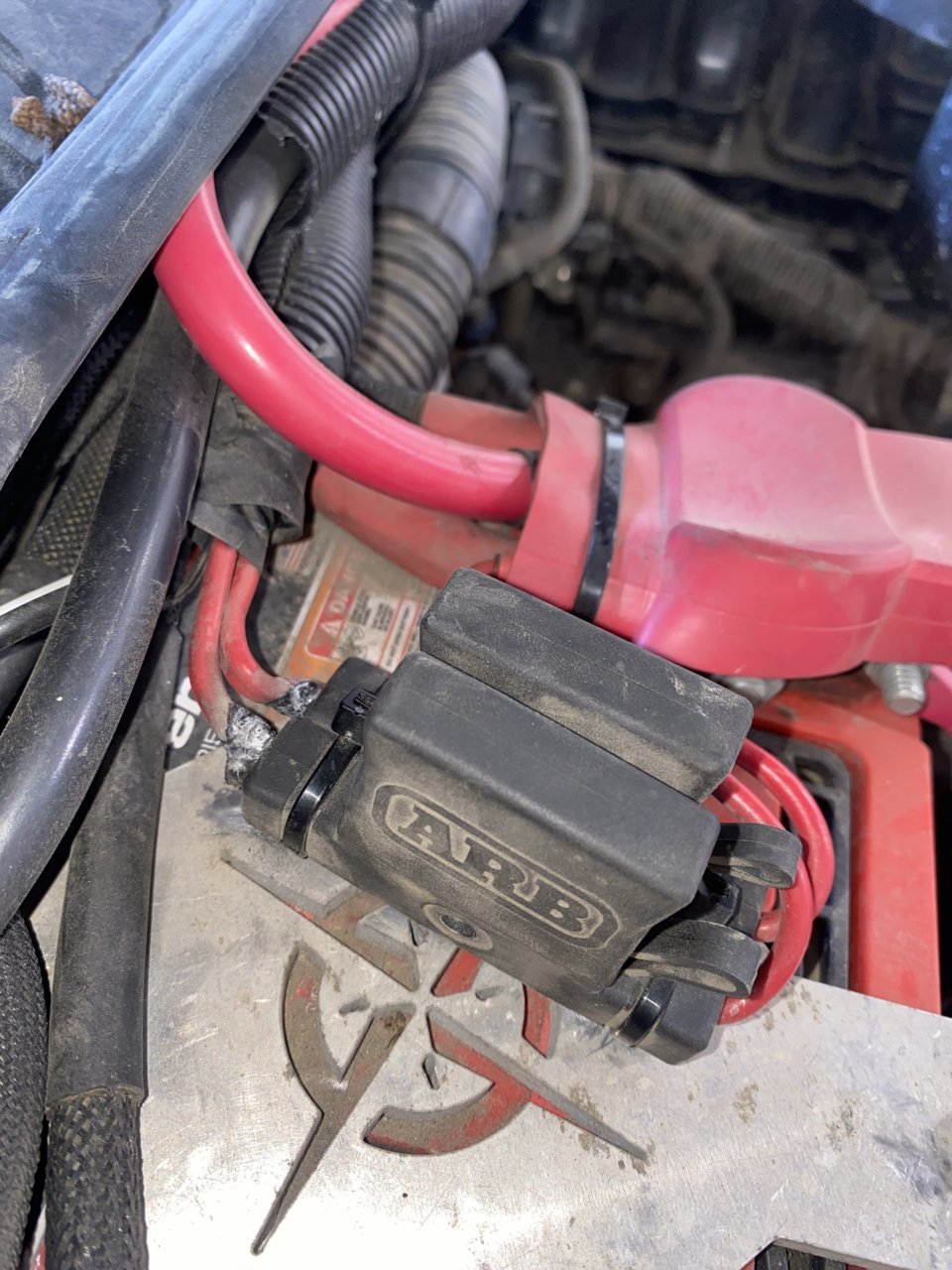

    My compressor partially cut out on the weekend. Found the same issue. Not sure if vibration over time caused a short but this sucks. Fuses did not blow. Compressor is 5 years old. Light use. IMG_9206.jpg

    It's not vibration or a short-circuit. It's poor design. IME, terminals crimped onto bare copper wire seem to be more problematic than ones onto tinned copper wire (the ARB wire is infact bare)... However I've had both fail. Oxidation forms within the crimp over time, this creates resistance in the connection... Resistance creates heat when current flows through it, the heat then melts/burns it until it fails. Best ways to avoid it are either do what I showed in post #44 (100% success rate so far), or replace with something else entirely (ANL or Mega fuses maybe... something that bolts or screws both the wire and fuse in place).
    Now would be the time to cut into the plastic and solder them (before they burn). Once burned, it's very hard to get the solder to stick well to the wire, which may still require you replace it first.

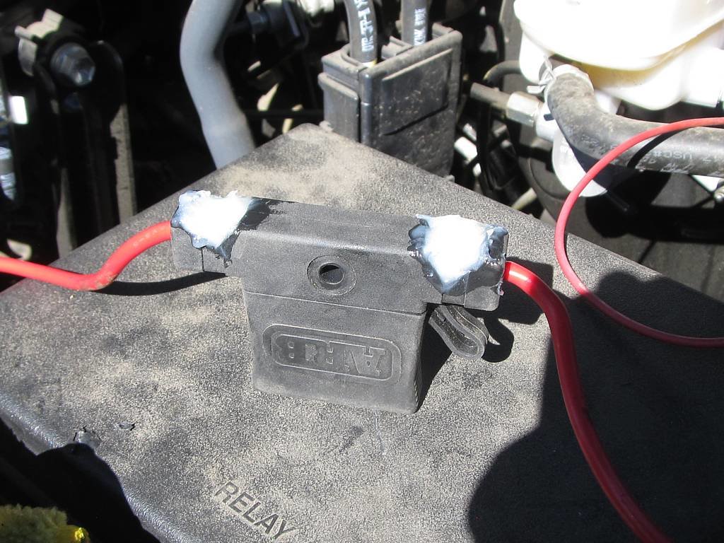

    What did you use to seal it afterwards? Silicone?

    Yeah, silicone or RTV (I would've used black RTV on my example to match it up better, but didn't have any on hand at the time).
