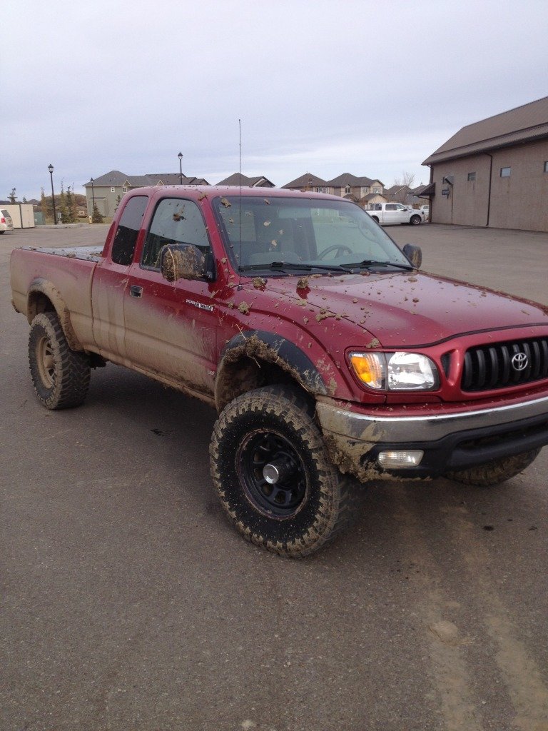

    In the interest of not jacking the other thread, I feel it is necessary to create my own as all my research has left me with questions.
    The set up I am currently running on my 2004 Xtra Cab Toyota is as follows: stock sized Monroe front struts with the 3" Revtec lift (/leveling kit, whatever you want to call it) and a stock front bumper.
    I am soon to be putting on an ARB front bumper and am wondering which front suspension set up I should choose:
    Currently, as the truck sits, the front end is sagging. This will certainly be made worse with the addition of the ARB bumper.
    I plan on getting Bilstein 5100's and was wondering what my best plan of attack is.
    My friend with 5100's and the same spring/leveling blocks (revtec lift and stock springs) set up's truck sits higher with his ARB bumper then my truck with the stock bumper, but his coils look very compressed.
    When I put the new bumper on, do I:
    1.) Retain same spring/lift kit and get new 5100's?
    2.) Get 5100's and install them with OME 882's? Can this (/is this to) be used with the Revtec lift kit?
    3.)Get 5100's and install them with OME 883's? Would this achieve a slightly higher lift (without the Revtec lift)?
    Thank you in advance for your time and I am sorry if this is an annoying question.

    Because I forgot to include pictures for you kind people:

    I am thinking Bilstein 5100's with OME 883's. I have a 10mm lift enhancer to install if need be, and install without the Revtec with the Struts set to "0". What are people's thoughts? Would this achieve what I am looking for? From what I read, it should, but I would like some feedback before I spend any money. Sorry if I seem impatient, when I get a plan I like to act quickly on it.

    If you want the most lift and the support for the bumper get some eibach coils. at least 3" of lift and no sagging with bumper or a winch. just get ready to fuck up your cv boots lol.
    it is suggested that 883s be used with OME shocks.
    don't use the spacer, the 883s and especially the eibachs will lift the truck as much as you should have. any more and its too much cv angle.
