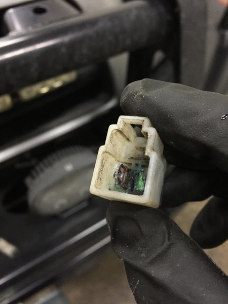

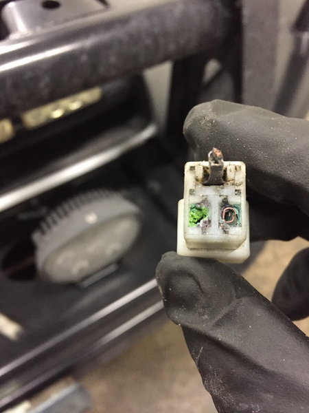

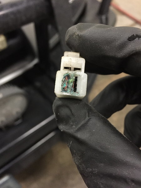

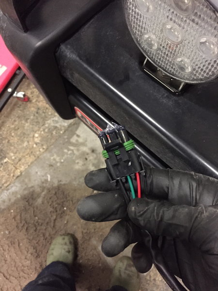

    UPDATE** I played with the lights today and found out the connections were super corroded. After switching the old white ARB connections to some weather proof ones. I fiddled with the "broken" light. Turns out both bulbs where burnt out and they can be replaced. push and twist type bulb. :facepalm:should have checked them first. oh well
