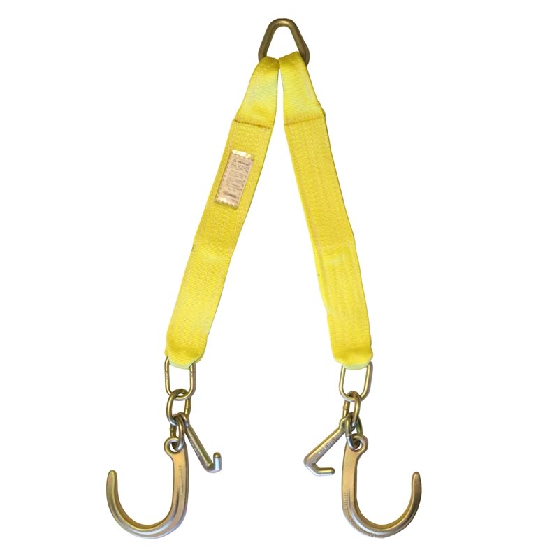

    I have this Curt front hitch and has served me well. I had a winch attached to it and have recovered many vehicles. I've also used this mini j hook bridal that you can use on the frame or lca

    I should already have a hook bridal as I snatch cars more than trucks and always struggle with recovery points.
