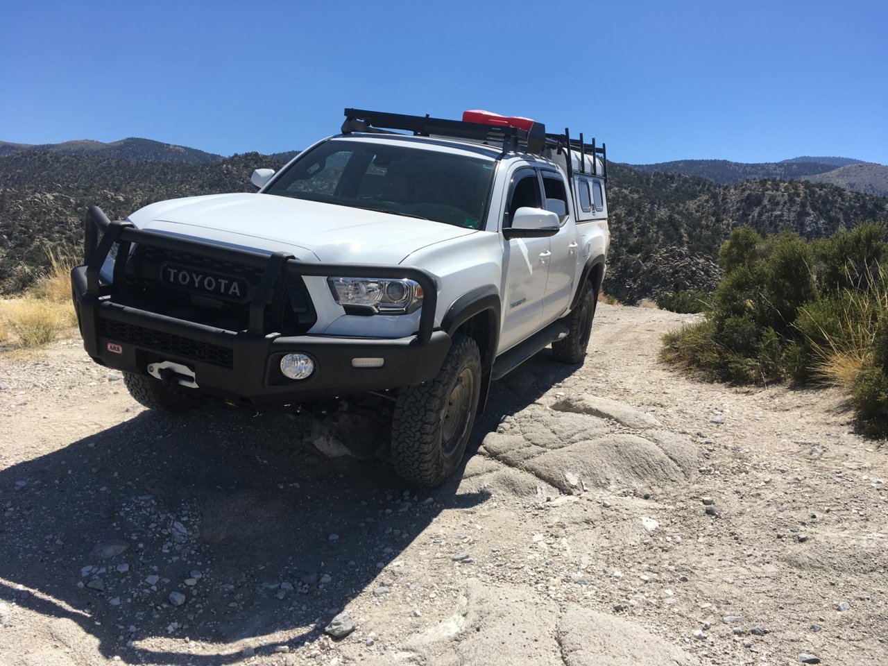

    Appreciate the information. Have any pics of your ARB bumper on your truck? Personally, I like the looks of the more "rock crawling" stealth bumpers. But functionally, a bull bar protecting the whole front is better for me. We have a ton of deer that run around here and I drive around cattle a lot. The extra protection is more important to me then the looks of it. And ARB is a solid company.
  7. Oct 30, 2019 at 2:59 PM
    Azza
    Azza ㅤㅤㅤㅤㅤㅤㅤㅤㅤ
    Nov 25, 2018
    #273828
    522
    Yeah, I have a few.
  8. Oct 30, 2019 at 5:20 PM
    rascott95
    rascott95 Well-Known Member
    Mar 21, 2015
    #151447
    202
    Dallas, TX
    2019 DCSB TRD Off Road
    That is one hell of a bumper. I don't think I would want to be on the receiving end of that thing in a wreck.

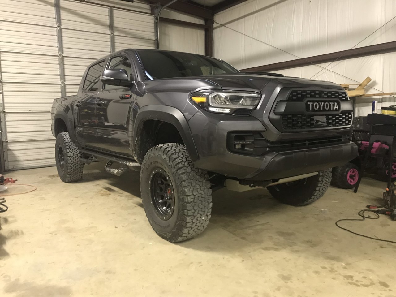

    I went with the @victory4x4 strike bumper instead. Doesn't interfere with anything and is half the weight. Not as beefy as the ARB, but we'll see how it goes.

    lol. I have a factory 2020 pro. I went with the no hoop model. But I called victory and asked about the hoop and they confirmed that it wouldn’t interfere with TSS. I’m still waiting on the victory bumper to get here. Just ordered it last week. But I’ll always post a pic of my truck. This was right after I got it lifted.

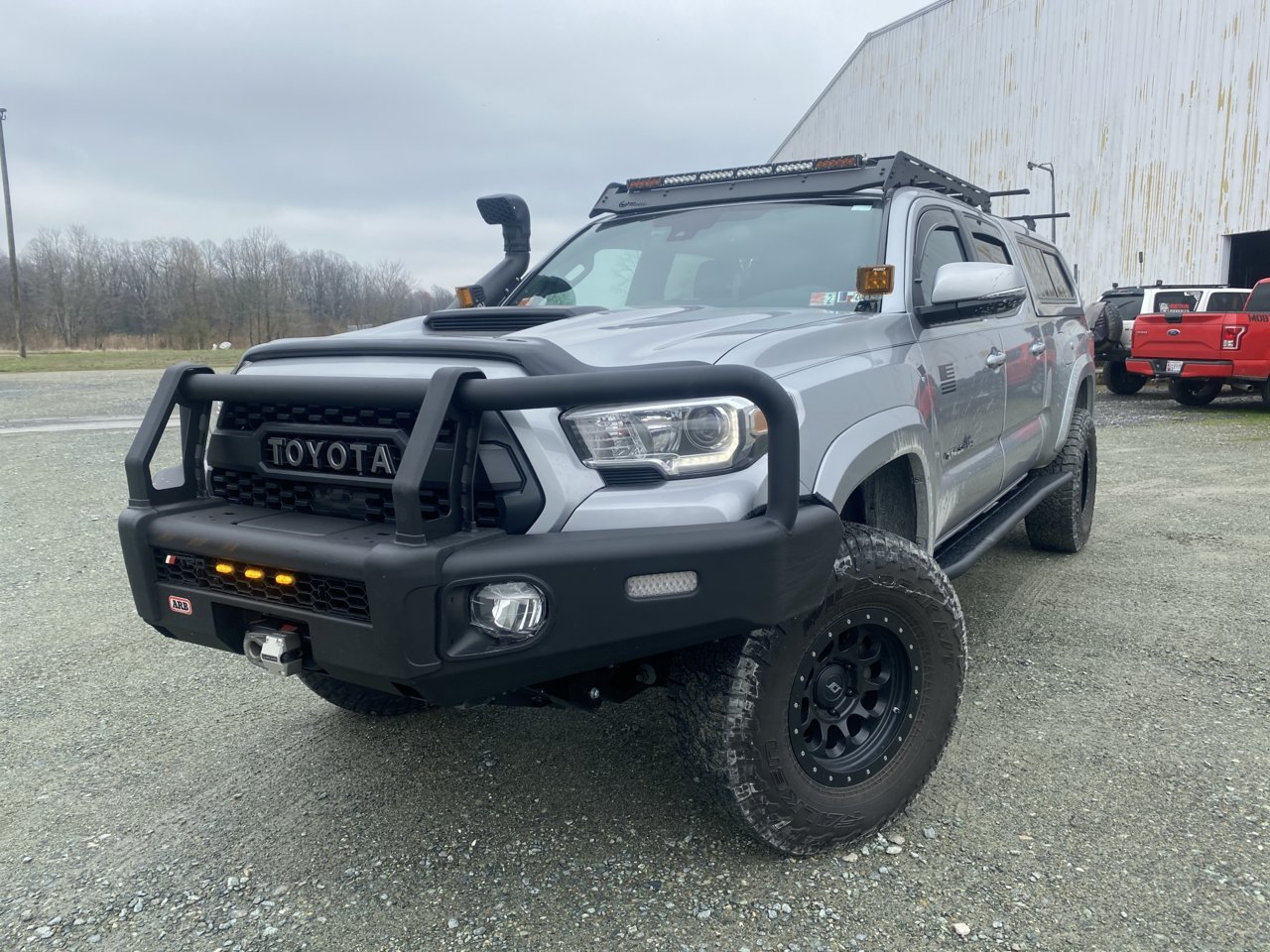

    My TSS has no issues with the PRO Grille on

    What winch do you have?
