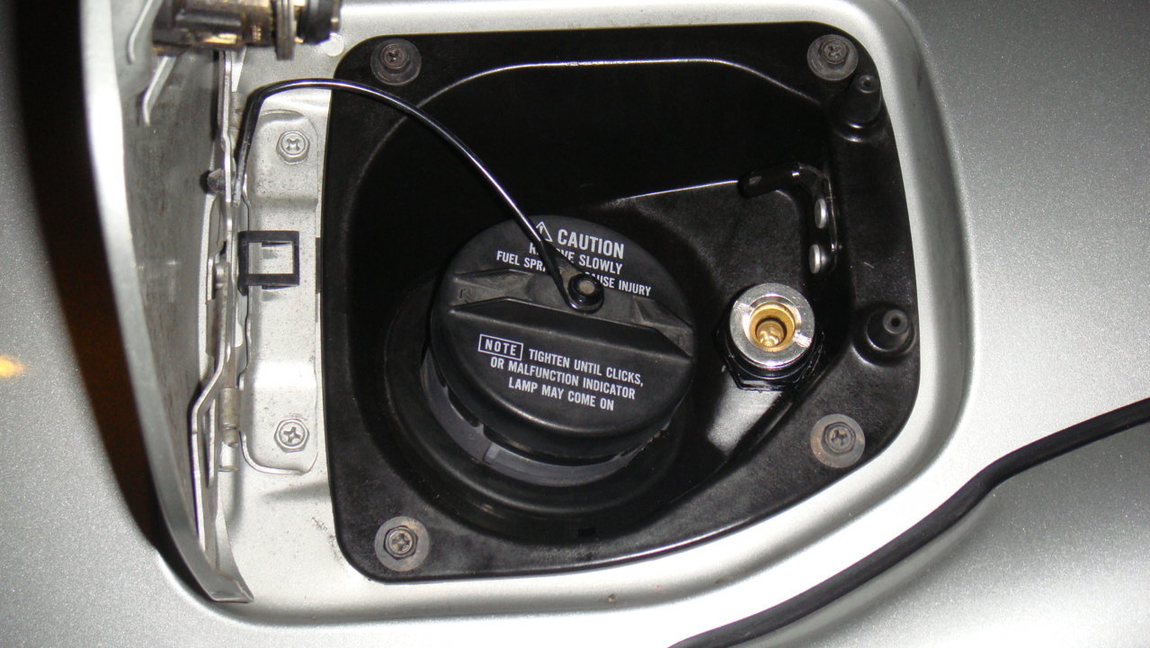

    I suggest installing it within the original ARB harness length. You can shorten the harness BUT not lengthen it. I did this and melted a section due to the amount of amps they pull, 56 IIRC.
    Keeping it under the hood keeps it clean too.
