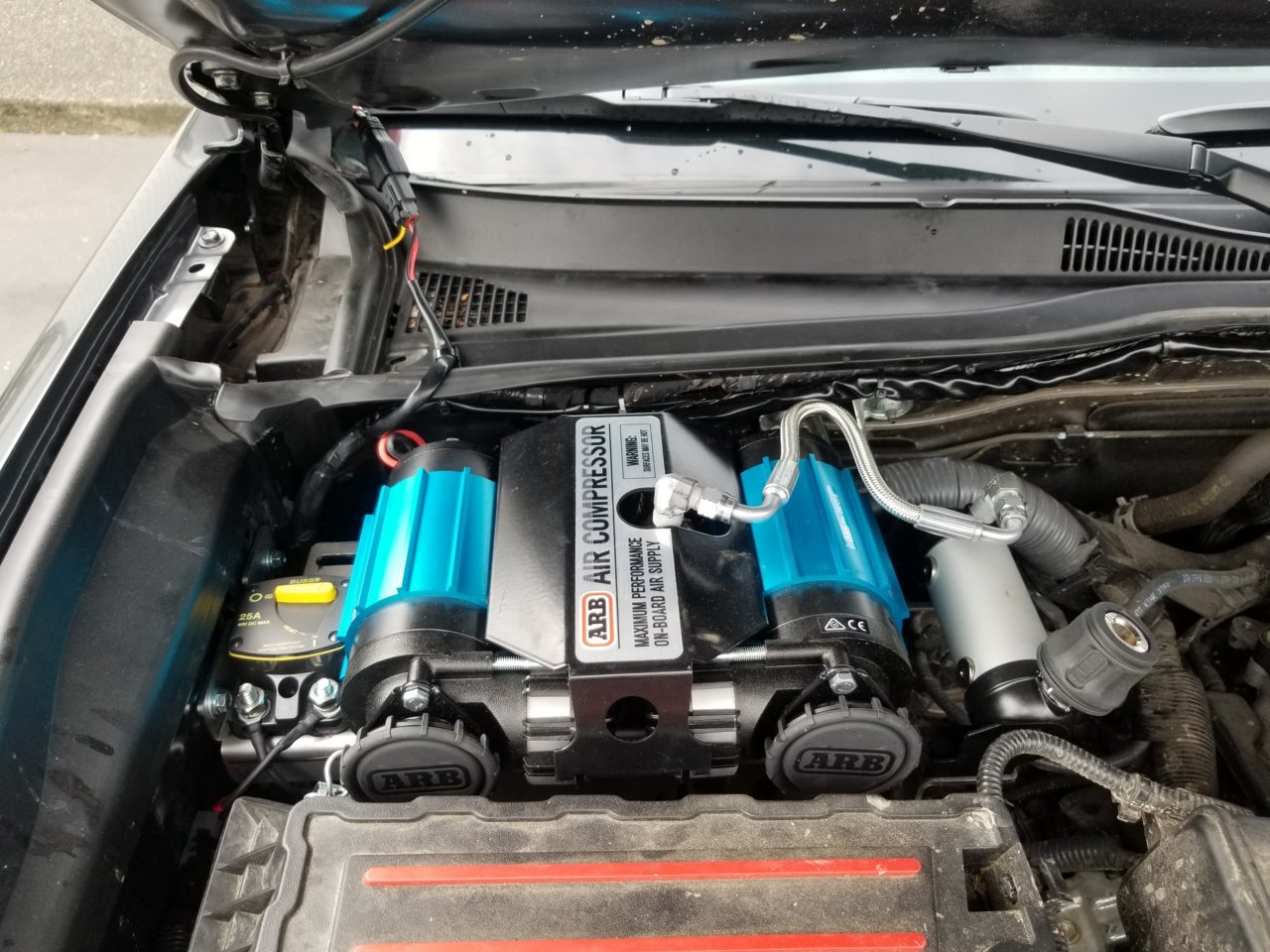

    Followed your install almost exactly. Only difference is I got the manifold, just to provide a mounting location for the air chuck.
    Thanks for the pioneering and answering my questions.

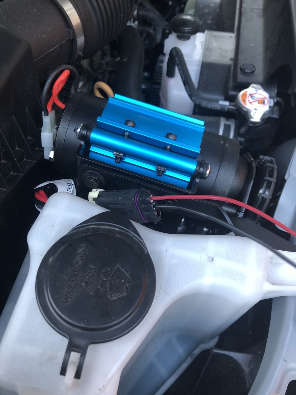

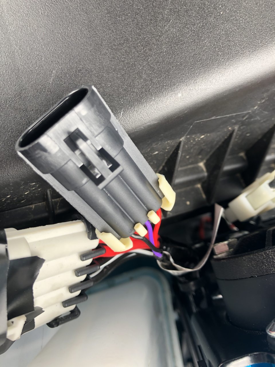

    I did mine without running an extra line to the battery. If you look inside the connector coming out of the compressor there are actually 3 wires: Red, Purple, and Black. The factory harness doesn’t connect to the red wire (I think it’s used for the CKMTP12 Portable Air Compressor).
    I got some extra pins and repined/rewired the plug with one wire to the red and one wire to the purple (I used black wire since I didn’t have purple wire). Then ran them to a switch with a 5 amp in-line fuse. I'm not sure if the fuse was necessary, but I had it and I figured it couldn't hurt. Also, I was originaly gonna run the ground to the frame, but I called ARB and they said the black ground wire isn't needed.
    Everything seems to work fine. Has anyone else tried wiring it like this?

    Can you show some photos of your wiring to the switch you used?
    Also, what size pins did you use (and where did you get them)? I like the idea of doing this as it keeps it clean and simple.

    Sorry I’m out of town on vacation so I can’t get pictures right now.
    For the switch I just crimped some female spade connectors to the wires and plugged them into this a basic switch: https://absolute-wits-end.com/waterproof-accessory-switch-20a/
    For the pins and connector for the wiring harness search “GM Delphi Merti-pack 150”. Make sure you get all the little rubber plugs to seal things including the empty space in the purple plug. I got mine here:
    https://www.bmotorsports.com/shop/a...ch_in_description=1&keywords=Delphi+150+56059
    I know I ordered a few extra parts since I wasn’t exactly sure what I would need and I can’t remember which ones I ended up using, so you will need to do a little research. However the part numbers from my invoice are ($15 total):
    CONN-56059
    CONN-51861
    CONN-56057
    CONN-75608
    CONN-56256
    CONN-75664
