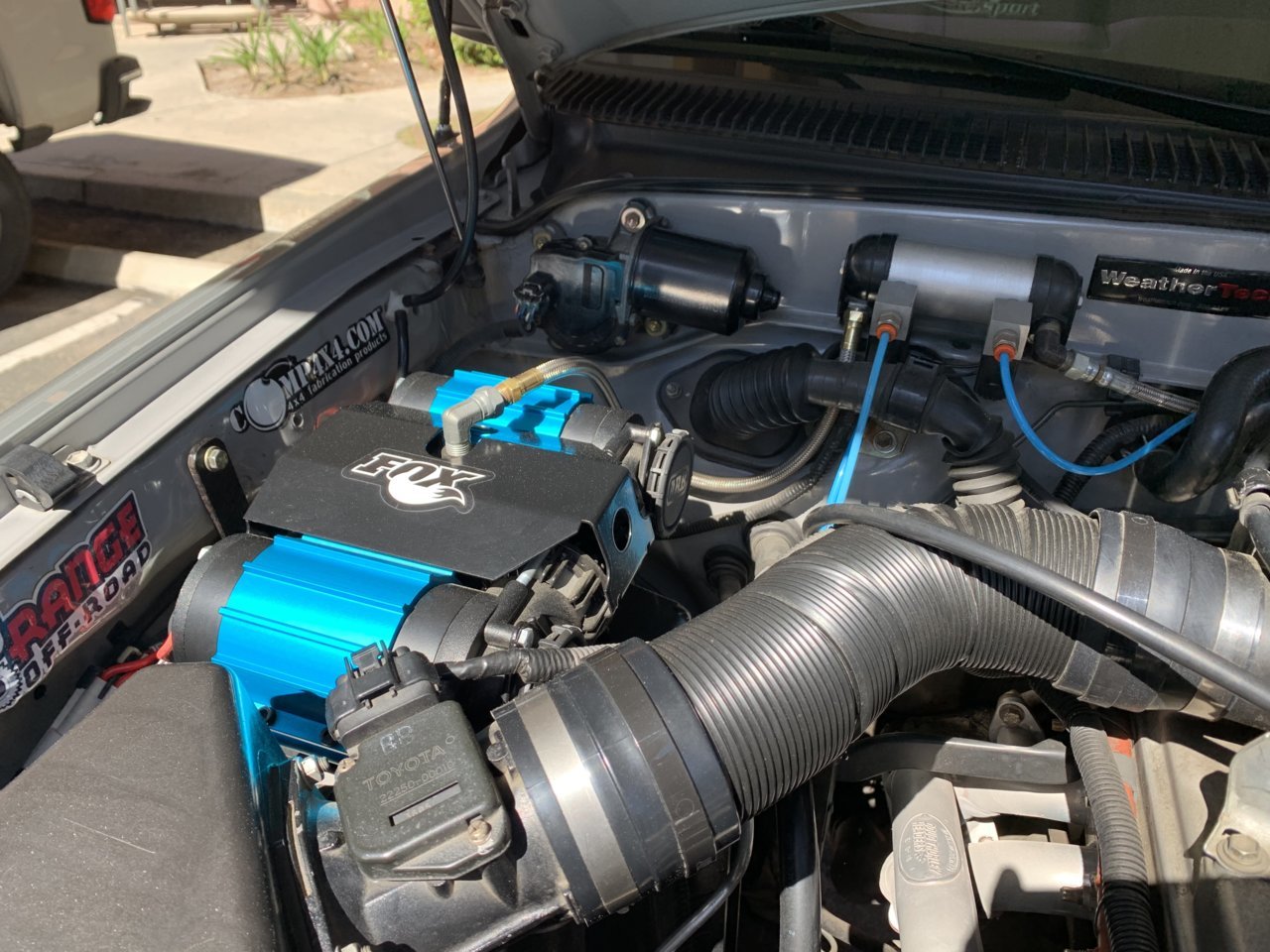

    I suggest mounting under the hood. These get extremely warm while in use.
    I was told by ARB USA that extending the ARB wiring loom adds to the heat and could possibly melt the loom or portions of it... I didn't listen and it did just that.
    Here is where I mounted mine:
    ToyotaDriver[OP] and Wulf like this.

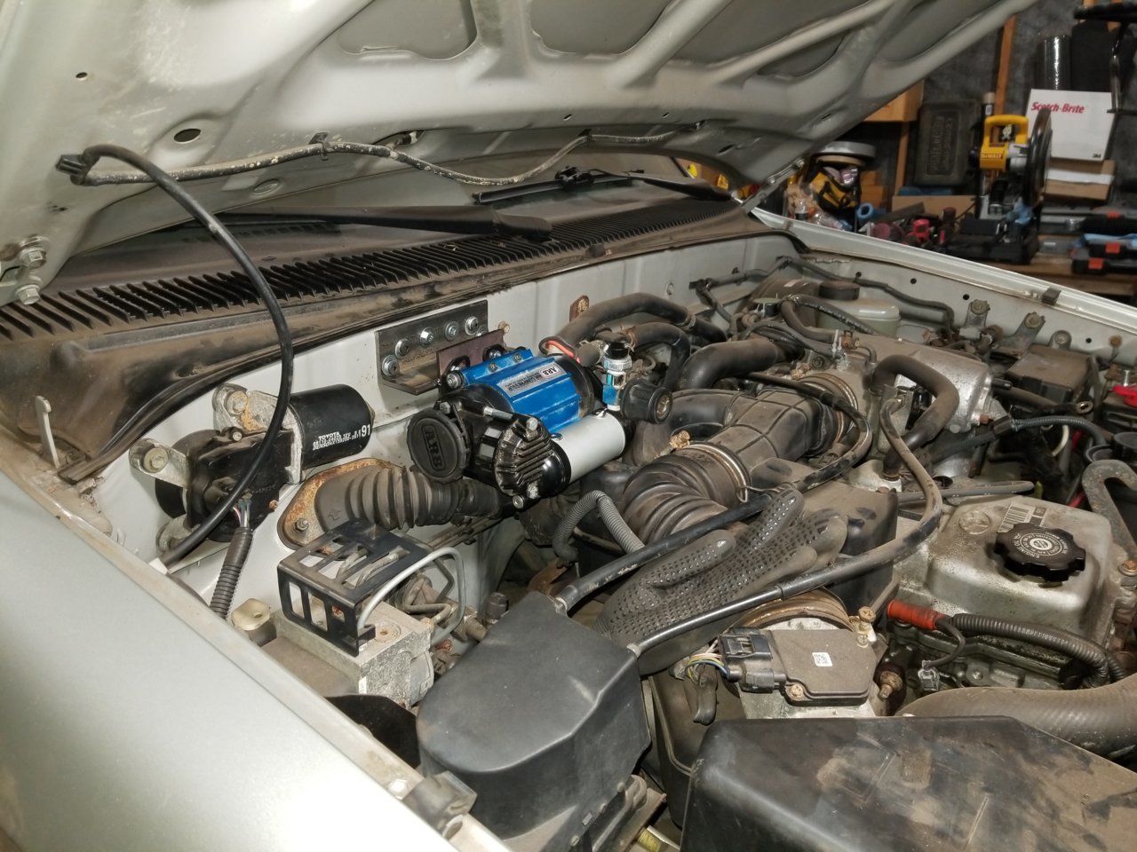

    That's the exact location I mounted mine and the manifold

    Nice... I did this years ago and all is well.
    I did speak to an ARB rep at SEMA some years back about the braided line supplied with their manifold kit. Turns out that the inside diameter was too small and the compressor created too much heat along with cold air and began rusting the inside of that line... making the inside diameter smaller which made the compressor run longer.
    I went with a larger diameter line... it fills my sliders and Viair tank quickly now and shuts off much sooner.

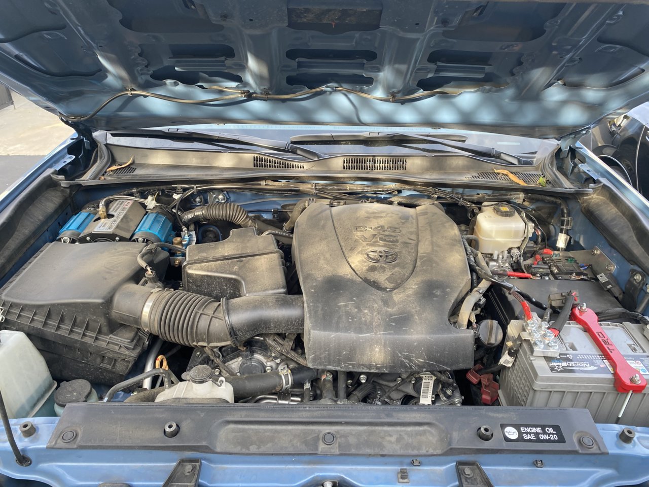

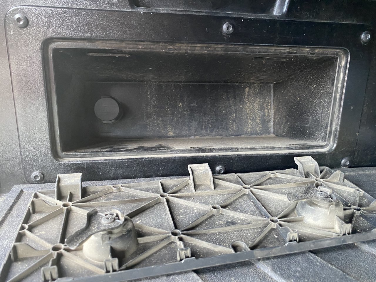

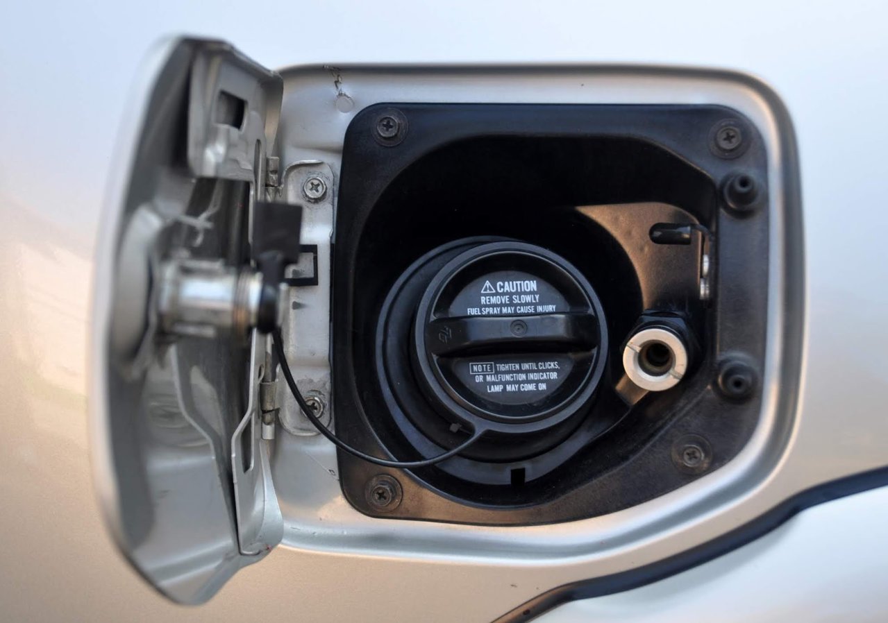

    I have my twin compressor under the hood. Also pulled a line and put a chuck in the bed cubby storage. One question I have is when changing the spark plugs do you need to remove the compressor?
  18. Feb 27, 2020 at 4:12 PM
    #18
    Ritchie
    Ritchie Well-Known Member
    Dec 24, 2012
    #93649
    1,931
    San Diego (North County)
    RC Step side Pre-runner
    2.7 w/auto, 4WU 3 link, F & R Diamonds, ARB's F/R w/ Yukon 5.29's, Inchworm 4.7 Lefty, Deavers, ARB OBA, Schrockworks up front.
    If you're asking me, no. I have the ever so powerful 3RZ motor.
    I did run a line from the manifold to a 2012 Peterbilt fan clutch switch, then to my DS slider. Both sliders now hold air along with a 2.5 gallon Viair tank... then to the ARB fitting behind the fuel door.
    Keeps the fitting clean and out of the weather.
    grogie, ToyotaDriver[OP] and Toki like this.
  19. Feb 27, 2020 at 4:26 PM
    #19
    Toki
    Toki Don’t get killed by Theta.
    Mar 28, 2018
    #248758
    532
    Jon
    San Jose, Ca
    2018 Tacoma 4x4
    Little bit of this and a little bit of that but stock af.

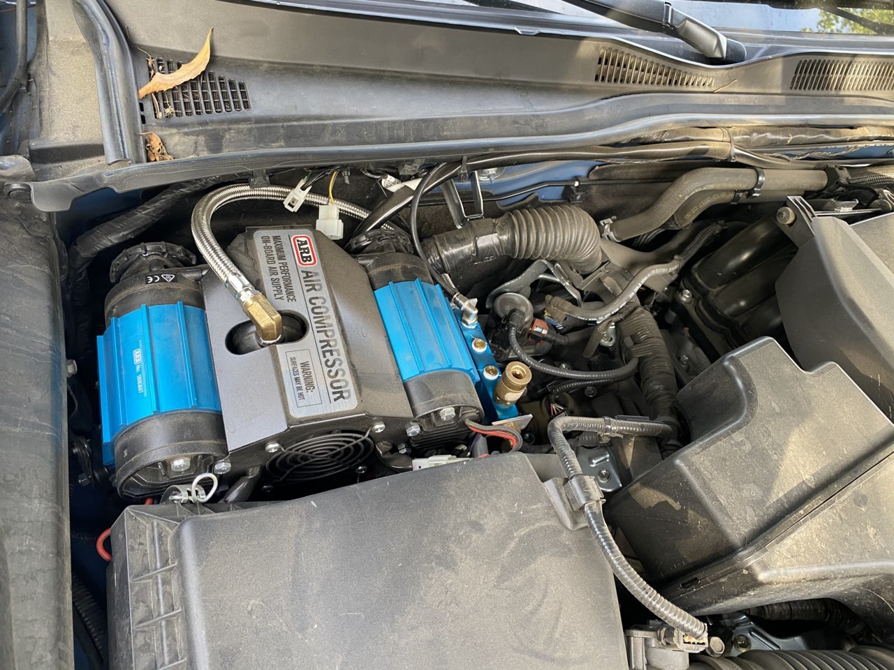

    7CC239D7-9CE9-4E21-9AE3-09F0B4F465D1.jpg 7CC239D7-9CE9-4E21-9AE3-09F0B4F465D1.jpg
    I just realized I was in the wrong gen. Seems like you guys have a lot more room, mine fits but is super tight. I would assume I would have to remove my compressor to do plug maintenance. Here’s some pics....
    DD8EDCDF-3903-4CEE-8B64-9CDDC97557A0.jpg 9A303073-0E13-4C01-87E3-AE523CEFC6C4.jpg
    Ritchie[QUOTED] and Dawdaw808 like this.
