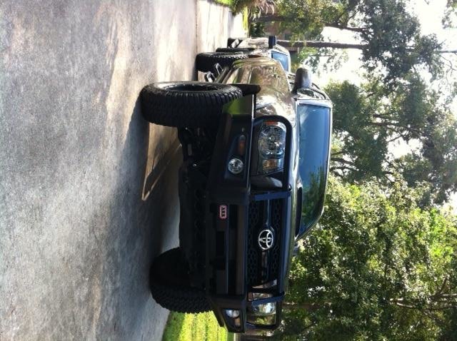

    I had 885's with my ARB and winch. It was recommended by ARB.

    I have 885x on mine with a top plate spacer. I can't remember if it's a 1/2" or 1/4" spacer. It's fine for everyday driving, but too soft for wheelin'. I'm swithching to 886x soon.
