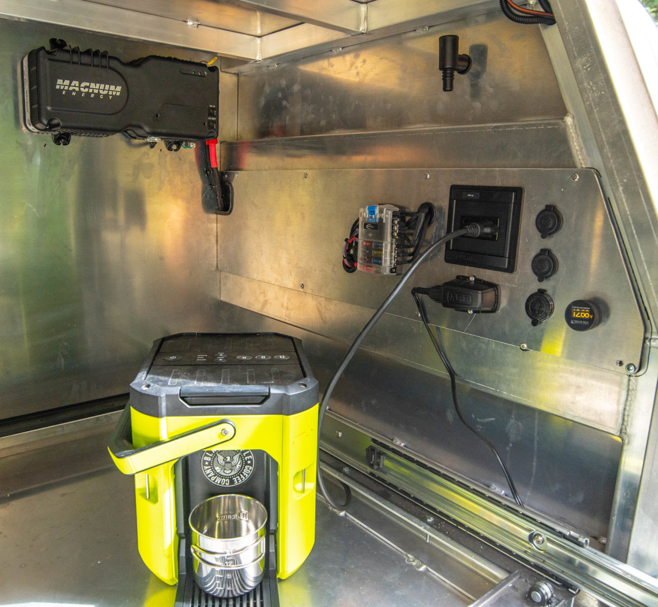

    So now I know where to find coffee when 846 isn't around?

    We MAY have done a deal with the lads at Black Rifle Coffee Company. :thumbsup:
    Doesn't every SAR team need a Coffee Sponsor?

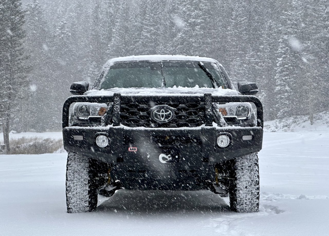

    I'm not seeing any tow points up front on that bumper. Am I missing something?
  14. Nov 11, 2022 at 8:49 PM
    #34
    musicisevil
    musicisevil Lesser-Known Jack Wagon
    Jan 8, 2022
    #386719
    2,287
    Alaska
    2019 TRD Sport
    It doesn’t have any tow points. It’s discussed in this thread for 1st gens which seems odd to me because mine had them. To maintain proper airbag function you they say you can’t recover from the bumper.
    While ARB’s reasoning seems sound, it also seems to me that they want people to buy their beefy $350 recovery point. Having said that, the frame end caps on my 1st gen were bulged and close to failure from snatching from its arb points. There’s a whole end cap reinforcement mod on that gen for this very reason.
    "the reason that bumper doesn't have recovery points built in is due to the very light nature of the frame out near where the bumper connects to the chassis. Specifically, our engineers designed the bracket to accept controlled winch loads which rarely exceed 10,000lbs, but could not build a system that would work correctly with the crush rates for the airbags and tolerate snatch type loads (which spike extremely fast and often exceed 25,000lbs) at the same time. This is why the factory recovery point is reused since it's back further on the frame and much more robust in design. Unfortunately very few modern vehicles have sufficient structure and strength in the frame horns to allow for solid recovery points to be added along with the bar. You pretty much have to get to fullsize trucks to find a serious frame and rigs like the Tacoma are just too car like in engineering to allow us to include recovery points even when we would like too."

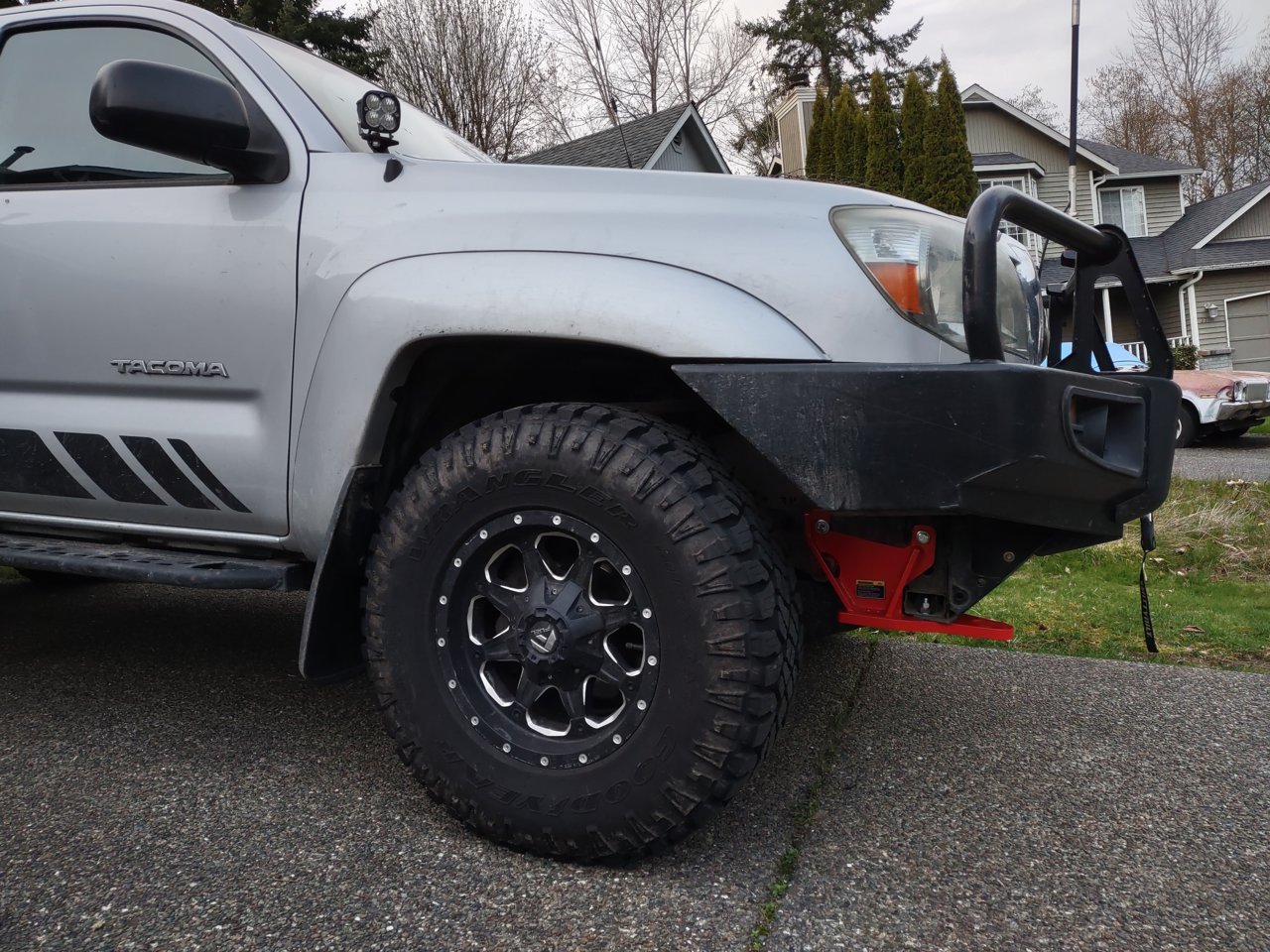

    Gotta get one of these if you want a stout recovery point with an ARB. I'm all for it since I wanted to keep proper air bag functionality. If only a wheeling rig, I'd get a different bumper, but for all around use, ARB is probably the safest out there. Has proper crumple supports and stuff, not just solid steel bumper to frame. Unlike all the rest, ARB properly tests and rates all their stuff.

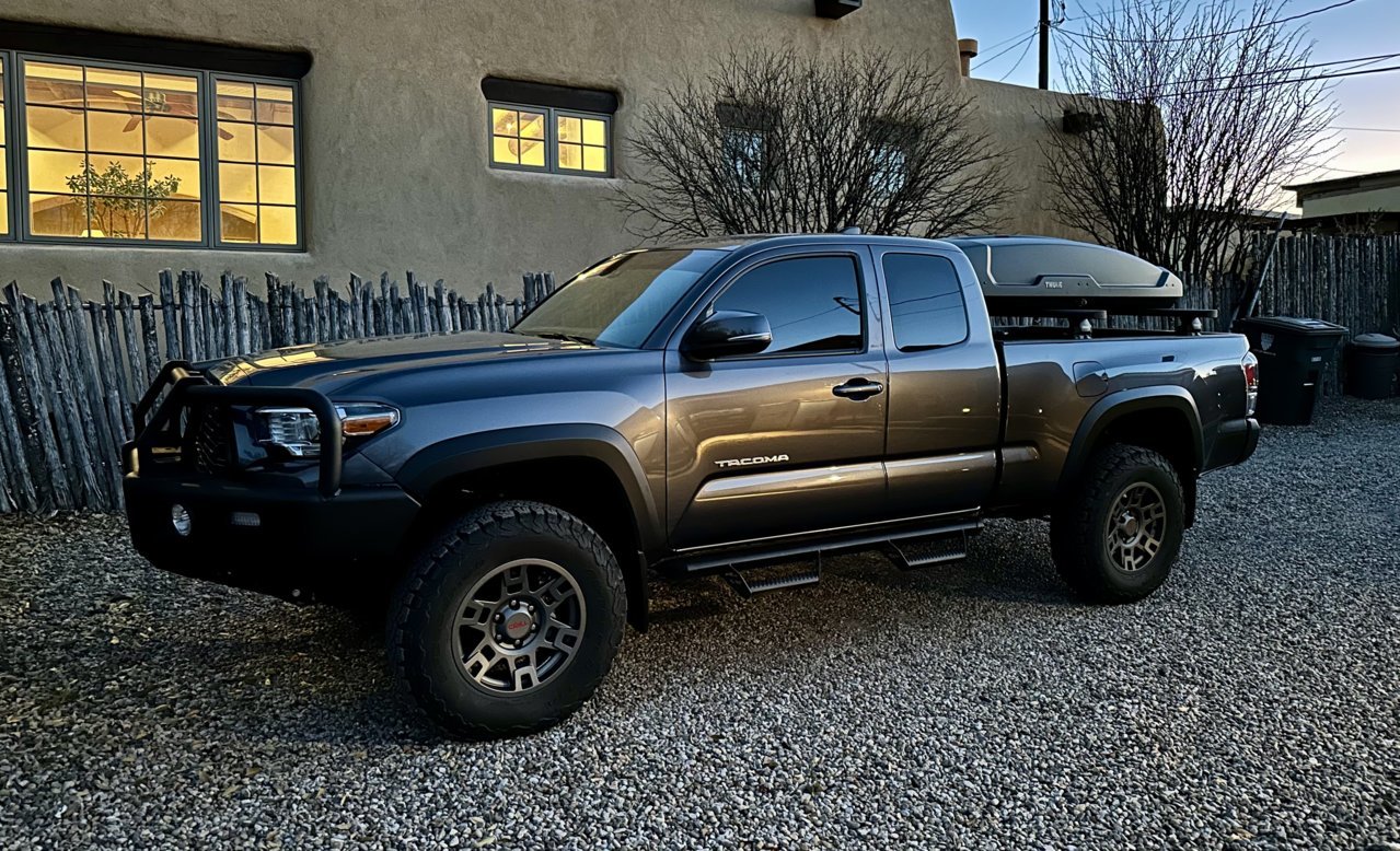

    I love the Locust badge!

    Never expected that to get recognized on this forum!
    I was sooo bummed when Gabe Serbian died. They played a handful of shows the year prior and I was hoping to get to see them live

    my man, I’ve still got my locust belt buckle and wear it daily (I’m 35 and still weigh the same-ish as high school). Still have the 3” cd and vinyls - I saw them live at like 14 and that was that. Only grindcore band I ever really liked but their shit was real and the logo is undeniably badass. And sadly yes. Rip Gabe.
