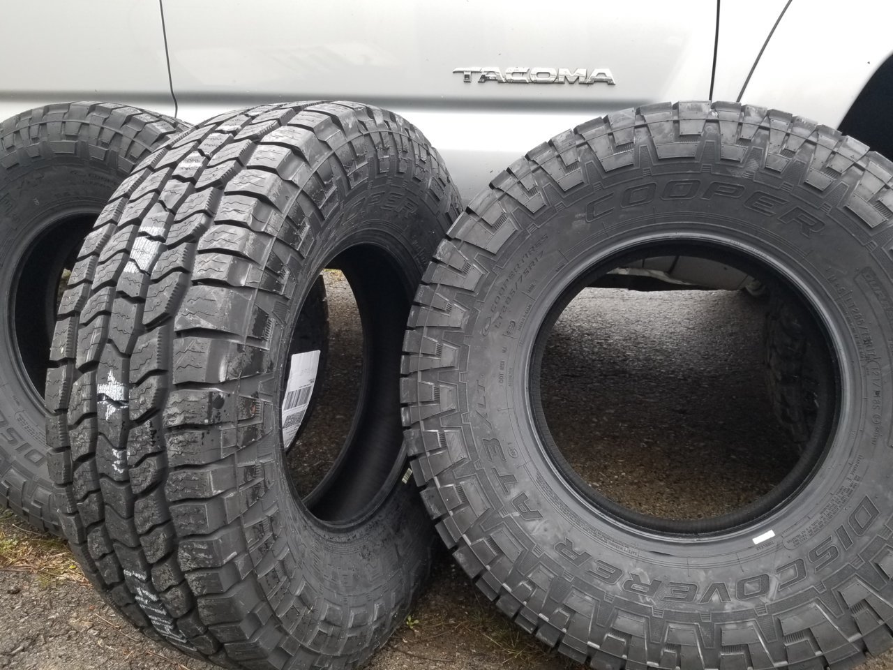

    285/75-17 Cooper AT3 XLT showed up today
    These are ~33.8" diameter. I am looking to cross comfort, low noise, reasonable mpg for decent range, and decent traction for 95% of situations.
    When I go on a long trip, I want to enjoy the drive, minimize fatigue from noise and vibration, and not be hampered on fuel range
    I was happy with my Cooper ST Maxx prior, so thought the new gen AT3s would also be good fit. I also love BFG K02s, and was considering the Toyo Open Country ATIIIs. Lots of good tires out there, but happy with the Coopers

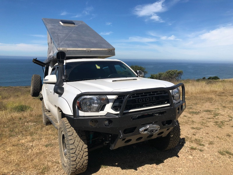

    Sub’ed, interested to see how this goes. My short bed camper build is a little further along than yours but I’m curious to see if I can steal some of your ideas :rolleyes:

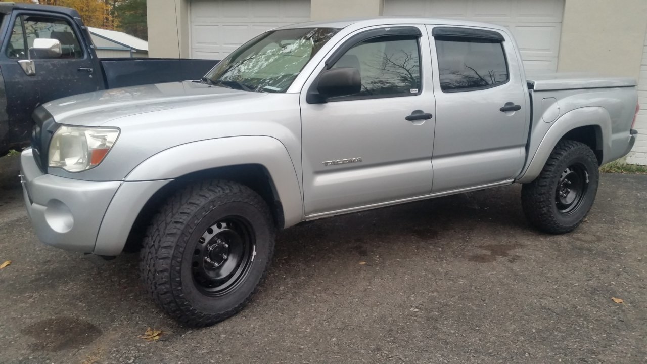

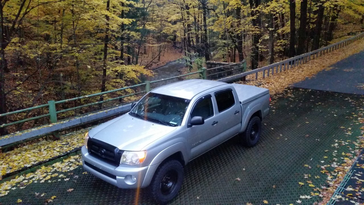

    Sold the tonneau cover and the 4runner wheels in last 24 hours.
    First time it's been without the cover and I like it, but plan is to build a camp setup on it.

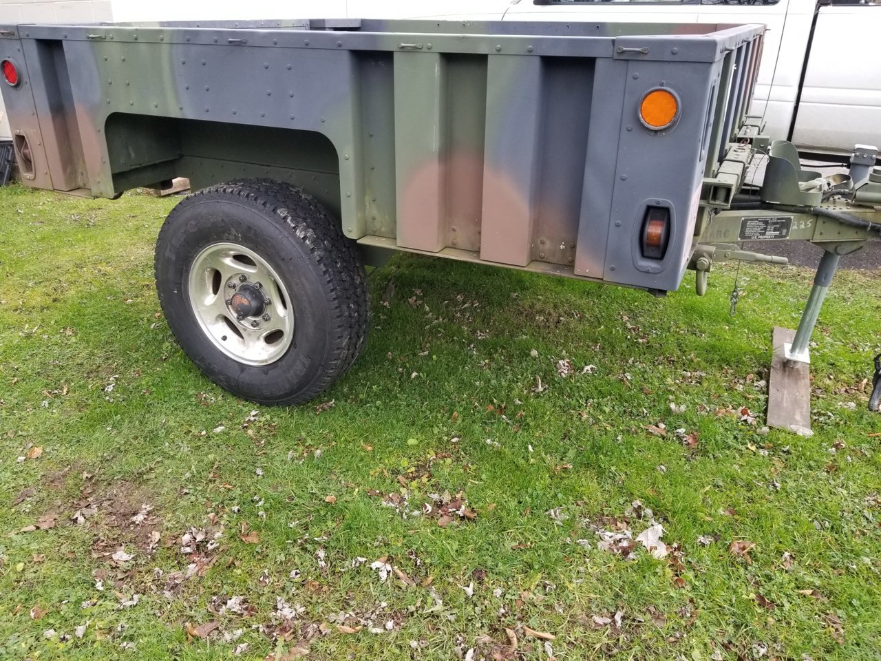

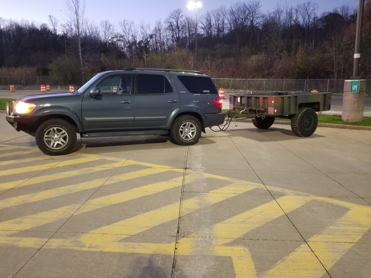

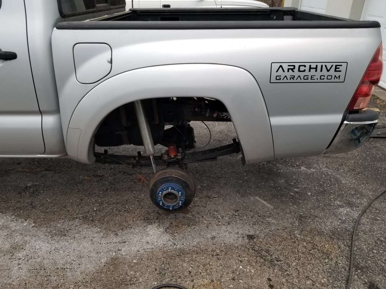

    Swapped the M1101 offroad trailer to some 16×8 Dodge 2000-2002 aluminum wheels and 265/75-16 Firestone Transforce tires.
    These are same wheels on my 02 Cummins.
    (These Dodge wheels are perfect since they have a 6.5" backspacing, and Humvee have around 7")
    So much easier to handle tire changes, plus the excessive height of trailer came down 2".
    And the aerodynamic and parasitic drag will be lower.
    I didn't measure the weight, but they were easy to toss around, maybe 1/2 the weight of 37s and steel wheels

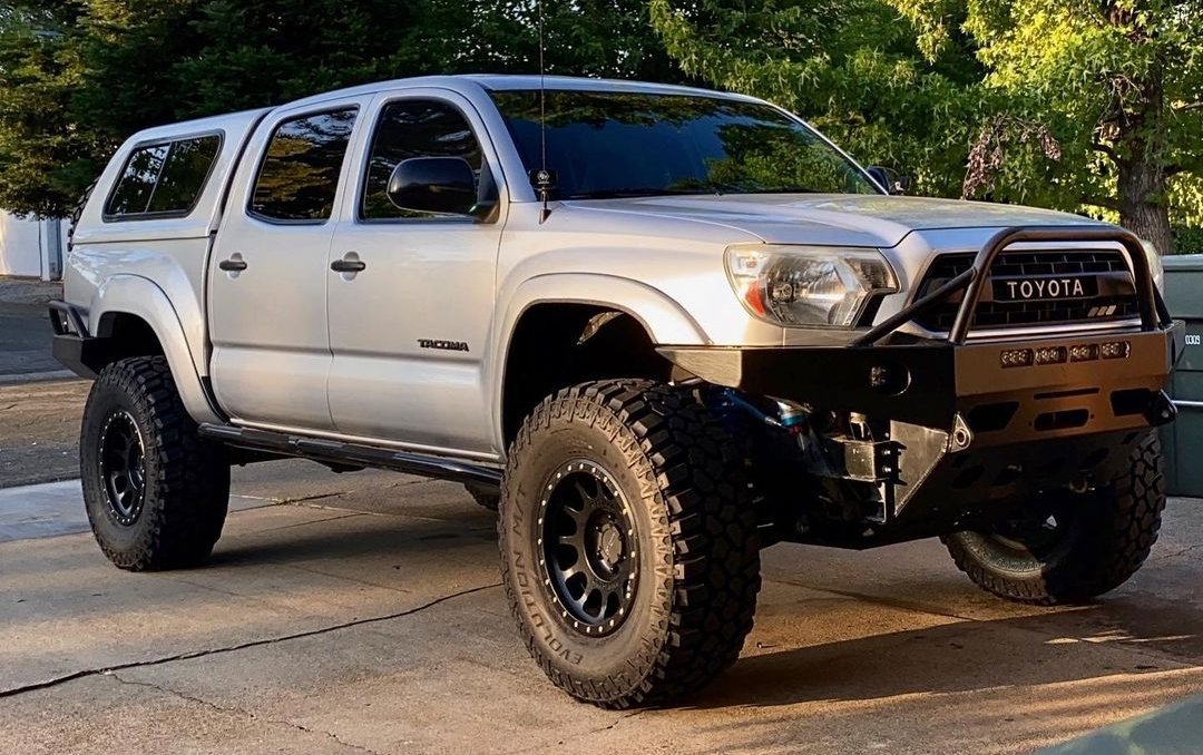

    I'm really excited about the Brute Force Fab 2012-2015 plate bumper on order with full headlight protection.
    Going to update to the newer headlights, hood and grill
    Couple pics for reference

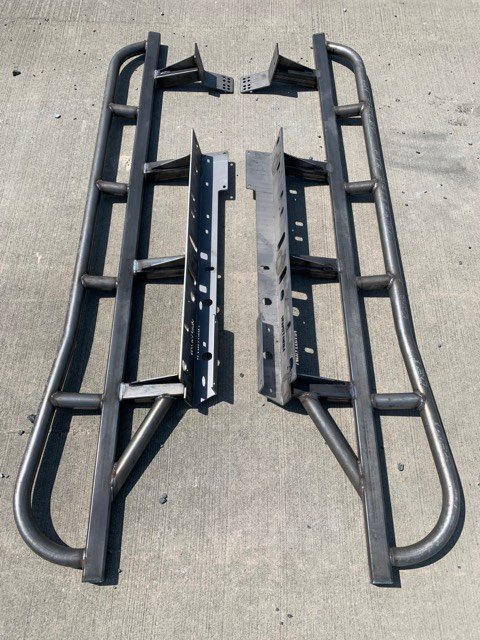

    Got @Mobtown Offroad Heavy Duty bolt-on sliders ordered up this week! Went with kickout (standard), but did not get fill plates
    https://mobtownoffroad.com/product/2005-2015-toyota-tacoma-heavy-duty-bolt-on-rock-slider/
    • Kickout Standard
    • 3/16″ Thick Steel Attachment Plate
    • Mobtown C-Clamp which boxes in the frame rail
    • Mobtown engineered Clamps provide additional attachment for the most stressed edge
    • 100% No Drill Bolt-On Design
    • 2″ Square x 1/8″ Wall Steel Tube used on Legs and Main Tube
    • Legs and Main Tube Overhang Reinforced and Gusseted
    • 1-3/4″ Dia x .120″ Wall DOM Tubing Standard
    • Grade 8 Bolts, Nuts and Washers
    • Strongest Bolt-On Design On The Market
    • Website lists 140lbs for DCSB/ACLB
    It's all it the details right? I really like that the Mobtown HD sliders have done a lot of things right
    Pic from Mobtown site

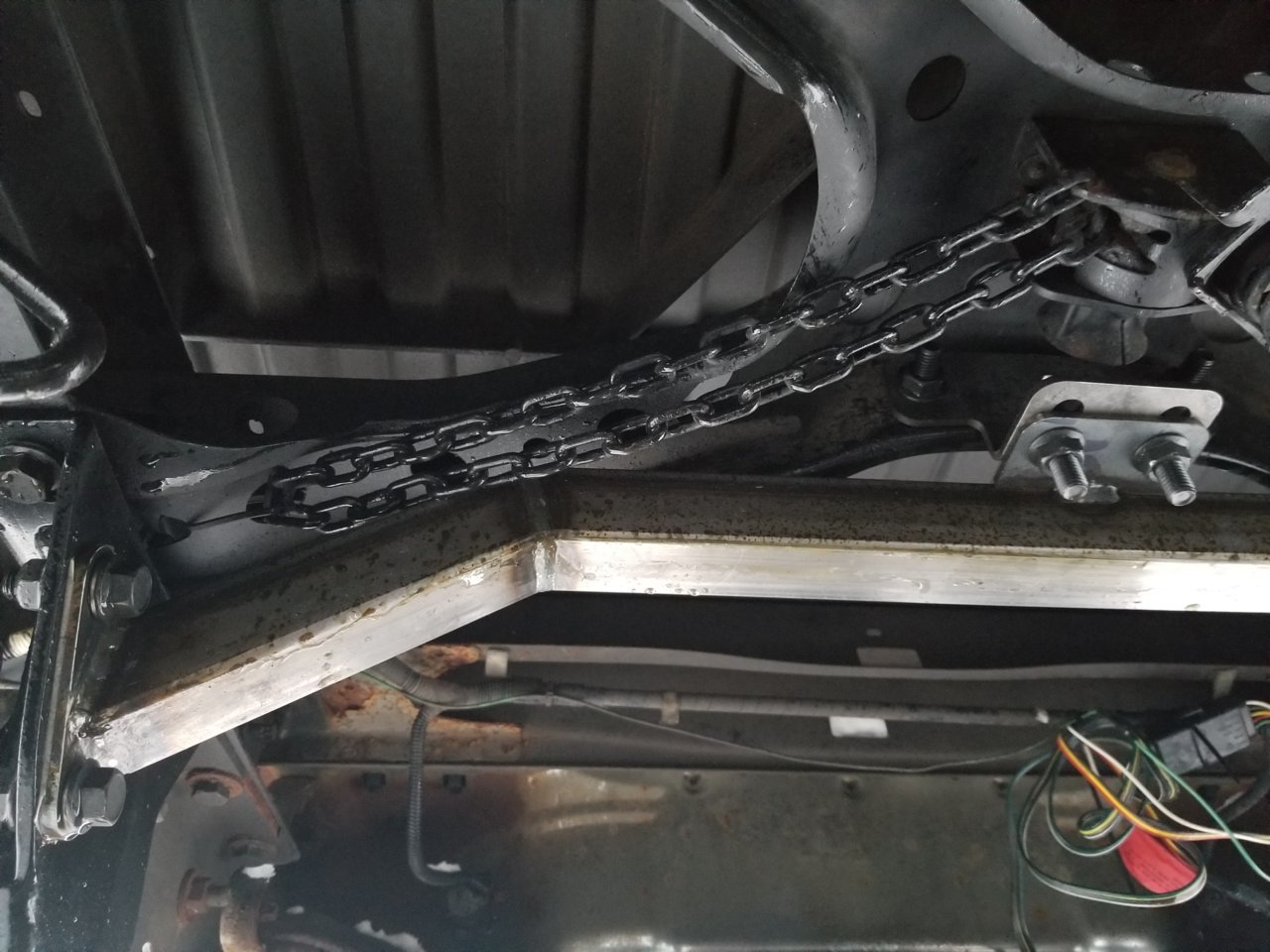

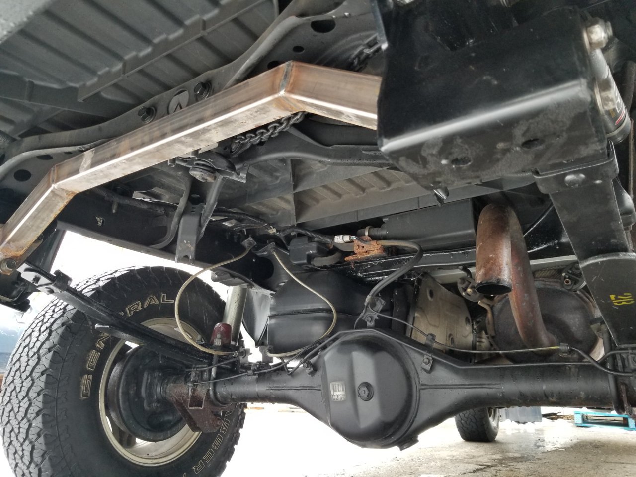

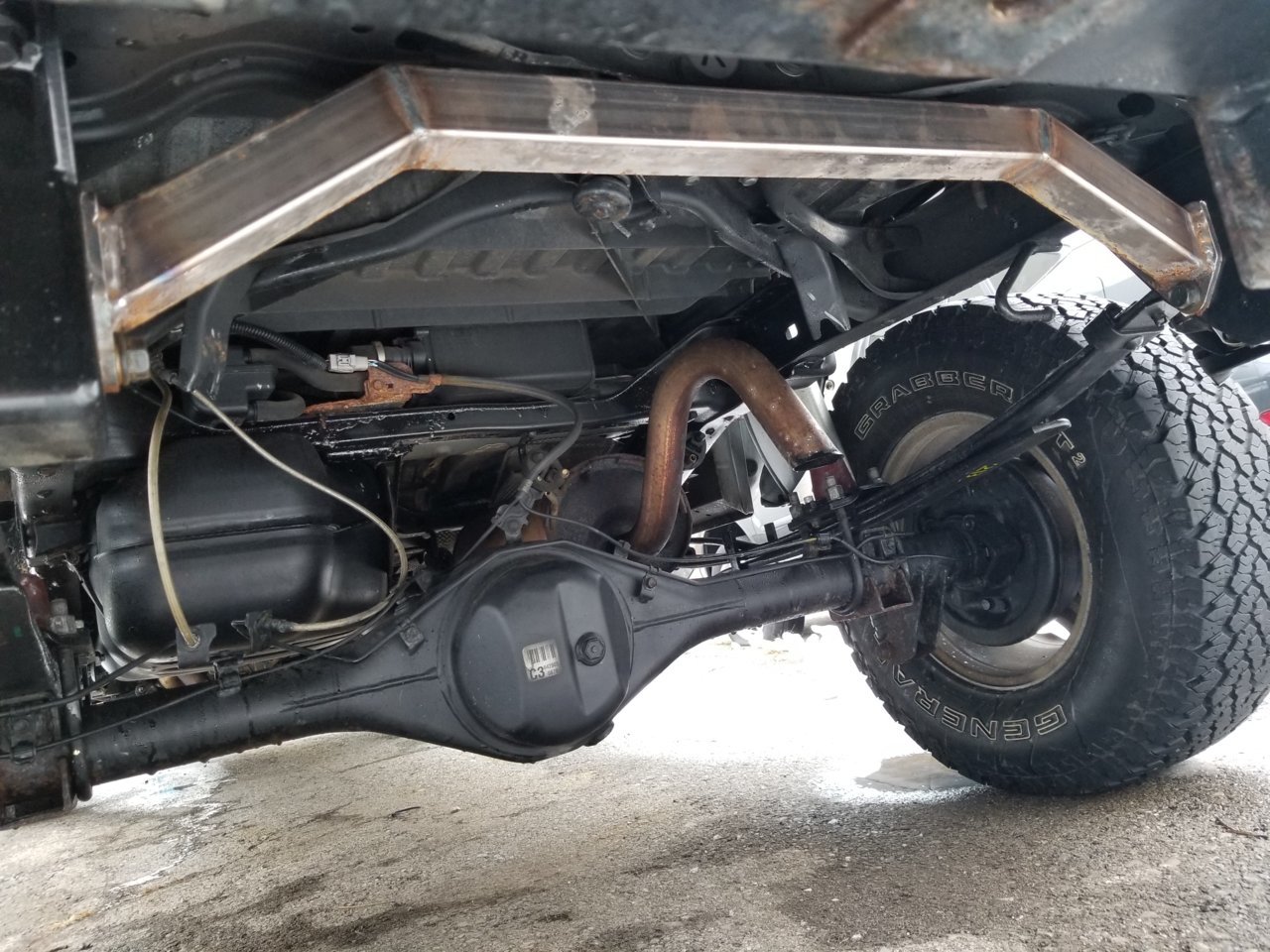

    New Archive High clearance cross tube installed and tested on my Tacoma.
    Highest clearance cross tube on the market, which compliments the highest clearance hangers. It also connects to the stock cross member, 100% bolt-on, no drilling.
    Did A-B-A-B testing vs the original Archive straight tube, the High clearance didn't improve ride quality vs the straight tube.
