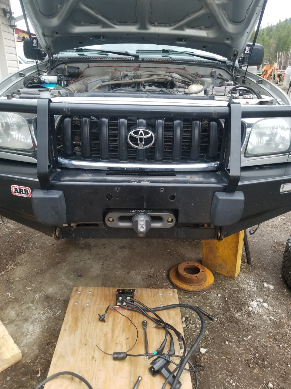

    Installed factor 55 pro link and fairlead.

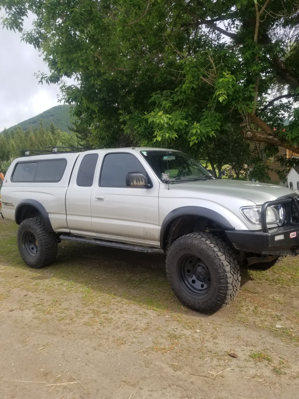

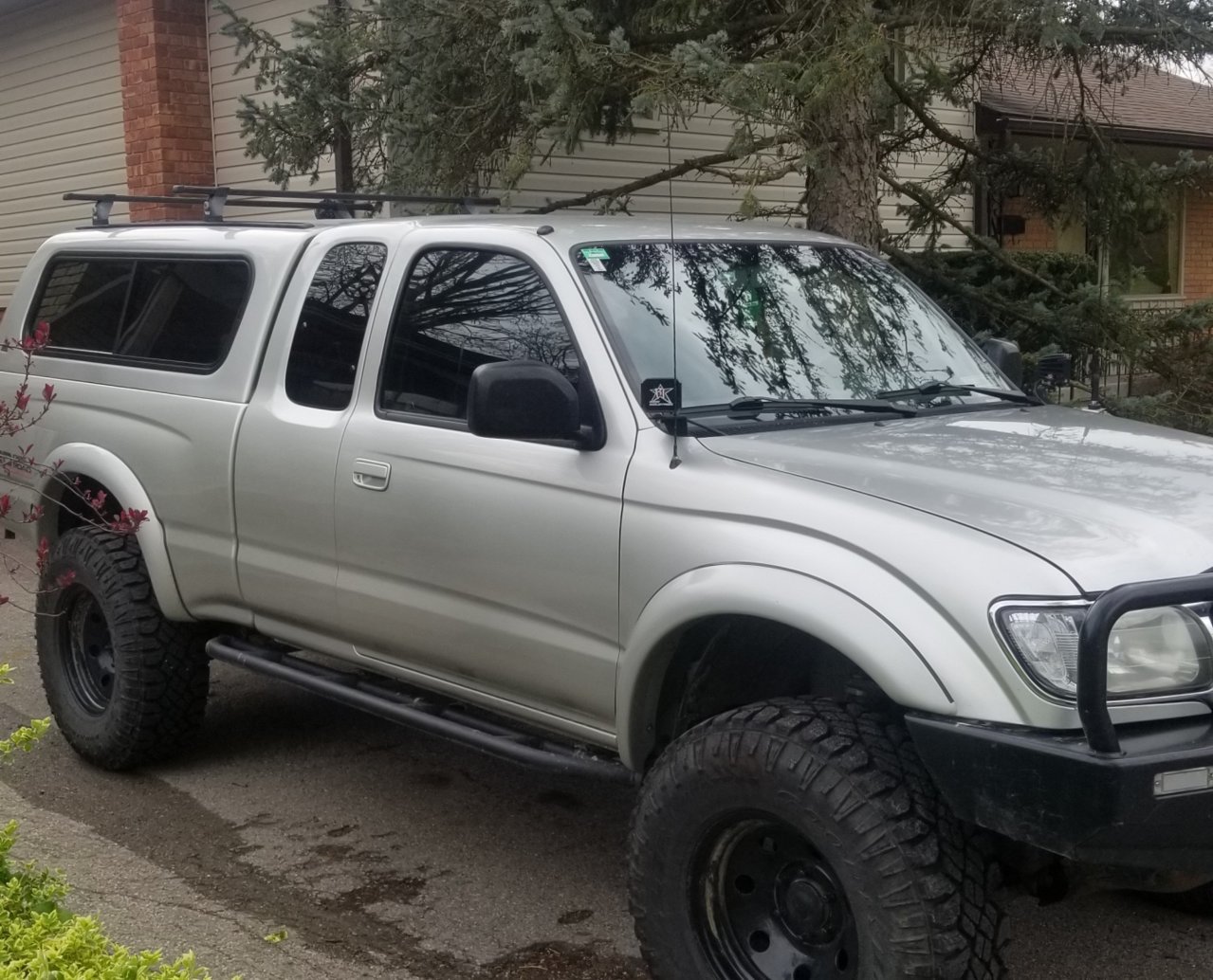

    Picked up a Leer 100R
    And sold the RTT:anonymous:

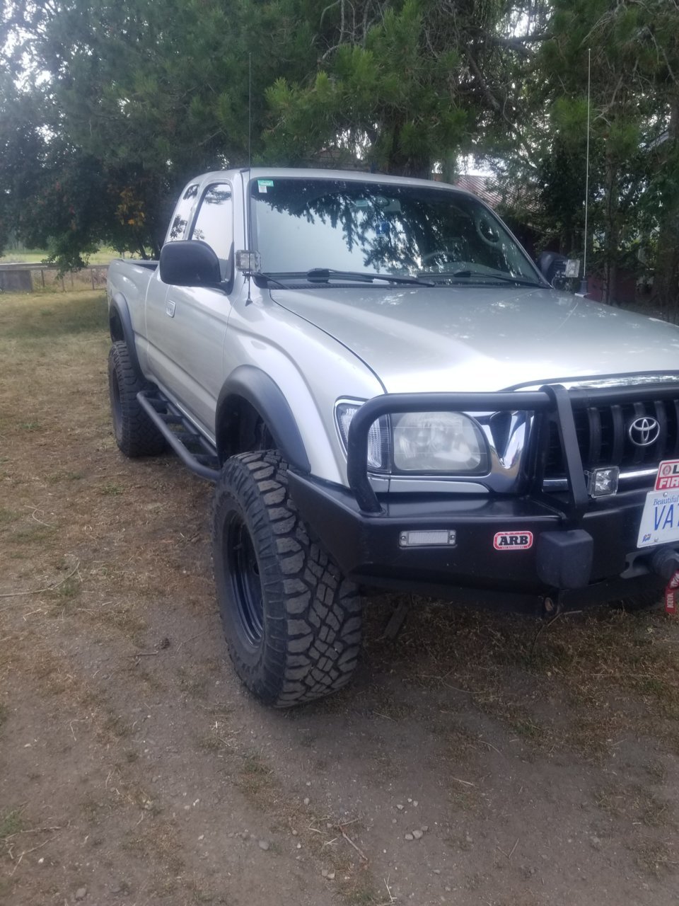

    Update:
    Got back a couple weeks ago from a 3wk cross country road trip.
    Also painted my flares.

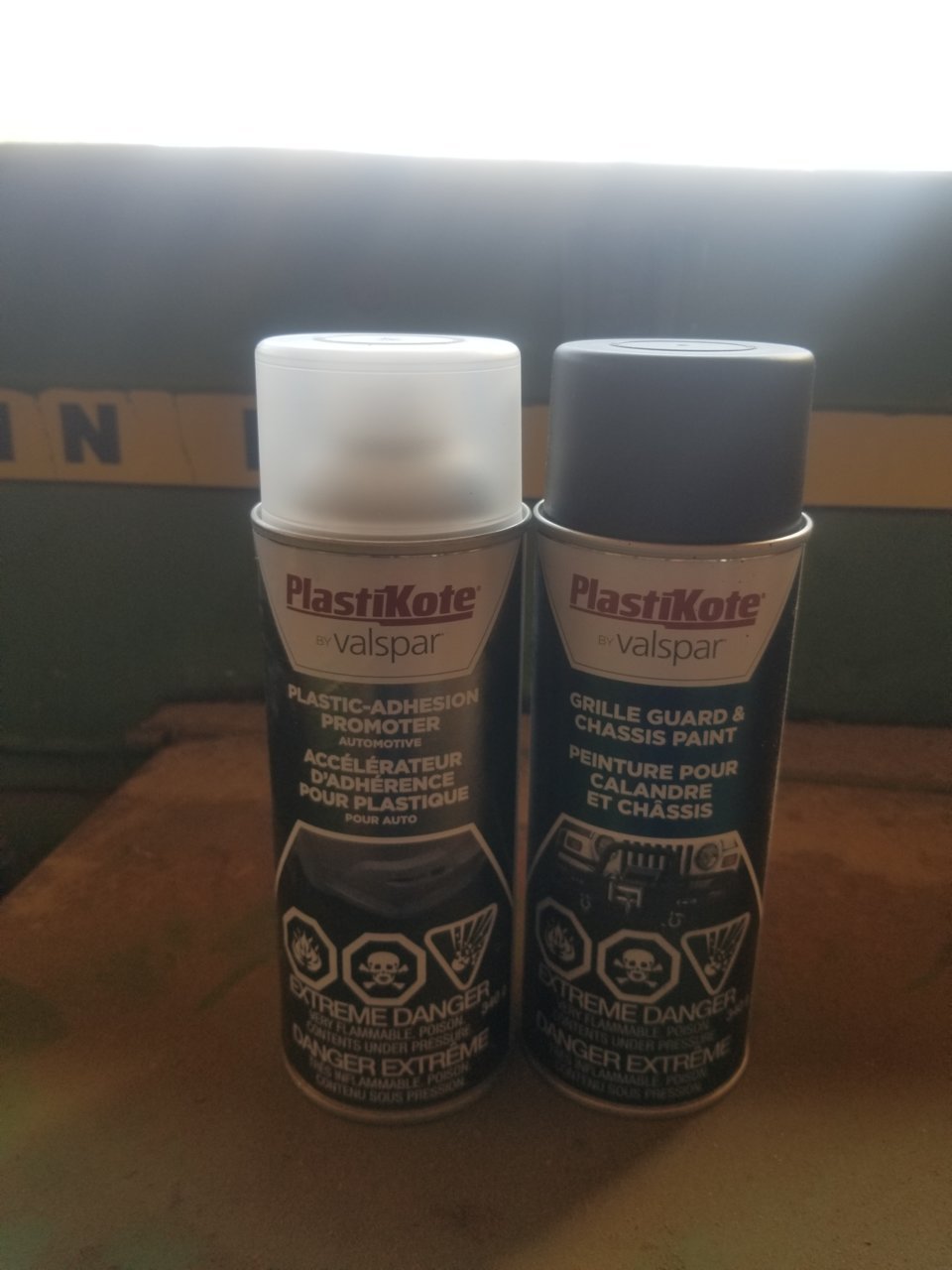

    What did you paint your flares with?

    One coat of the adhesion promoter. 3 coats of paint.

    You'll have to let me know how it holds up. The heat gun technique worked well but I am seeing it start to return to how it was....

    I haven't pressure washed it yet. That's a big test. I sanded them down quite a bit with 220 grit. Like a lot. Sp hopefully it's good. I'm hoping it lasts 3 years is the idea

    Finally washed the truck. Fenders held up good. Although the pinstriping is so bad from tight trails. :annoyed:
