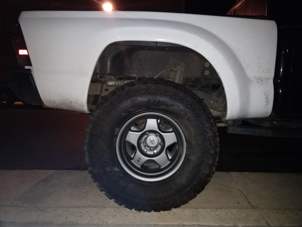

  16. Jan 23, 2019 at 9:24 AM
    #436
    Arcticelf
    Arcticelf [OP] Well-Known Member
    Jul 18, 2015
    #159735
    7,572
    Gladiator
    Borrowed a 35 from @fatfurious2 to see how it looks. Still lots of room, maybe need to go bigger...
  17. Jan 23, 2019 at 9:55 AM
    #437
    fatfurious2
    Jun 28, 2014
    #132884
    48,573
    David
    Ashburn, VA
    2010 TRD OR Access Cab
    Remember ECGS wont warranty over 35s
    Arcticelf[QUOTED][OP] likes this.
