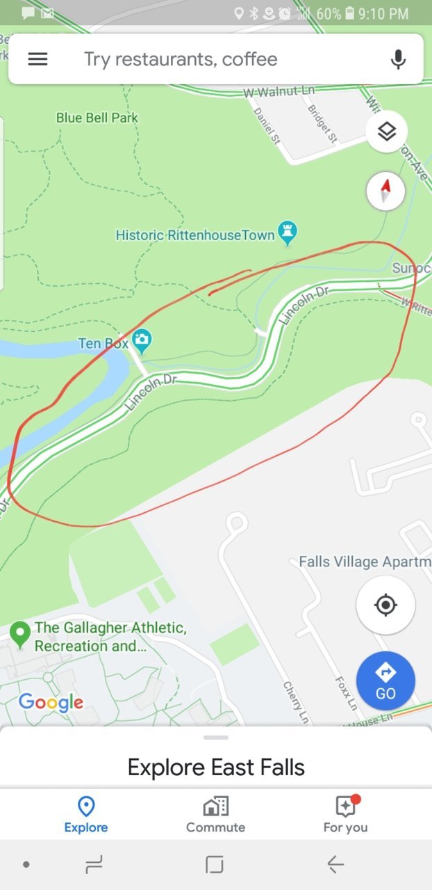

    What's your front suspension? I thought you were either stock or billies, but after rereading your post about adjusting the clickers, I guess you have something different. I think I took my swaybar off when I had billies. In any event, @fatfurious2 is right, I have the bumper, armor, and winch. My kings have the 700# coils. I take this road on the daily. Its 25mph, but I've hit it around 45-50 and I didn't feel uncomfortable. Although, I usually drive fast and maybe I'm just used to it... I try to push the speed as much as I can actually, on this road... when no one is around... in dry conditions. Lol
