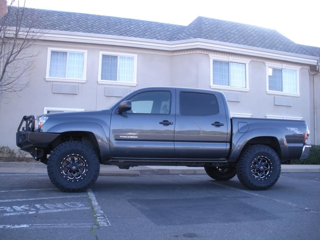

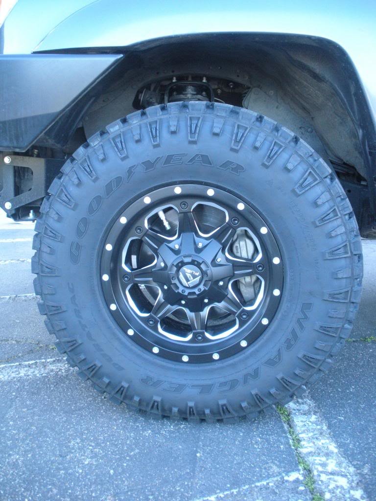

    Holy heck, had the new wheels and tires put on today. They are crazy awesome. The 285/75/16 fit perfect without any rubbing or need to trim. It's dark now, but I'll throw up some pics tomorrow. Thanks to all who encouraged me to go for it! My midlife crisis is now complete...on the other hand maybe I need a nice new gold chain and a spray on tan.:p

    Find a big ditch that will fully compress your suspension. Make sure the front bump is touching. Turn wheel lock to lock looking at the rear of front fenders every 10 degrees. Take pics... cause without trimming it WILL rub.

    Looks good but unless you have no up travel you are going to rub....
