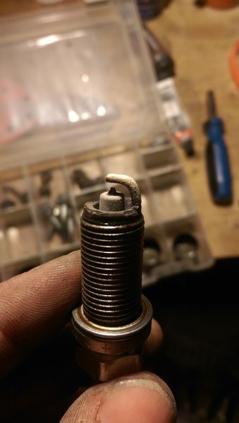

    Every single spark plug looks like this:
    Now about to do the cylinder leak down test.

    White usually indicates oil deposits.
    When you did the valve stem seals, did you ensure you used the proper ones for intake and exhaust?

    From that plug, it looks like you do have some oil consumption. When you had the heads off, how did the cylinder walls look?
    Though I still stand by the idea that you are losing oil through other means. At 3.5qt in 1500 miles, you should see more buildup on the plugs if it was all getting through the cylinders.

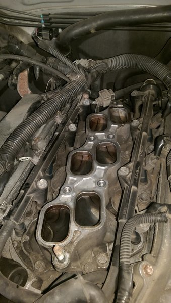

    Also, the intake plenum shafts look pretty clean -- I'm guessing they would have more buildup if I were burning much oil:
