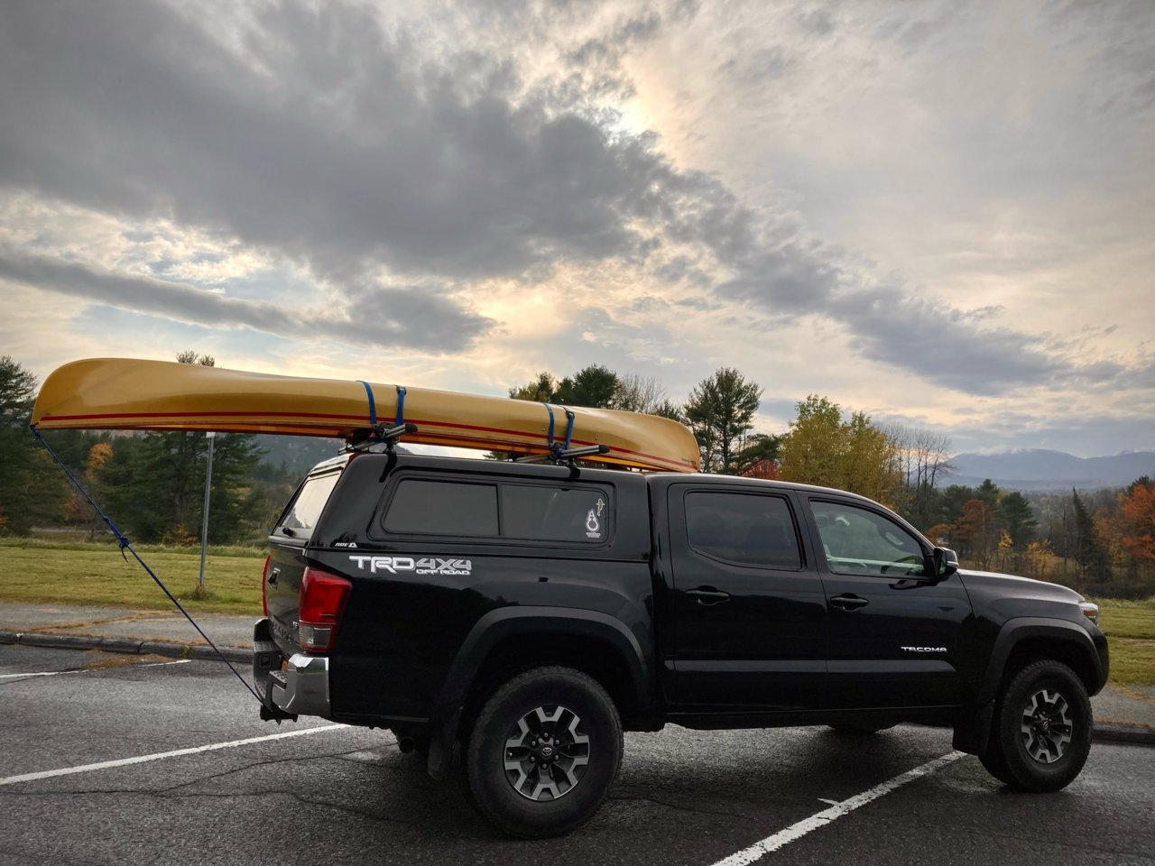

    Anyone out there try rig/mod bar extensions or use alternate bars? I want, in order to strap down a pair of canoes without losing bed space, to have 70" bars. ARE customer service said nothing they offer in 70" bars is compatible with the HD set up.
    Looking for suggestions / insight from those who are clearly more versed in this area than I am. Thanks for any help.
  10. Aug 20, 2021 at 10:14 AM
    #110
    79CHKCHK
    79CHKCHK Padawan of Rock Lobster
    May 20, 2019
    #293877
    682
    SoCal no mo
    2018 Super White TRD Pro AT
    It should be easy to rig any bars you choose. Each bar is held on by 4 bolts. Standard t slots in the top and bottom of the stock bars.
    Rebel Darling[QUOTED] likes this.
  11. Nov 3, 2021 at 9:03 AM
    #111
    Rebel Darling
    Rebel Darling Proud Newbie
    Oct 17, 2019
    #308228
    4
    Sand Lake, NY
    2017 Black Tacoma, Double Cab, TRD Off Road
    Thank you very much.
    Well, it was pretty easy, once I got those darn bolts off. Ha. Cap came with the truck, which I bought used. The bolts, lock nuts and washers rusted and fused with the slot nuts, and there wasn't any budging them. Just a bunch of stripping the bolt head. Needed a couple of carbide blades for the reciprocating saw, and bet that all the bolts were common from frame to bar bolts. Good gamble, and it paid off; there were other slot nuts on the ARE bar top plates that weren't fused to the bolts, and I reused those, but still had to cut those heads off because the bolts, lock nuts and washers had fused to the plates... Took a couple of hours, sans trips to the store, etc.
    Maybe a helpful FYI:
    - ARE HD cap bolts: 6mm x 16mm, 1.00 pitch.
    I also used those size bolts to replace missing ones on the interior of the frame.
    Purchased the Thule ProBar Evo at 69". They're working great, and no additional noise I can hear. Picked up the new canoe and rolled around at 70 mph with no issues.

    Did you tie the front to anything? I'll be looking to have the same set up next summer except with two canoes. Was thinking if I should put a rack on the cab to tie to.
    No matter how well everything else is secured I always worry a bit with the front not tied. Especially with the straps on the cap rack so close to each other.

    I'll have two canoes up there by May of next year, so I incorporated that plan into the setup. Here's the game changer, for me:
    Thule Canoe Portage:
    https://www.thule.com/en-us/winter-and-water-sports-carriers/canoe-roof-racks/thule-portage-_-819001
    Maybe there's a similar product, less expensive... Dunno... Had a bunch of LLBean Bucks to burn, and picked up two sets. These certainly work. That canoe was tight to the bars and portage "racks" and didn't move. At the recommendation of the folks that made the canoe, I put a piece of foam under that bow so that it wouldn't scratch the cab roof paint. They said that roping the bow off with this configuration would only wear out the paint on the truck, and not provide that much more security. They also said that I didn't even really need the rear rope, which ends up being true. I drove around with that thing on the bars for hours at 70 mph. Held fast. I was definitely nervous for a while, but the canoe didn't budge. My comfort level increased exponentially, and I've no qualms about this attachment system.
