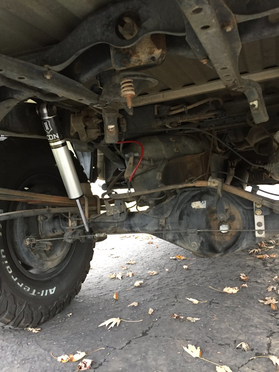

    Well dammit, so you guys said how I originally had my shocks was the proper way? Now I’ve installed the upside down

    Don't believe everything you read on the internet.
    I installed mine stickers right side up like Bilstein says. People seem to go both ways on this one.

    Yep learned that lesson. Now my drain holes are pointed up, and put two and two together, between the label being upside down and now the drain holes the wrong way. The shocks are not up side down ‍♂️‍♂️

    Easy fix is a hot paperclip slid/poked through the boot for some drainage..

    Yah I think I’ll just put them back to how Bilstein designs them be

    I installed my ICONs body at the top like the first picture - otherwise the ICON lettering and label would've been upside down.

    No company in their right mind will release a product with their name difficult to read in the installed position unless the location makes reading impossible.
