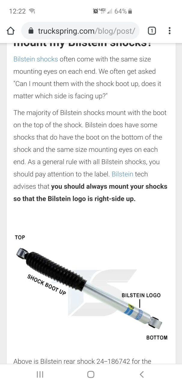

    I’m NOT an expert. I did read once to always mount them logo up. I’d call or check with manufacturer on your specific model as I do know some are boot down.

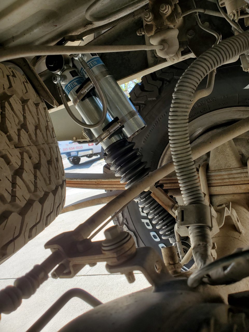

    Idk works great for meScreenshot_20190805-122246_Chrome.jpg 20190811_142157.jpg

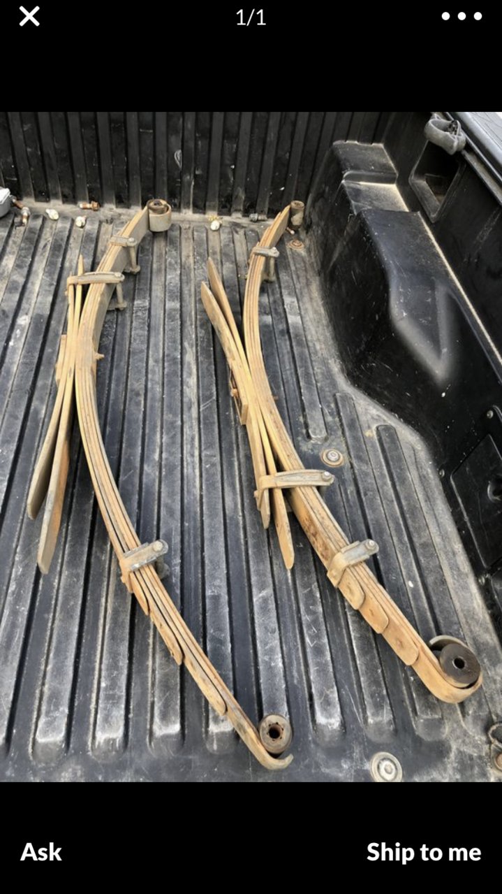

    I found a set of factory leaf spring off a 2003 tacoma they have 129k on them, and I got the guy down to $100 so it seem like a steal. But I would like to get another opinion. Based on this picture do these spring still look like they have some life left in them, I think I’ll just throw some new bushing in them before I put them on my truck.

    Pass.
    I couldn't give away my springs if I wanted; after I installed my OME Dakar's, I took the factory leaf springs to the recycling/dump.
