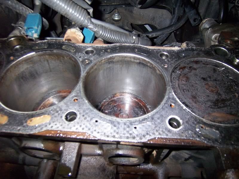

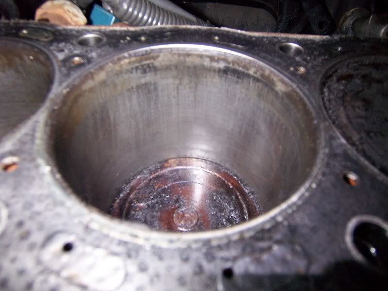

    My engine would not start due to really low compression, so I took the head off and here is what I found. The tops of the cylinders are pretty rough looking, but I don't know if this is normal wear and tear. The truck has 113,000 miles on it. From looking at the owners manual, the previous (1 owner) owner took very good care to record all the maintenance. I took meticulous care as well. (97 Tacoma 2WD w/2.4 Liter

    that looks like a pretty good sized ring at the top of cylinder though... if there is a noticable ridge there like it looks like there is you atleast need to have it honed and new rings probably..thats called ring ridge...where the cylinders wear out from wear the rings slide up and down leaving a ring around the top that is fresh metal

    Your engine shows sign of oil consuming, burning. Your oil rings must be jammed,
    Your valves do not look good at all. There was a lot of oil residue on your valves.
    You better change your rings, valve seals, etc...rebuild the whole engine.

    +1 the deposits are due to warn rings and when rings go valves follow. You can probably rering and do a valve job and call it good but as stated by someone else, once you start pulling pistons to rering you might as well rebuild the whole motor.
