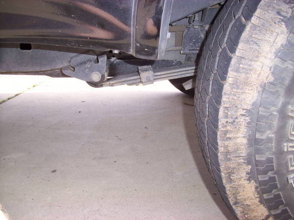

    I bought my truck about a year ago with 79k miles, I never noticed anything until a couple months ago when I hit bump stops over a bump in the freeway with a dirtbike in the back. Later i jumped in the bed and it seemed quite soft and my leaf springs almost look like they are put on upside down they are frowning so much. Can they be fixed with an AAL or do I need new leaf packs. I am a fulltime college student so money is definatly an issue.

    If money is an issue find a shop that will re-heat and arch them to factory specs. An AAL alone will not do the trick.

    Do you think rearching with an AAL will keep it from flattening out quickly? I am looking for a firmer ride and more carrying capacity. at least enough for a bike and a gear bag without hitting bump stops.

    Mine are starting to do that, but Im not to concerned, I'd just go until one breaks

    Hey, man, seriously, there are about 9 million posts under the suspension forum with this exact same topic. I am not trying to be obnoxious, but there is a wealth of info already on this site.
    Search for leaf springs or leaf replacement, and you should find more than you need quite quickly. :D Use the search, Luke.
    Also check the Group Buy threads for Wheeler's Leaf Replacement that I put together earlier this year (it is long over). Hundreds of great posts from lots of great people trying to figure this out.
    By the way, the answer is yes, they are shot. The OEM spring suck. If you haul bikes, look into Timbrens as an option, per Dan at Wheeler's Offroad.

    Yes, they are starting to bend. If money wasn't an issue, you should get a new leaf pack.

    Not sure there's any benefit from an AAL once the leaf packs are frowning. replacement is your best option especially if you're hauling anything.

    The leaks look pretty normal to me.
    I went to the Toyota Dealership a few weeks ago and I was looking at the new 2011 4x4 Tundras with the TRD off Road package. Reading lots of posts on here people telling other members to replace their "bad" flat packs.
    So i was curious and I looked under the brand new 2011 Tundra to look at the leaf packs and they were FLAT!
    So members on here got me all paranoid and said my leaf packs were bad.
    After I left that dealership I felt releaved.
    If they are not frowning they are fine.

    I kinda agree with you about the flat springs. Pretty much all the Tacoma factory springs look pretty close to flat.
    But as for the OP, the front half of that spring does look to be drooping pretty bad, so I would consider a replacement set. Personally, I'd also think about some replacement shocks at the same time, specially if everything is really bouncy now and they're original.
    Another cheap option for springs is a junk yard. Gotta be careful with those though, as they may be in the same condition, or worse.
    Re-arching is an ok solution, but from what I've read about our rear springs, they really aren't that fantastic to begin with and you'll have to get it redone every couple years.
    As mentioned above, AAL is a bad solution, as the AAL is meant to strengthen and support your current springs, not take the entire load. They'll be flat sooner than a re-arching, and cost more. Something like http://www.jcwhitney.com/performance-traction-control-springs/p2005971.jcwx?filterid=c11307o20j1 may help a bit, but again, you're just spending money on a partial patch that isn't solving the problem.
    Overall though, if you dont haul anything, are ok with the bouncing, bottoming out, swaying, and poor ride, I really dont think you'll be hurting anything more so than whats already done. People have ridden on a lot worse.

    1. Is comparing them to a new, totally different truck a valid comparison? (rhetorical question).
    2. Look is not nearly as importantant ride quality, handling, and safety. Yes, even new, they are relatively flat. However, mine were crap at 101k miles. I was puzzled why the truck always needed my full attention to stay in my lane, even after new tires and alignment. The new aftermarket springs (and shocks) are a REMARKABLE improvement. It is a different truck, with greatly reduced body roll and tendency to bounce into adjacent lanes if left unattended. And axle wrap is vastly diminished, greatly improving shifting and braking behavior. Oh, and the front coils and shocks were worse than I imagined, too. But other than that, it wasn't worth it...
