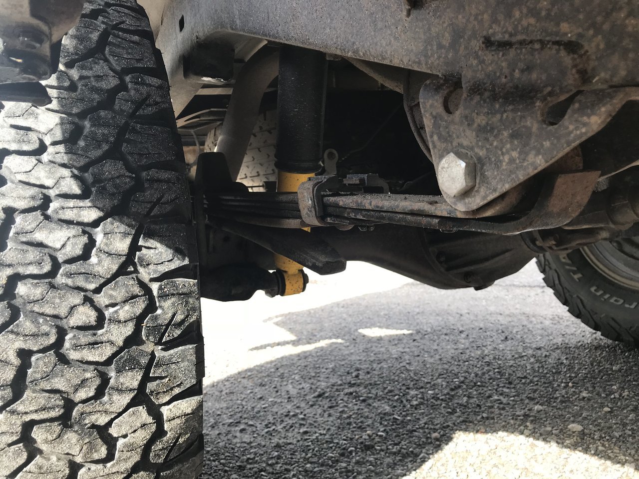

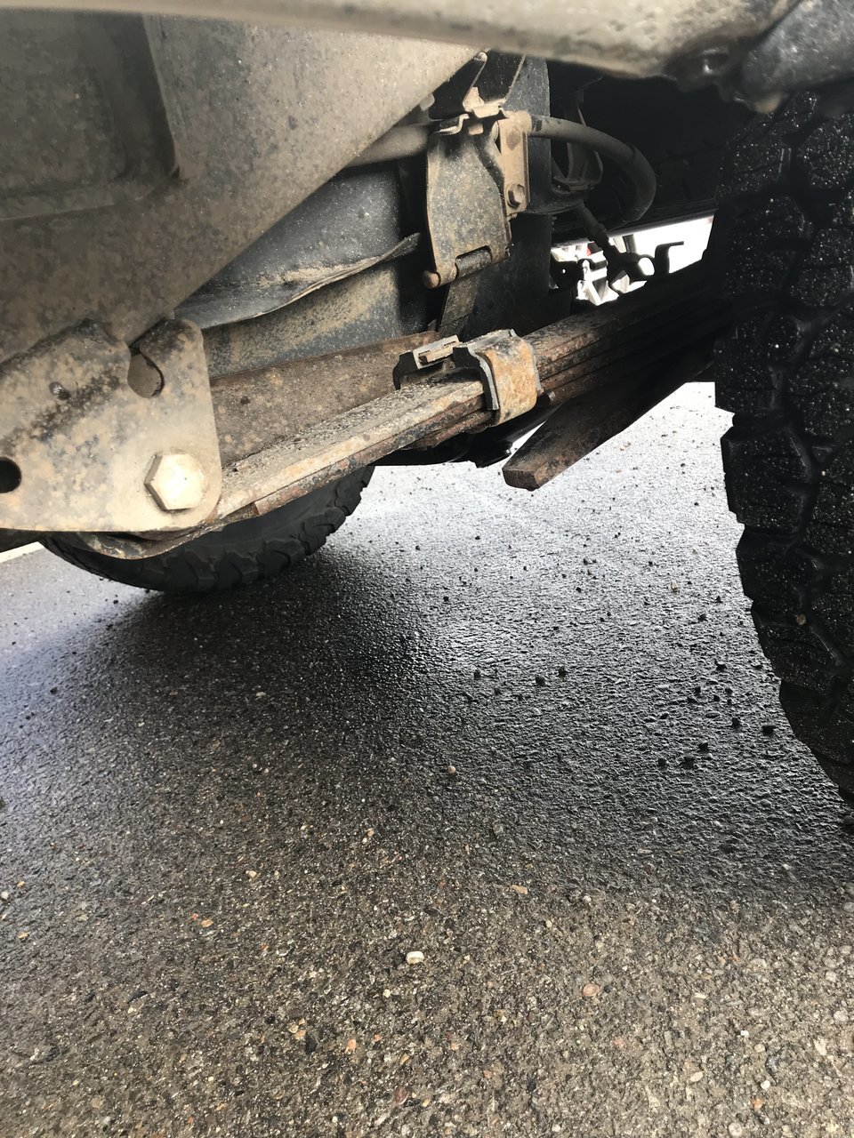

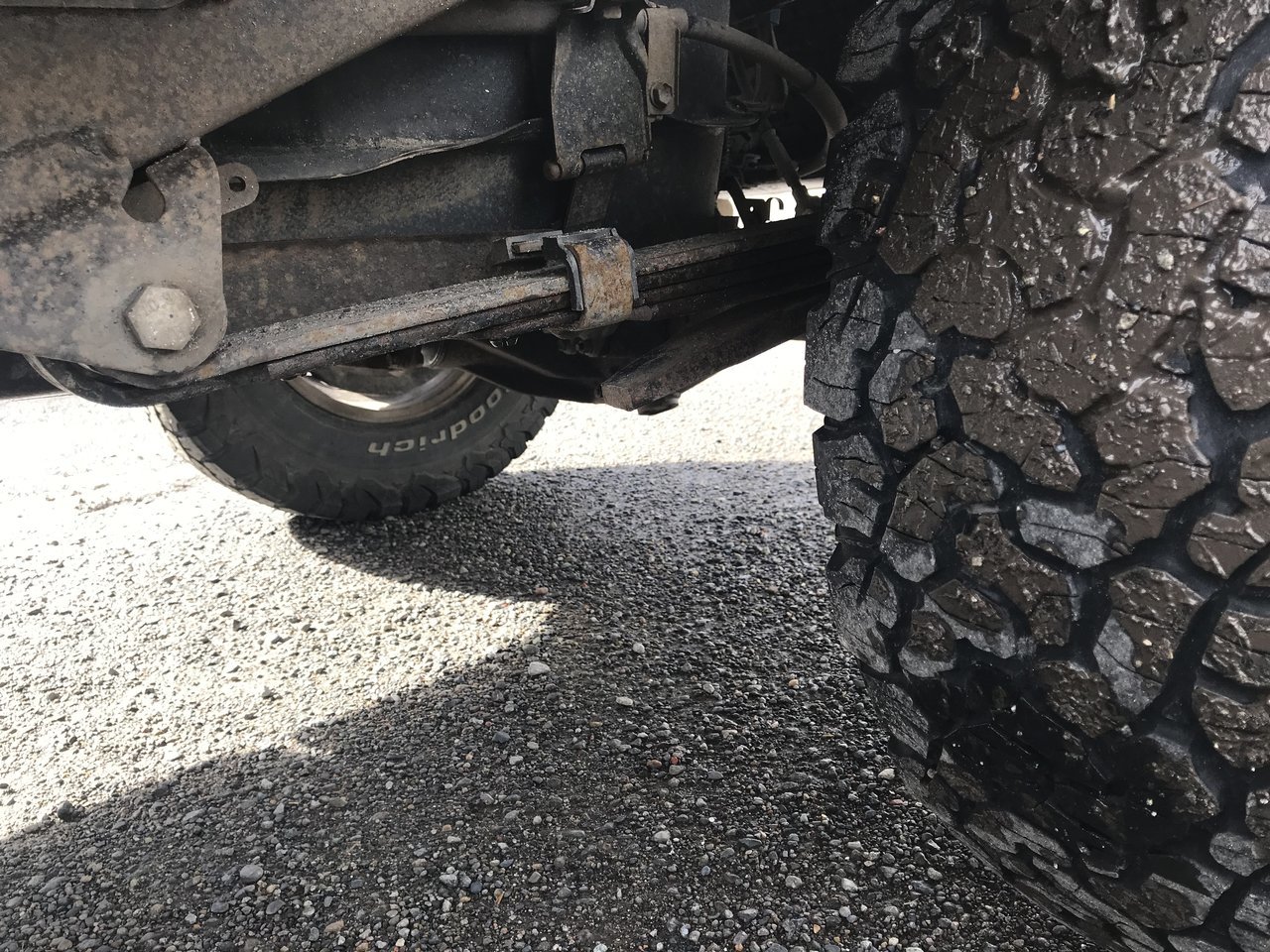

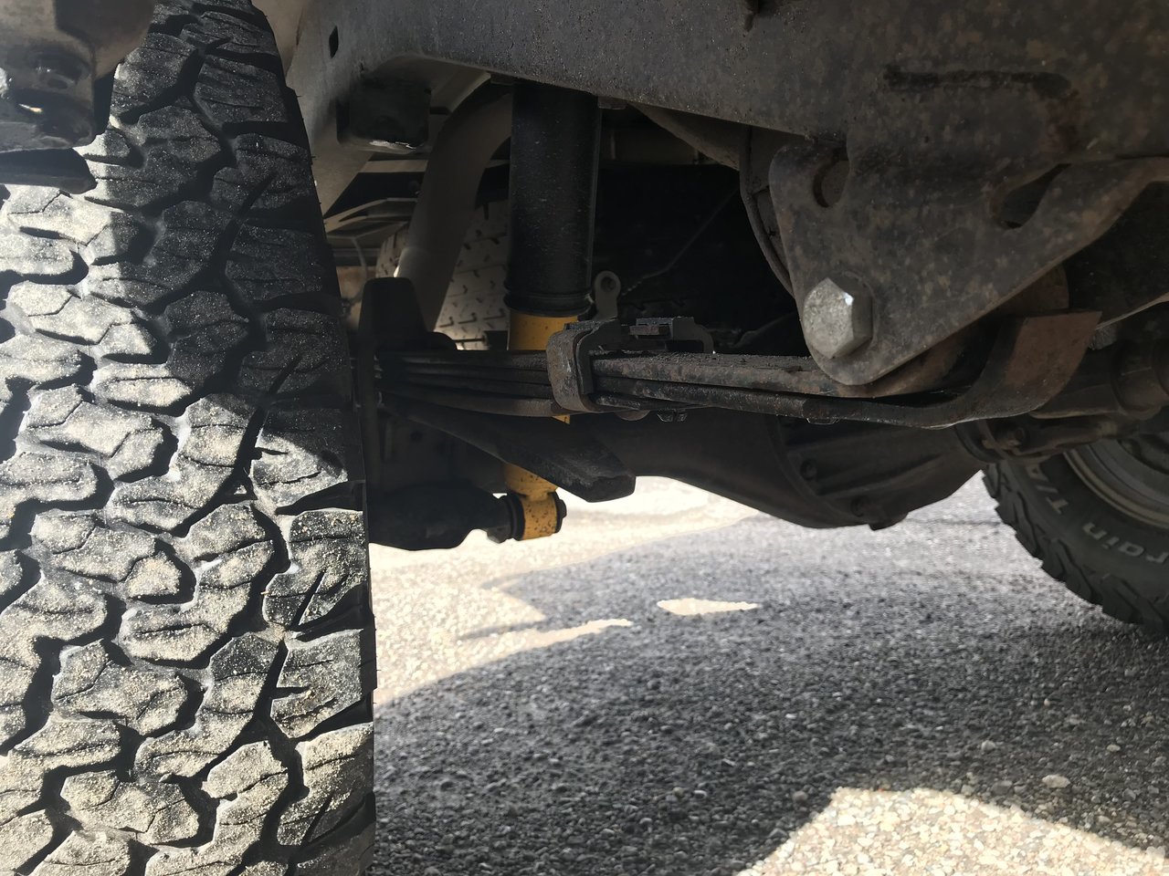

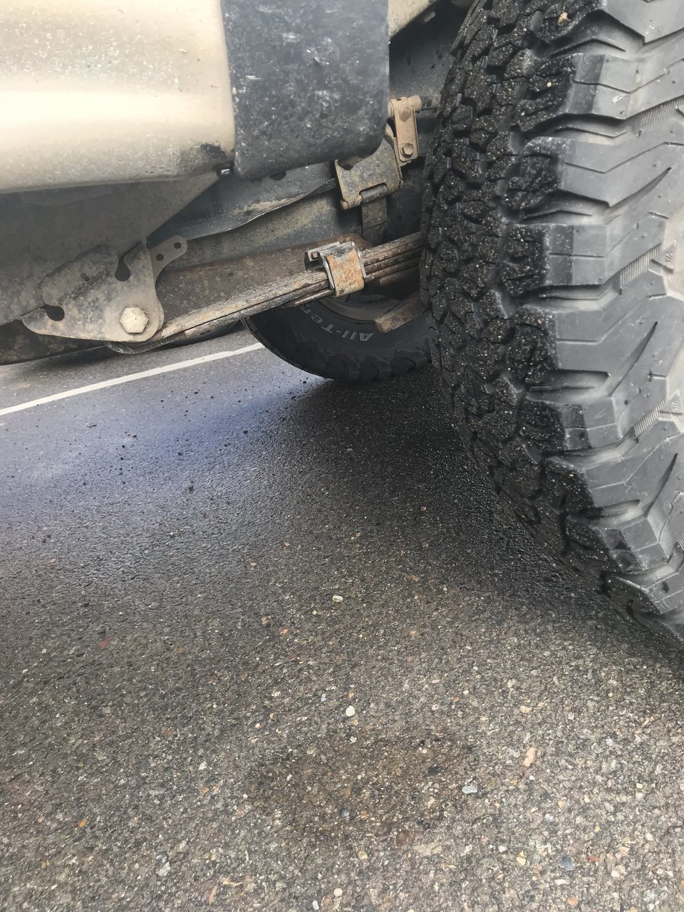

    How about mine...5C7723BF-D491-4EBF-9E2E-AAF3CD92A186.jpg3A340BED-9F71-49CA-9566-15317E4F61CF.jpg 8B8FB0DB-553E-43DA-8819-CDFC63CA43FE.jpg8D871BD6-86A4-428D-97D6-108C9C78D7AD.jpg

    mine look like that. pointed downward is bad, right?

    If my leaf springs looked like that I'd be thrilled.

    Mine looked similar back in 2018. Simple answer is that they should not be pointed downward with nothing in the bed. Rear of spring (under tailgate) should curve upward, and forward of spring should either be flat or ideally slightly curving upward.
    The culprit for mine was that the shocks were "shot", and had been for years. Literally the shocks were not holding any weight whatsoever, and just tubes sliding freely by that point. Excessive, occasional loads of brick, dirt in bed of truck most likely led to it. I wound up replacing leaf springs, coils, and shocks all at the same time. Did it myself over three days, but wasn't easy given I'd never tackled that before in my life. Most annoying part was one of the nuts on one of the front shocks refused to come off, and ultimately it stripped. Had to cut it off, to re-use some metal piece needed for the coils.
    I used one or more of Timmy The Toolman's vids as an ultimate guide.
    https://www.youtube.com/watch?v=0HJx6HH2yno
    I wound up buying a heavy duty spring compressor, cause I didn't want to die, lose a hand, or be puckering for any period of time during the process. This one isn't sold anymore, but it gave me 100% confidence in the most dangerous part of replacing the springs.
    https://www.amazon.com/gp/product/B077XZVJ7W?ie=UTF8
    I went with Old Man Emu components, and Bilstein shocks. Still appear to be in good shape.

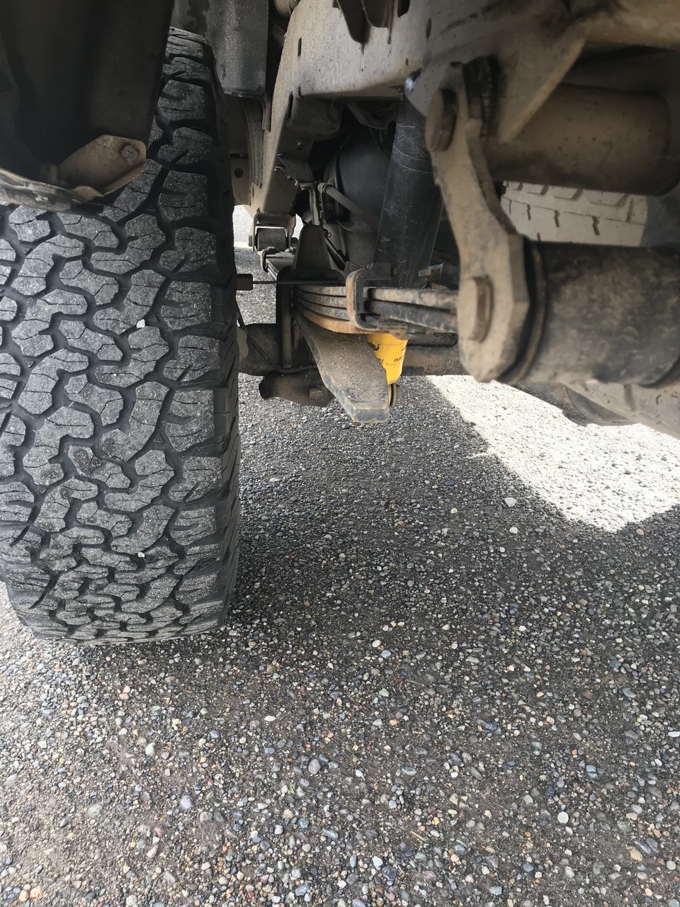

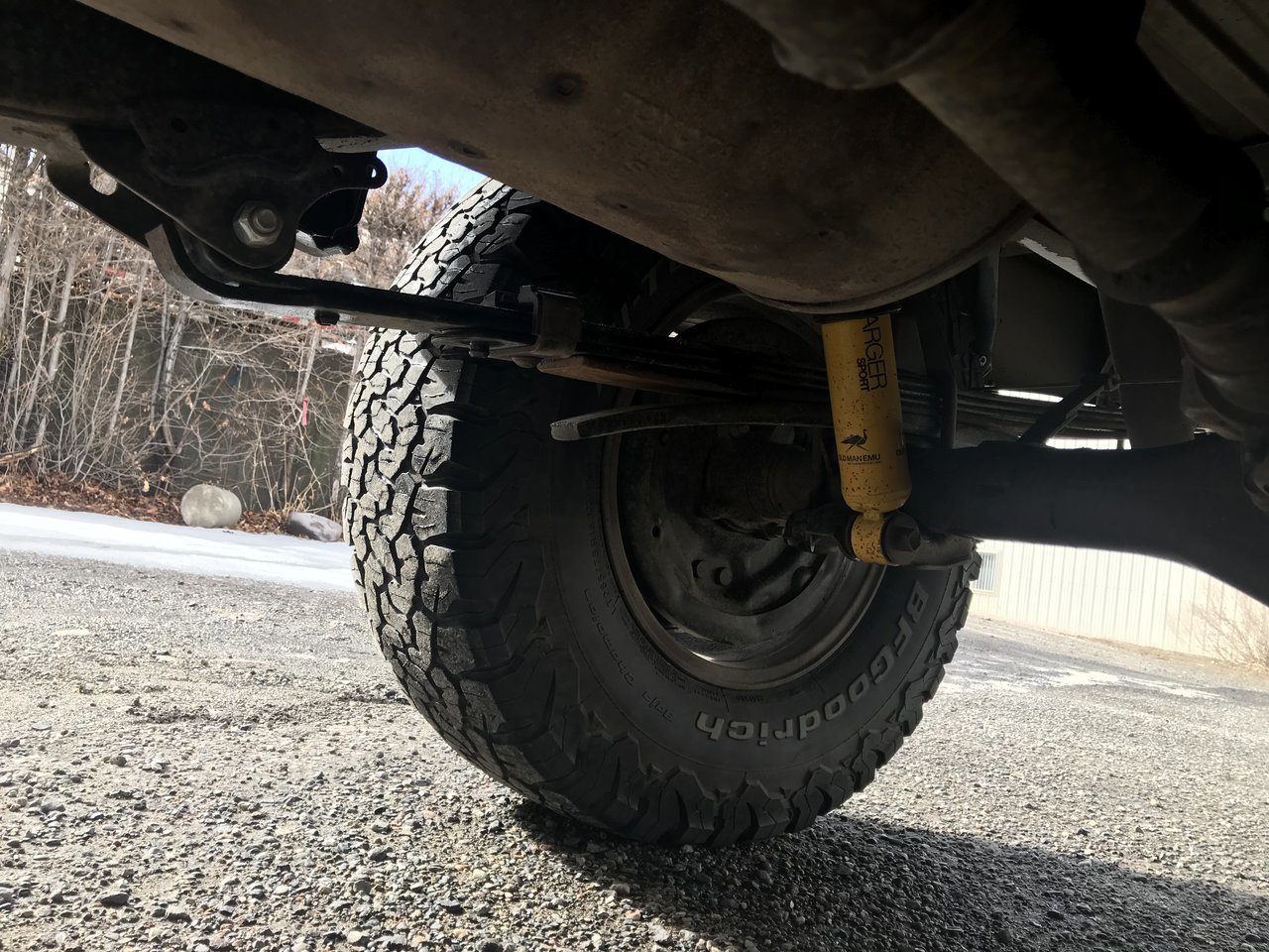

    I got a few things in the back and a MX Series Topper and mine look like this:
    [​IMG][​IMG][​IMG][​IMG][​IMG]
