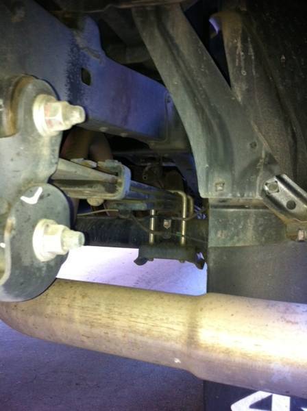

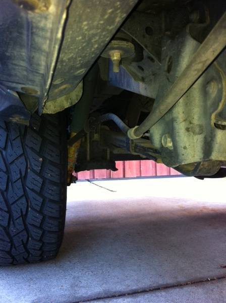

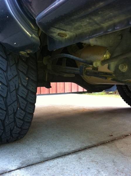

    I have an 09' TRD off road Double Cab with 50,000 miles on it. The previous owner did not have the TSB done so it has the original 3 leaf pack. I was looking at the packs today and it appears as if they have a negative arch. I am going to attempt to see if they will do the TSB out of warranty (I know my chances are slim and none) but when they most likely say no, what would my best option be? AAL or replace the entire pack? I have a topper on the bed and the truck sits pretty level and is even slightly nose high. I was thinking about doing 5100's all the way around with either the AAL or new leaf pack. I don't need the truck to sit level and wouldnt mind the stock look of it being slightly bed high. Thoughts??

    not saying they are shot but.....i would replace them and hey!! mine look worse!!! replacing mine in spring

    AAL would be a waste of time at this point. Get new leaf springs entirely.

    yup, new leaf springs.

    i think your leafs are fine. the reason for the sag is probably the cap. imho.

    All- Pro has a replacement leaf pack that gets good rep here. They are currently on sale - 25% off. I just ordered a pair for my 05' Access 4X4 last night. My original spring pack looks a lot like yours...so I figured an AAL would not be enough to rid me of my sag. They are also making a beefier "expedition" leaf spring pack you might look into w/ a cap on back.

    wow, wonder how they got like that after only 50k? mine doesn't have the TSB done either and with 70k on the clock they look nothing like yours:confused:
