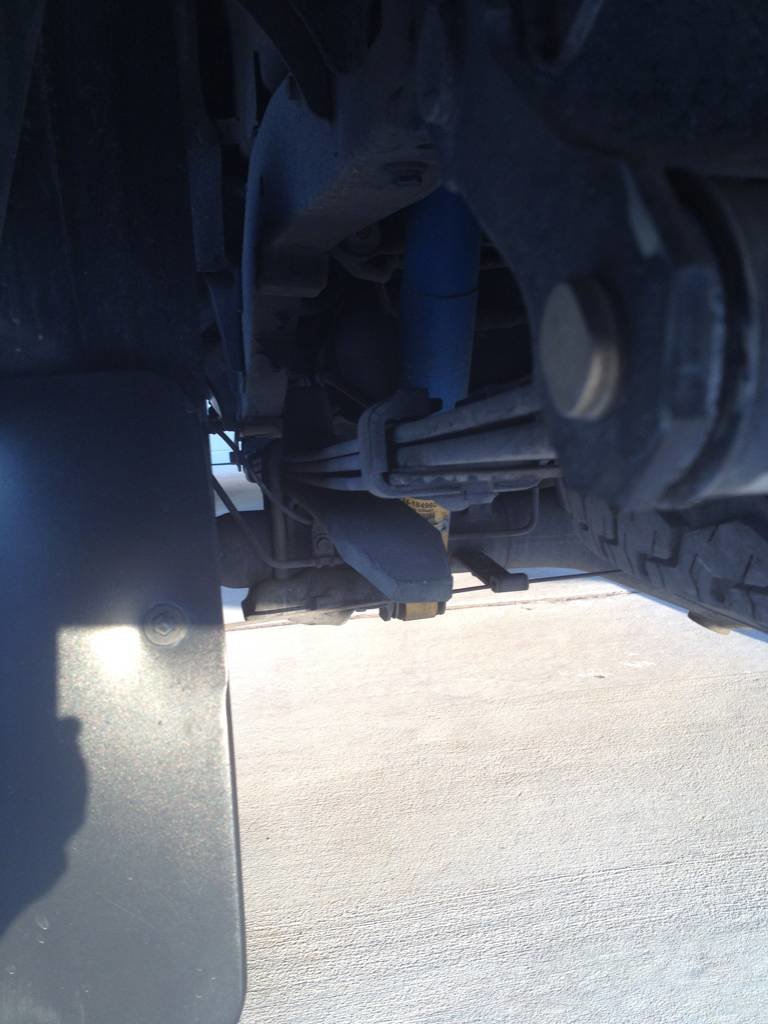

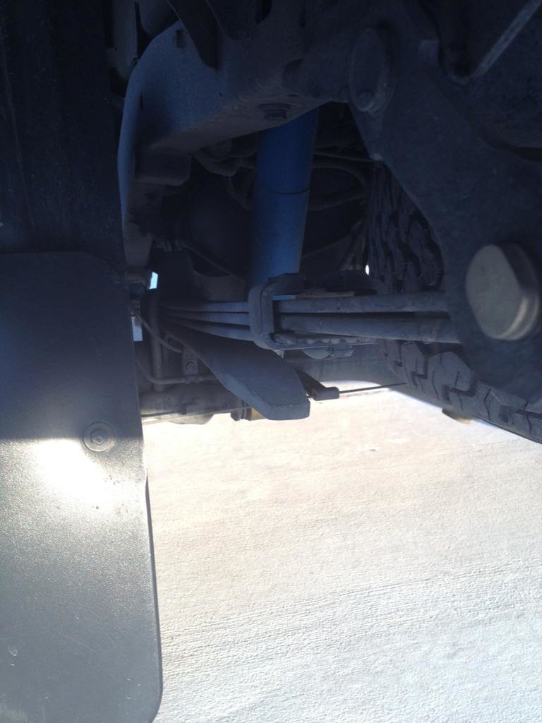

    Here are some pics. adafab9c-05b5-bf61_74814a1cb7a2a284d880ef0d23721ff5ea0ba787.jpgadafab9c-05c0-03a8_32f8e2e2697e04b26e1364ef0ea75164d3a3e442.jpg
    65k on my 2003.

    Look good to me

    Yup looks good. They are still smiling. Unless you want us to talk you into a lift kit. Then we could re-evaluate the situation. :D

    They dont look too bad

    those look fine. you should see mine if you're worried about yours.

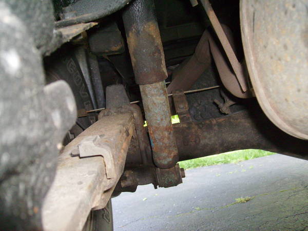

    na they look ok, mayb an AAL if you need a little more out of them
    for reference OP, this is what shot leaves look like :eek::eek:

    That's what mine look like

    They look fine. I wish mine were that happy looking :mad:

    If you dont offroad hard or carry heavy loads they got some life left, when they go to negative ARC, come talk to me.... as far as the squeak could be dirt in between leafs, or might be spring bushings either at the shakle end (rear) or the hanger end (front) don't put any type of heavy lubricant/grease or anything like that on your springs, All it does is attract dirt,etc;....
