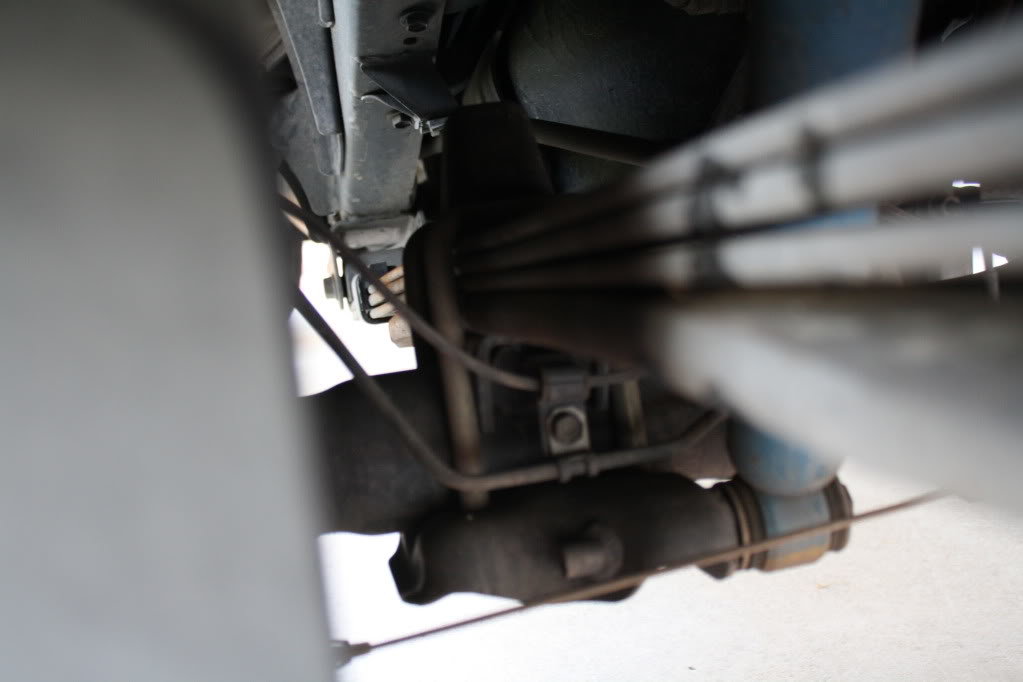

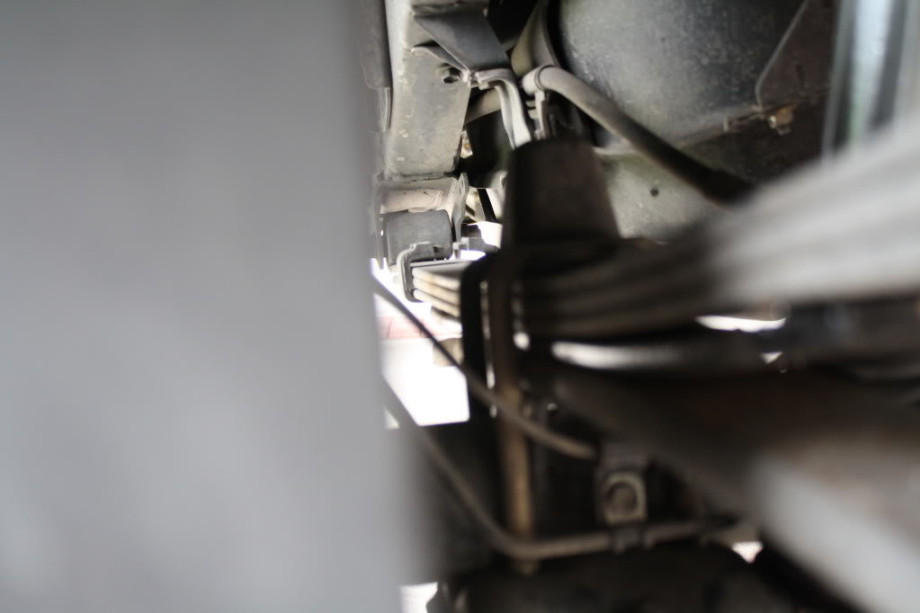

    Mine don't look as bad as yours...But do y'all think mine are shot or are they ok?

    Just keep driving on them until the leafs brake in half. Haha then replace them. There is no point in replacing them now!

    Thinking about putting in a Wheelers 1.5" AAL

    your leafs do look shot, but i got a 2" AAL and my leafs reformed:p

    yours are pretty shot too
