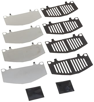

    Not sure if I'm doing my brakes too early; pads are at 6mm or less.
    The pedal bites low; Idk if this is caused by worn rotors. I already turned them on a lathe but haven't measured thickness with a caliper.
    Just ordered new OEM rotors and pads on Amazon, and read people also might use extra parts.
    Are they needed?
    Such as shims and hardware. I honestly don't know what else is in the braking system looking at the Olathe Toyota Parts catalog, but I remember when taking mine apart last time (to cut on a lathe to fix pulsation), there were such parts. I think "shim" backing plates on the pads, and hardware such as slide pins, etc.
    all of which I cleaned and lubed with anti-sieze before re-assembly.
    What are your thoughts?
    I see some posts say that it's best to buy new shim parts because they have a special anti-noise coating that wears off over time, but my brake problem seems more to be "worn low" rather than noise.
    The parts will probably add $20+ extra to the rotors and pads.

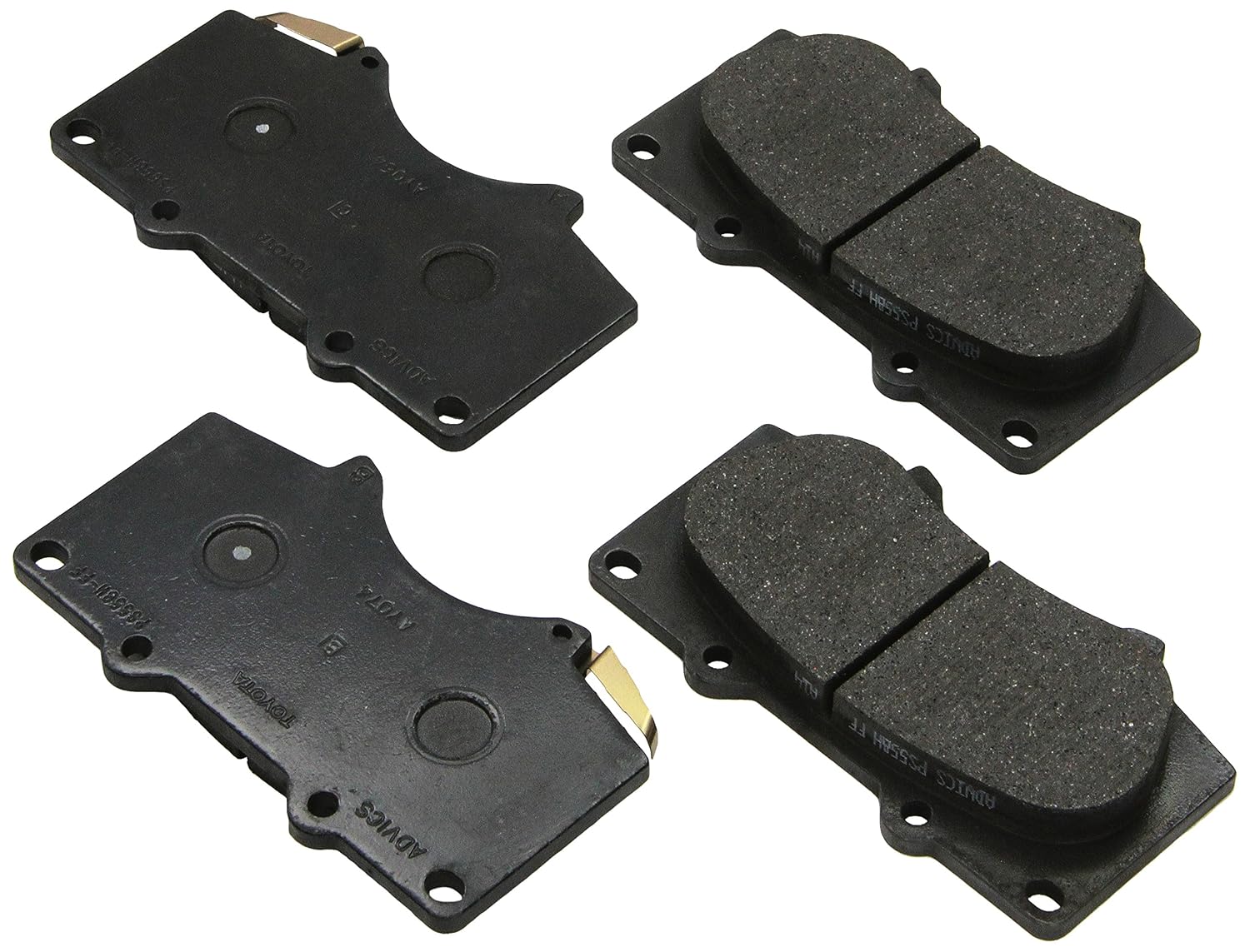

    Something I learned working on my supras, toyota pads come with new anti squeak shims, aftermarket stuff doesn't. Aftermarket pep boys pads didn't even stay where they're supposed to. So even when I switched to brembo rotors and I forget which aftermarket pads, I used Toyota's shims. There's not a coating to wear off, but sometimes the shims may have slipped out of position and got bent. If it's supposed to have shims, you'll wish you got them after listening to the noise.

    Most good aftermarket pads have that built in so no, you don't need to add them. But if you buy pads that look like the pic above, with bare backing plates, then yes you will need them.

    get the shim set.
    I did the oem rotor and pads from camelback toyota ... hit up @gunny1005 (tho he hasnt returned my PM's from a week or two ago... maybe hes on vacation). I wish i had gotten the shim kit as it would of saved alot of time n hassle from cleaning up the old ones.

    Yes, add the shims with Toyota pads.
    If you want to listen to squeaky reverse morning brakes for years, then by all means don't use shims. Ask me how I know. I've done it both ways and one way is just plain wrong.

    New hardware is not always necessary, but it is cheap insurance. I always do the new hardware and use the ceramic grease, you don't need to go crazy with it.

    I agree...went to the dealer here and said I could just reuse the shims if I was sticking with OEM pads....if you do switch to aftermarket don't throw out the shims they are worth $40.00 and a good idea to keep.
