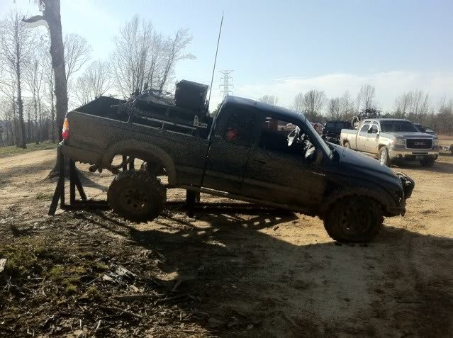

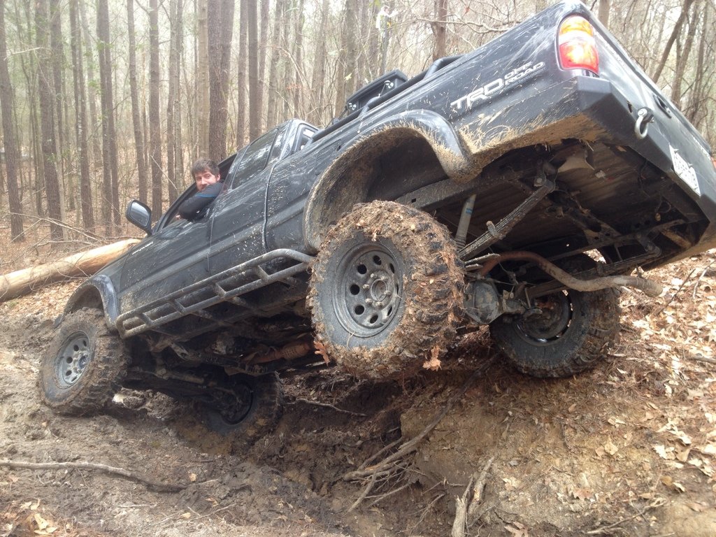

    Everytime I plan to actually wheel mine, I lock the rear end. 2wd/4wd, it doesn't matter. I have never had it turned on and said "if only the rear end wouldn't have been locked".
    You can't do this without the locker.
    88AFD7DB-DA72-4B0D-AABE-DCE9DDF08FF7-270_3bd41edf242e38eb876157b45518c9e0140c1586.jpg
    Or probably even this.

    So just to clarify, with open/open diffs does power go to the tire with the least resistance on each axle? Or just the one tire with least resistance?

    With an open diff, the power will transfer to the tire with least resistance. So in the pictures above, the tire in the air would normally be free spinning, while the tire on the other side of the axle would have no power at all. So essentially our 4x4 trucks are really only 2wd in certain situations. But with a locked rear you will always have at least 3 tires with power.
