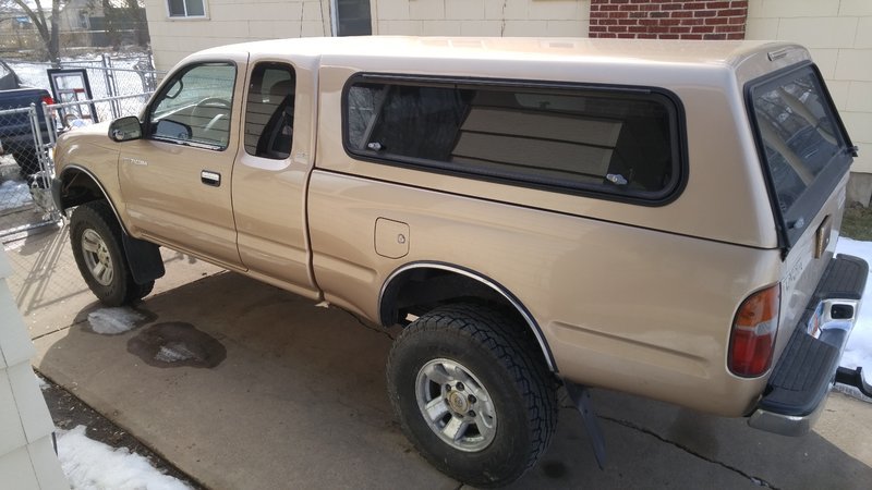

    Well got the rear end installed and it went from 35 1/2" to 38 1/2"s ouch hope it settles a bitmage000000_4.jpg

    Looks great! Toss two sandbags back there, and they'll settle in no time.

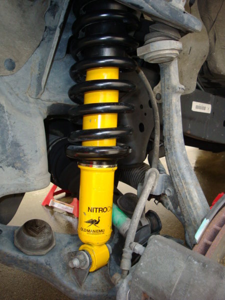

    Solid. I started with 881s when I had a stock bumper, but when I built my CBI, I upgraded to 883s. Another difference, I've got OME Nitrocharger Sport shocks, not billies.

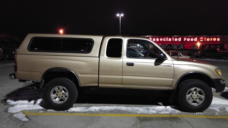

    20160203_003445.jpg just a different picture so you can compare to the other photo I posted,this is with the dakars and the brake line and the exhaust hanger, going to order the brake valve thingy now.. Made new appointment for next week to get the one 881s installed as they will be here Friday... Thanks again

    Yes, do it now. Battery, driver, and gas tank all on driver side. Watch your rear brake lines. Did you get an extended line? The stock on can max out and be strained at full droop. Also, get that BPV bracket on ASAP. Otherwise, the brake system will send more pressure to the fronts, which will wear them out much more quickly and could potentially lead to warped rotors because they are doing all the stopping work.
    These are Dakars.
    BPV bracket and extended brake line (hard to see, but it is red and up above the left side of axle).
    trim packer goes at the bottom of the coil seat (see gold ring), so it is a PITA to add later; you'd have to remove and disassemble the entire coilover.

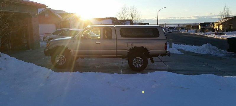

    I'll have to get a better photo later on as I have to run to work but the front end lifted almost 4 inches compared to before and I'm a little scared as it sits at 39.75" and before was like 36" . I sure hope it settles later on.....
