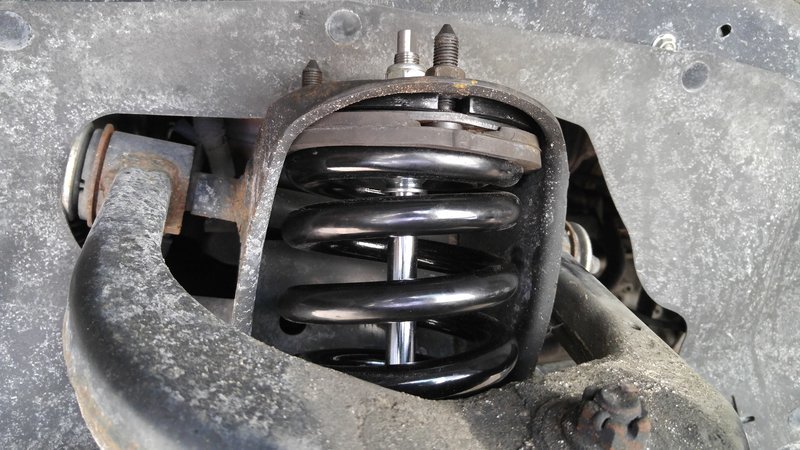

    No, that is a lift enhancer that does go at the top, probably 10 MM though, which is twice as mush as the 5mm trim packer. Each of these products is different and can only fit in one location.

    this is what dan said i needed to fix taco lean so i hope he was right. i also have the 5100s in front not ome shocks.set at lowest setting.. tyvm for providing the links though.... how much do they settle about? 1/2 inch or so?

    Oh yeah, OK, you can 't use the 5mm on those, they only work on OME, so the top version he recommended is your only choice with Bilsteins.

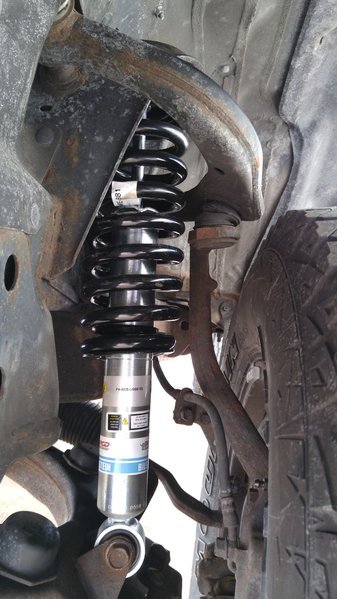

    Are you sure the bilsteins are set to 0? I've been doing a ton of reading on the 881 and 5100 combo and I've never seen anyone get over 3" even when first installed.

    That's a good question I will have to go look in the morning as I never looked at that and that could be what's wrong! I told the guy to put them at the bottom but I never checked to see if he did just figured he did is all...ty

    I think your right he didn't move them it looks like, god I hope I don't have to pay again to get them.moved down!

    I've had them on for since yesterday and have not drove truck maybe a mile as I didn't have the money to replace the inner tie rod til payday. According to that picture I posted are they installed at 0 like it suppose to be or on number 1 so they provide a lift? I told him to move it to bottom and looks like he didn't..but who knows I will go look more here in a few minutes.

    cool talked to steven at wheelers and he said they are on the 1 lift spot and need to be moved to the lower one so i called the shop and the will fix for free tomorrow morning....
