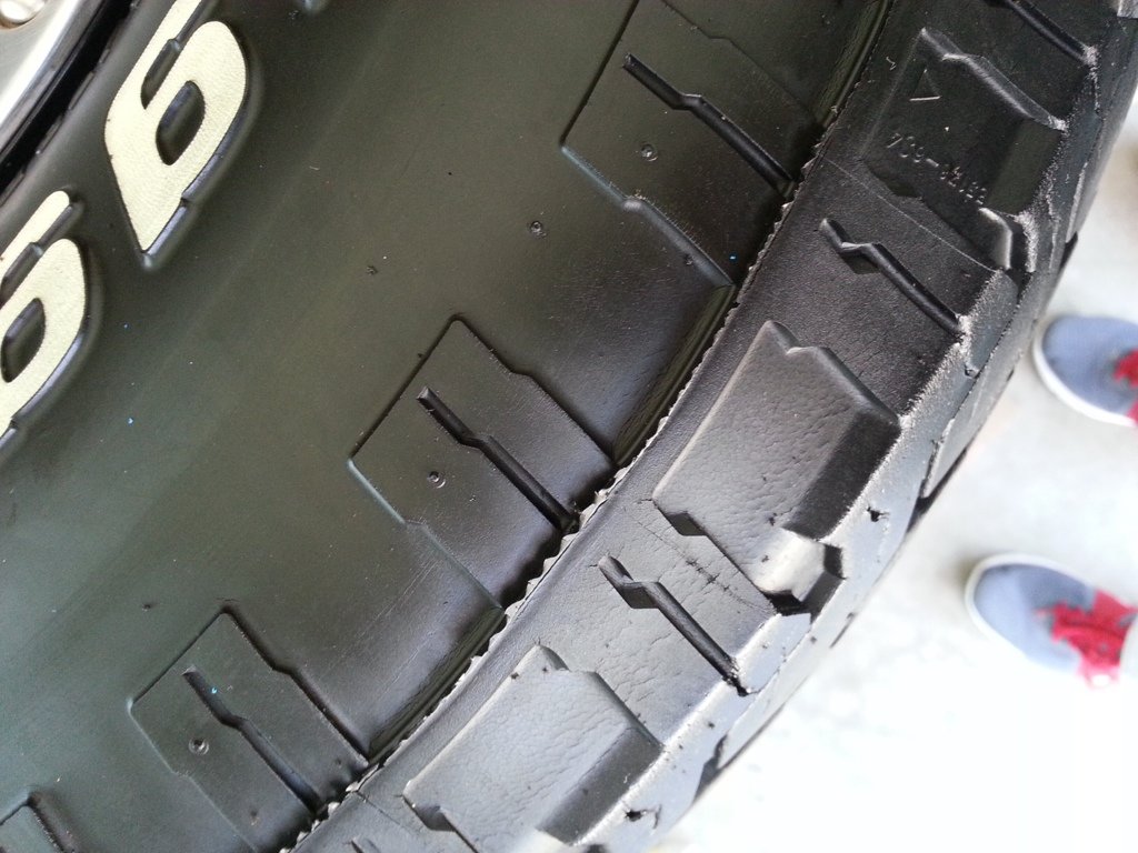

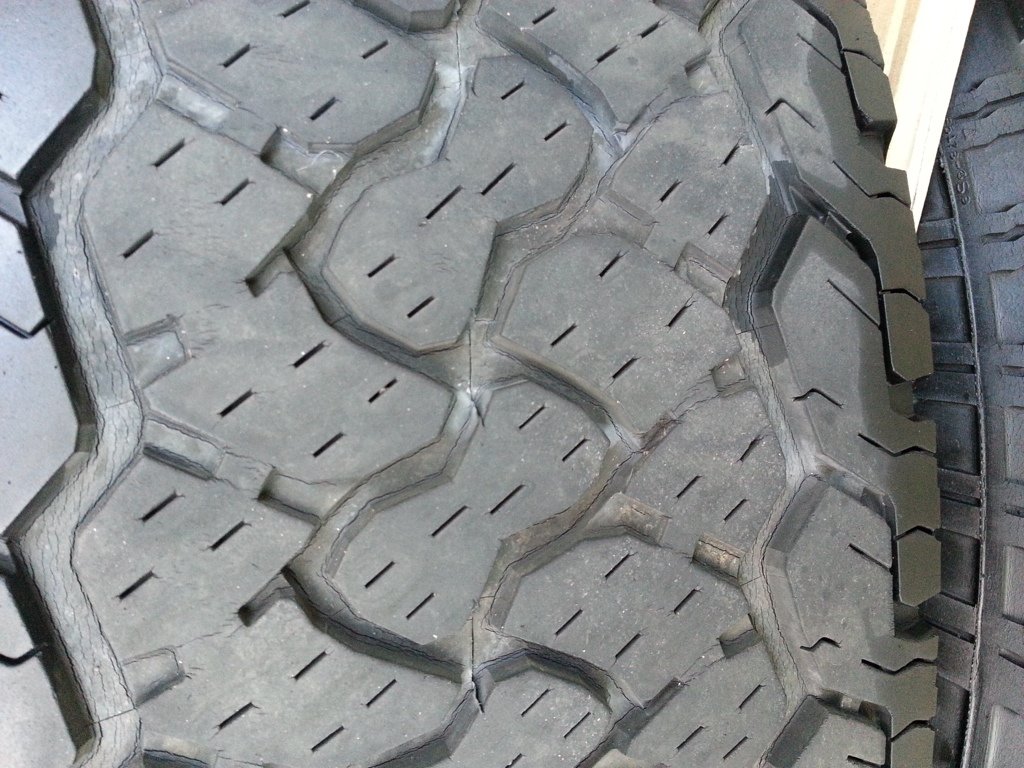

    BFG Rugged Trails tires, that came on a set of wheels I purchased. Tires have cracks on the tread area. The sidewalls look ok. I treated the sidewalls with 303 Aerospace Protectant. The tire date on the sidewall indicate it was made in 2010. Can I drive on these for a few months until I get some new tires? What are your thoughts.

    I'd say they're drivable... If it's a 2010 tire it should be ok. Ive seen much worse cracking than that... I'd look into getting a new set for sure but you will be ok for now. As long as there aren't any signs of tread separation or sidewall damage.

    I have a set that are doing the same thing, but are newer. It's really early for dry rot on the tires I have. Took it to Discount tire to show them, they said it's dry rot but may not be bad enough for replacement. Have a shop look at them.

    I thought this was pretty bad in my eyes, but I can't imagine driving on something much worse :eek: .

    Tread cracking is commonly related to ozone interaction with rubber. All tires will develop some cracking as they age. Depending on the severity of the cracking, it may only be a cosmetic issue that does not affect tire performance or safety. Cosmetic ozone or weather cracking in the tread is not covered under the limited warranty.

    My generals are the same way. If your sidewalls are not cracked don't worry

    Yea, looks like im going to just run them and get new ones before winter.
