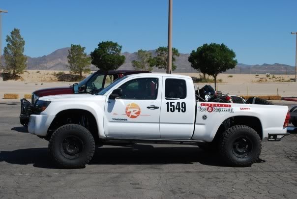

    will 305/70r16 fit on a taco with a 4 inch lift
  9. Dec 15, 2011 at 7:15 AM
    Joeymgd78
    Joeymgd78 [OP] Well-Known Member
    Dec 8, 2011
    #68382
    450
    Joey
    at the moment Afghanistan
    2008 Tacoma SR5 TRD Offroad 4.0 V6 Double Cab
    what about 35/12.50-16lt
  10. Dec 15, 2011 at 7:18 AM
    mjp2
    mjp2 Living vicariously through myself Moderator
    Feb 16, 2007
    #924
    19,744
    Milton Juevos Portimous II
    NJ
    '06 TRD Access Cab, v6, 6-speed
    Scaffolding and a painted grill
    That's a wide tire. You'll be rubbing your body mounts unless you chop 'em.
    That's the size I run on my truck with the LT kit and fiberglass.

    what is the biggest tire i can put on a tacoma with lets say a 3 inch lift with out cutting

    35x12.50R-18LT will this work

    You're talking about some tall tires. You're gonna have to trim stuff and chop the cab mounts to make any of that fit. You'll also want to regear your truck because your power and mileage are gonna drop more than you can imagine.

    not even close. you have to be 32 or smaller, you might even still rub then

    damn so i should stay with the 265/70/17 ssr superswampers with a 3" lift then huh??

    will this work or is it too wide sorry for all the questions im just trying to buy tires online right now and i cant find any 285's that i like

    He said without cutting though, so 265's is correct.
