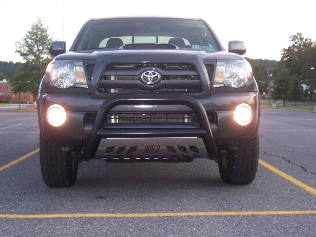

    Here's the outside shot of the bracket/bar...
    Here's the inside of the bracket/bar
    Hope that helps!

    Installed the bull bar this afternoon all by my lonesome. The pix helped out immensely. The install took about 2.5 hours because trying to re-tighten those 2 bumper bolts on each side is a royal pain in the ass with the less than 3 inch space. But it looks good! Thanks again!

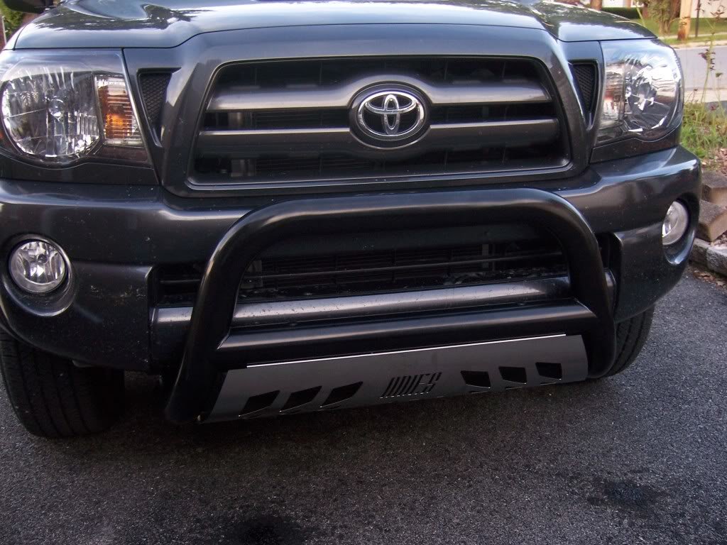

    Finally got them off today. Loaded them up with WD-40 then finally found a position to lay under there where I could grab onto the frame to get some leverage and got them loose. Excuse how dirty the front of the truck is right now.
