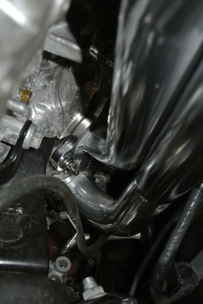

    These are ARP exhaust studs from www.Dezod.com, in the second set of pics. They will replace the cheap factory ones, that are prone to rusting, and stripping out because of their soft nature.
    Here is a pic for those that are quite sure what I am talking about.
    Here is the direct link to their website. http://www.dezod.com/pd_dezod_motorsports_competition_spec_exhaust.cfm
    Just want to let people know about these, as they are a worthy upgrade. :thumbsup:
    Important note***
    Would like to make a note about the install of these studs, on all '05+ 1GR's.
    Recently I found out something of interesting importance. The heads on the '03-'04 1GR, have holes for the studs which can be easily finger tightened. As they should be.
    However, on the '05+ heads, the holes are of a tighter tolerance. Upon inspection of studs from both year models next to each other, they were the same size. It seems that the heads of the '05+ were either heated before the studs were installed, or the studs were chilled, to make the fit extremely tight, once the head and the studs were of the same temperature.
    So, in order to properly install these into the '05+ heads, a tap with the dimensions of 8mm x 1.25 pitch, with some grease added into the grooves, is necessary to properly install these without fault or problem.

    Looks like your header gaskets are black or is that black sealant? My ARP studs have arrived and getting ready to install mine.

    Those are actually pictures of a friend's truck. Those gaskets are the ones that came with his JBA long tubes.
    I still have the factory steel gaskets.

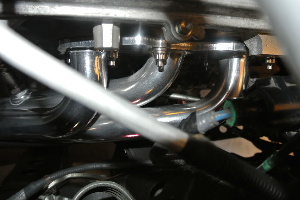

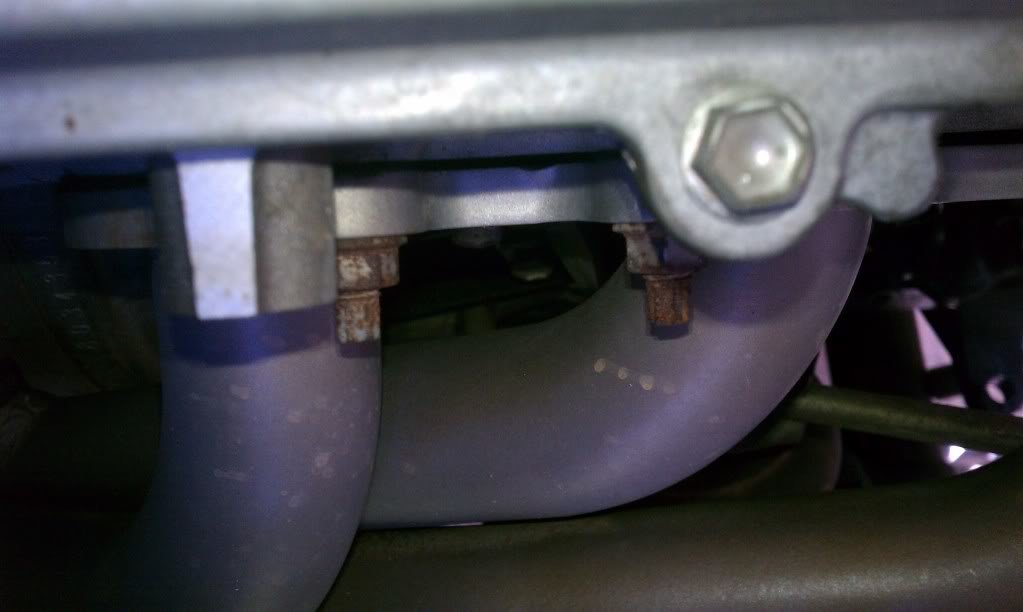

    ARP header studs installed. Another member did these, and I am just sharing, since I cannot install mine yet. Man are they sexy though.
    Especially compared to the super soft and rusted up ones below.

    Some them down with some PB Blast. I hope the nuts come off without stripping. Had to help my friend take his header off one day. The factory never put any anti-seize on the studs. Ended up having to dremel the nut off because its edges stripped out. Fail.

    I have done all the hi-pro mods for a life time, since I got this truck at a great price, I will be happy with showroom new.
    I try to tell everyone that wants to do headers to get these!! if you don't want to spent the money on these then you dont need to buy headers.
    worth there weight in diamonds.
    also get a racing or metal exhust gasket, not just oem one, more stress and they could fail, the metal ones will last.
    and never, never reuse the oem parts. for this...
