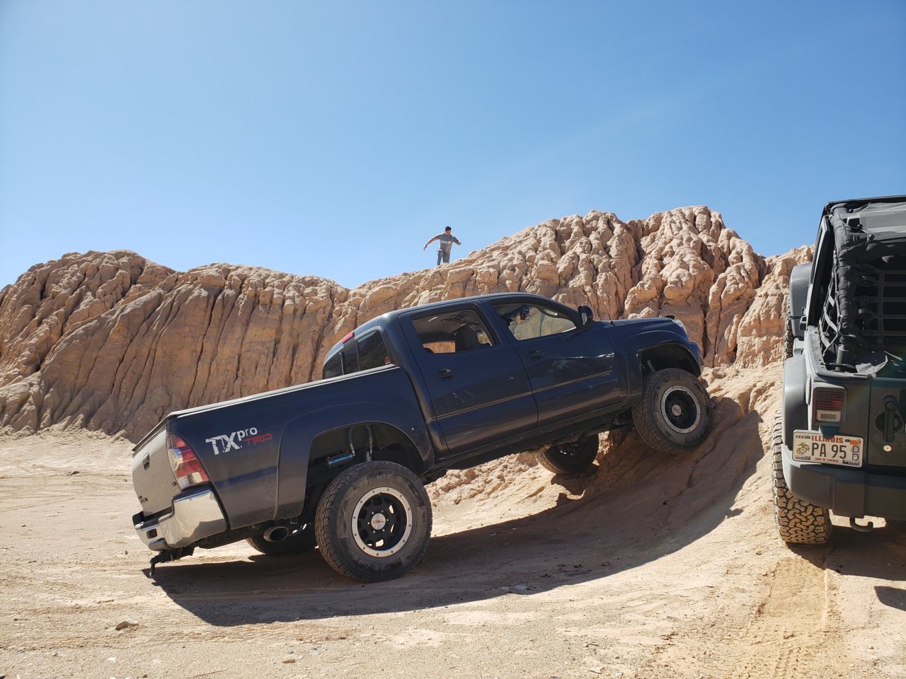

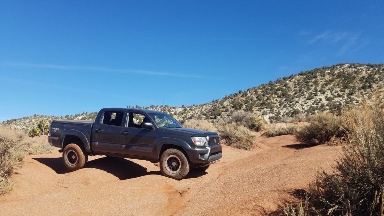

    So naturally within my first month of ownership, I went wheeling with her!
    If you look close, you can still see the temp tags on her... :rofl::rofl:

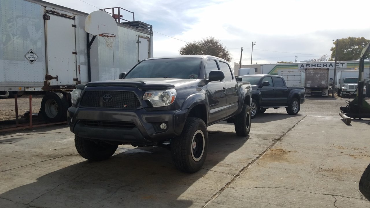

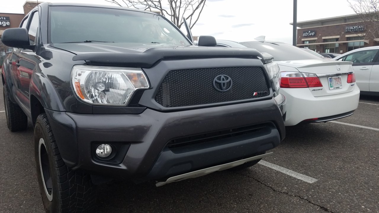

    Chrome absolutely had to go first, but the BPF grill needed some more flare so this is what I came up with. Was able to paint and reuse the factory Toyota emblem, and add the TRD emblem off Amazon

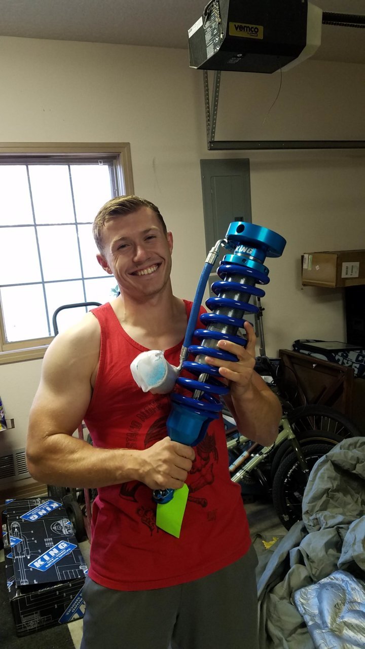

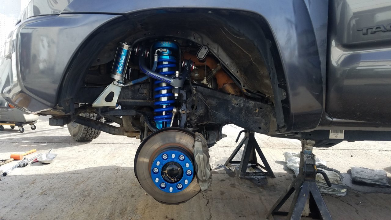

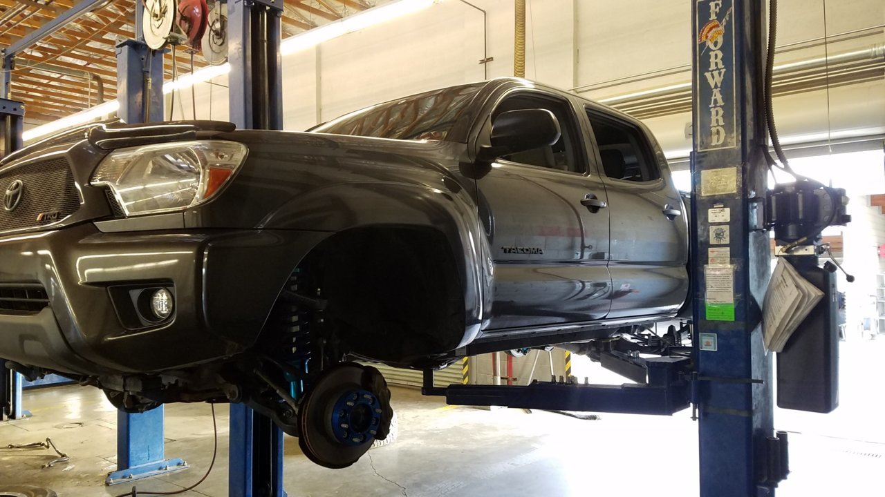

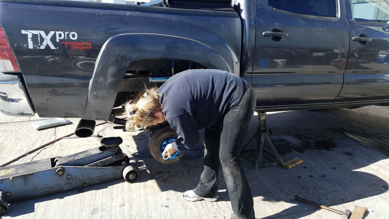

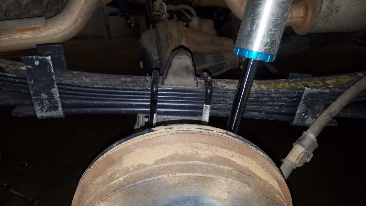

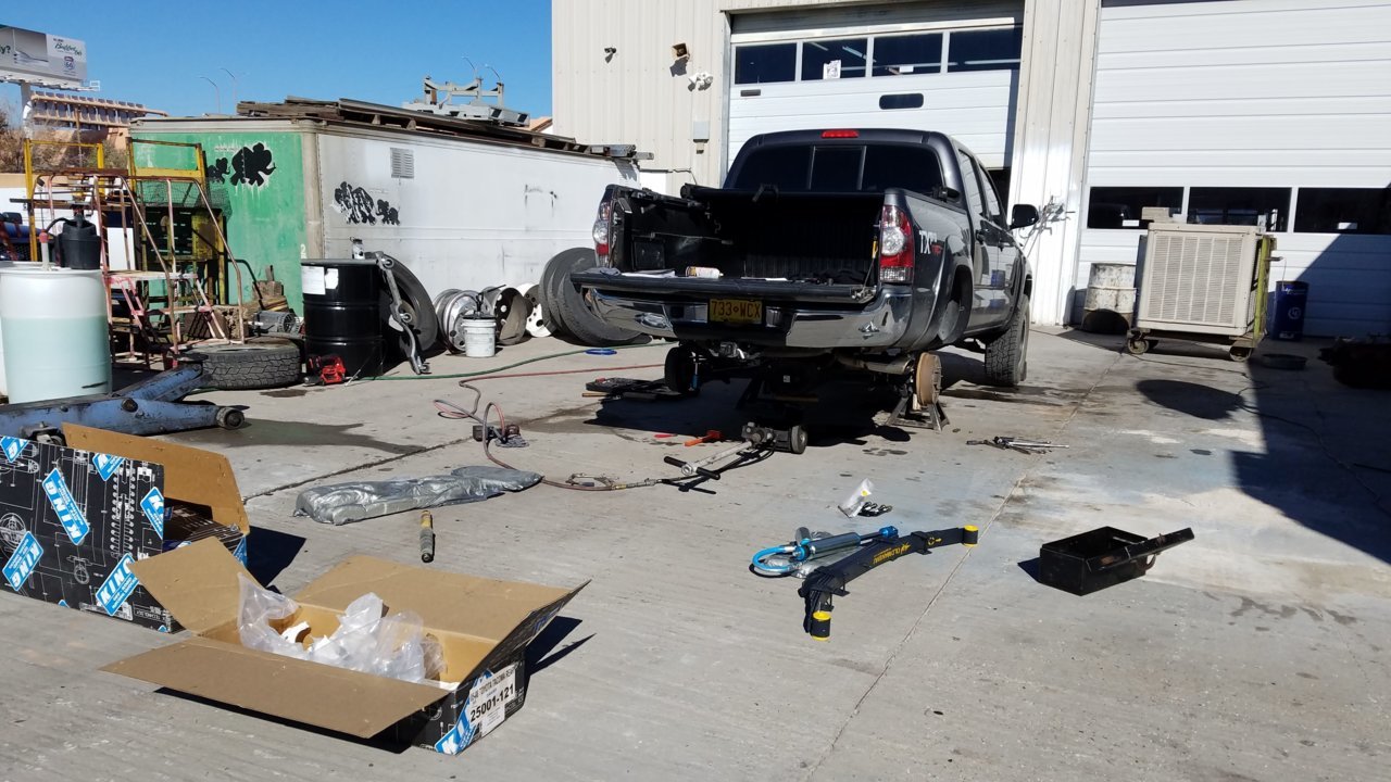

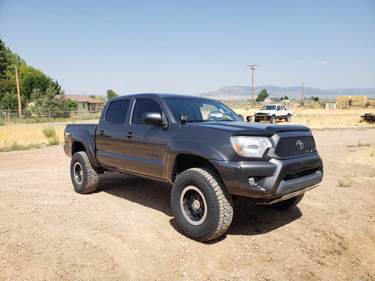

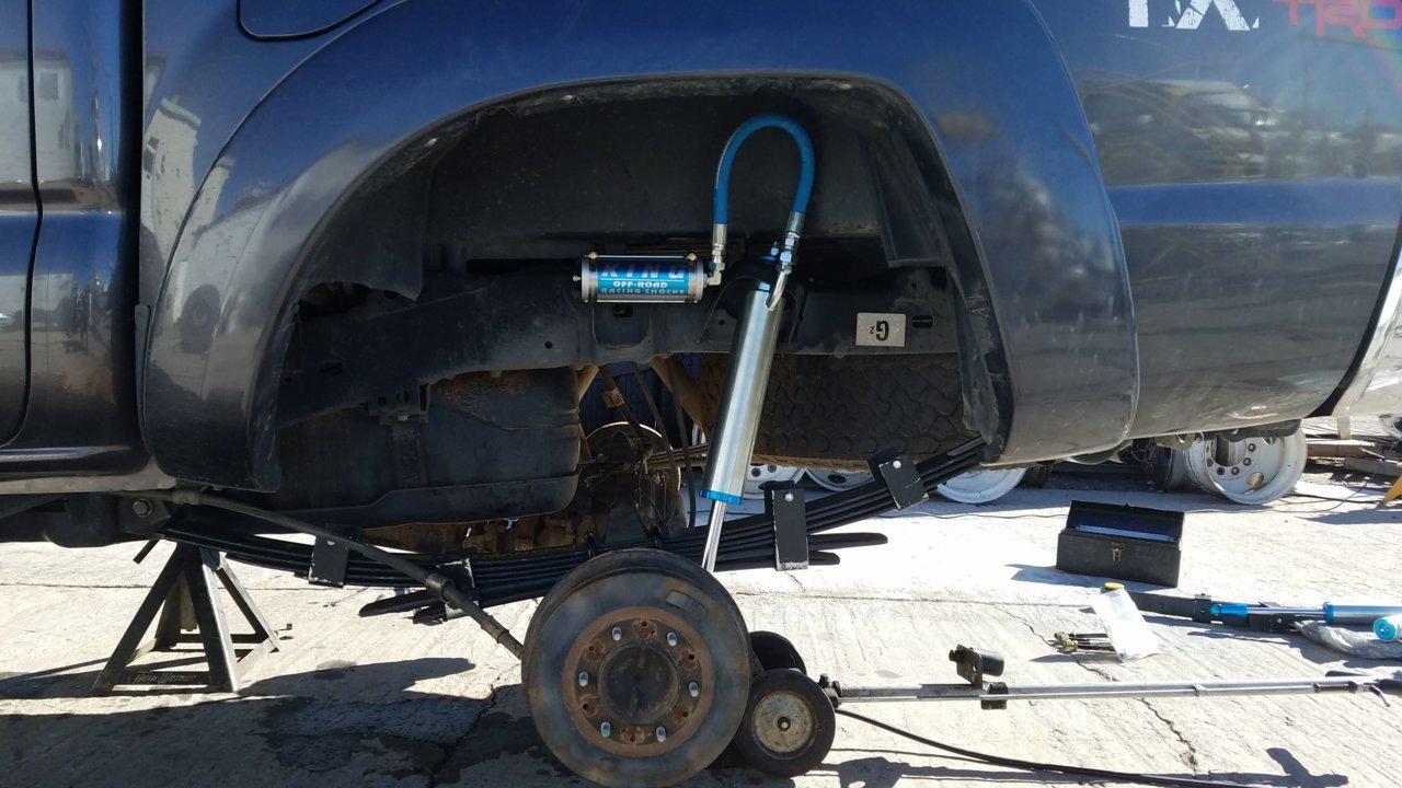

    Didn't take long before I had to find the time to put them on. Took about a 18 hours in total with just myself and, of course mom wanted to help out too. She killed it and made it so much easier to have a second set of hands. Those UCA's were a PITA to put in!! :annoyed:
    Finished product

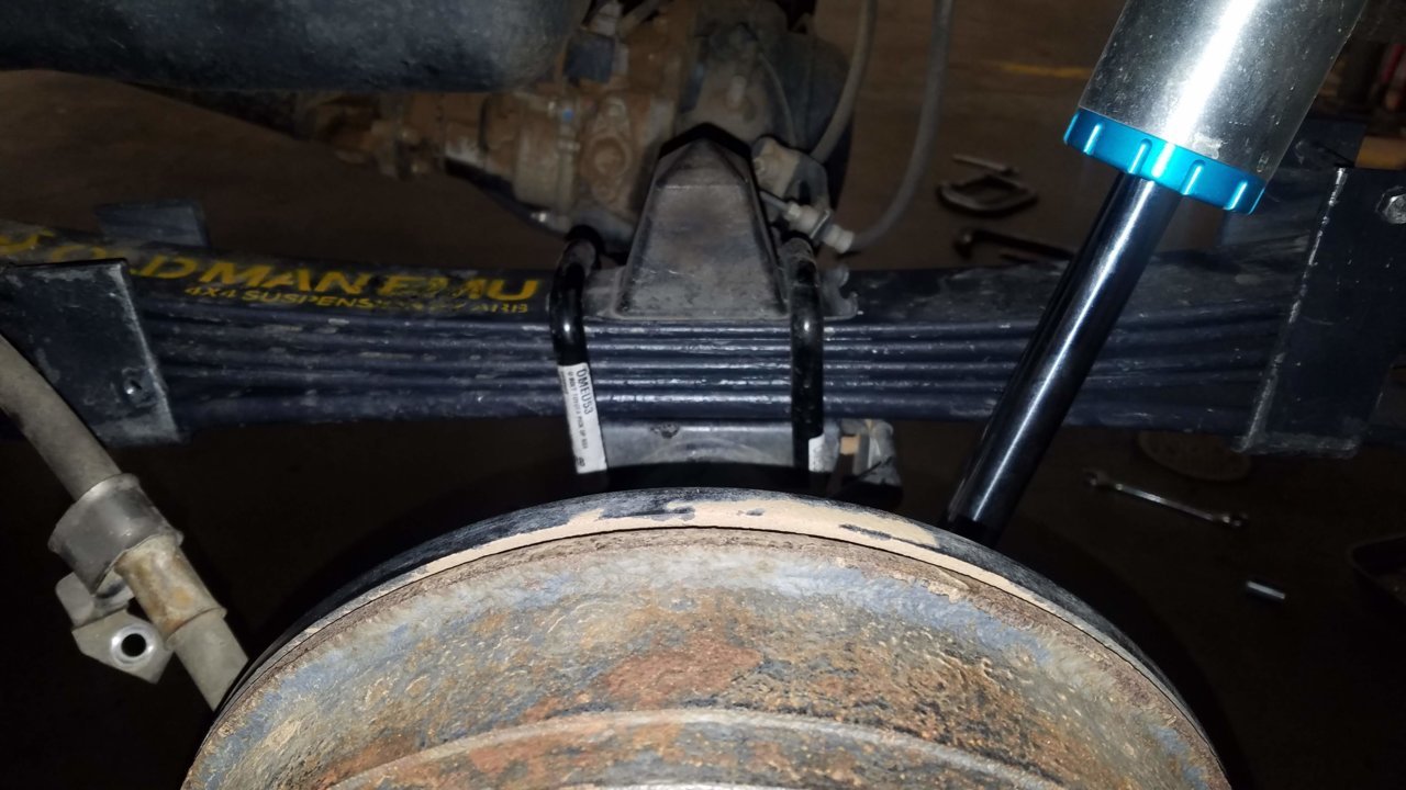

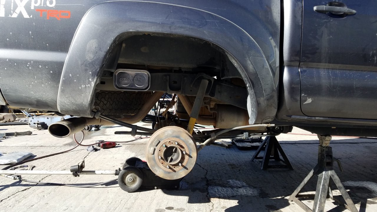

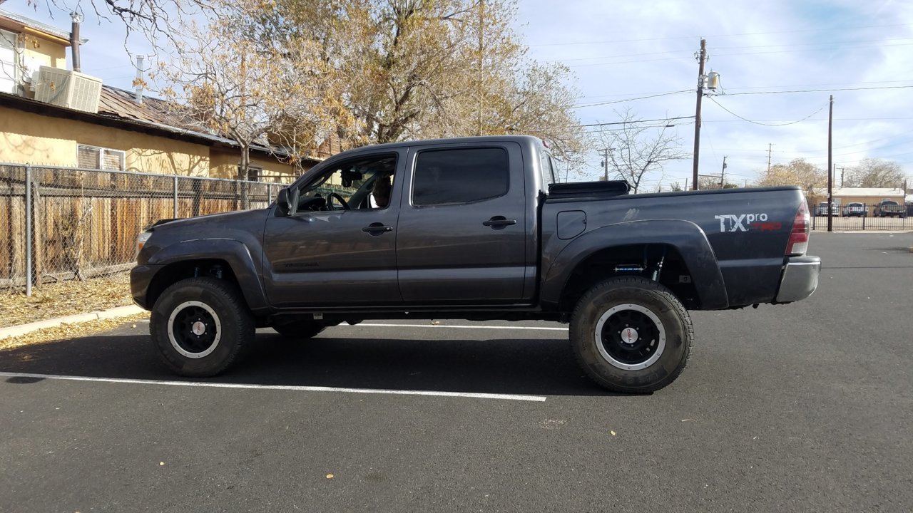

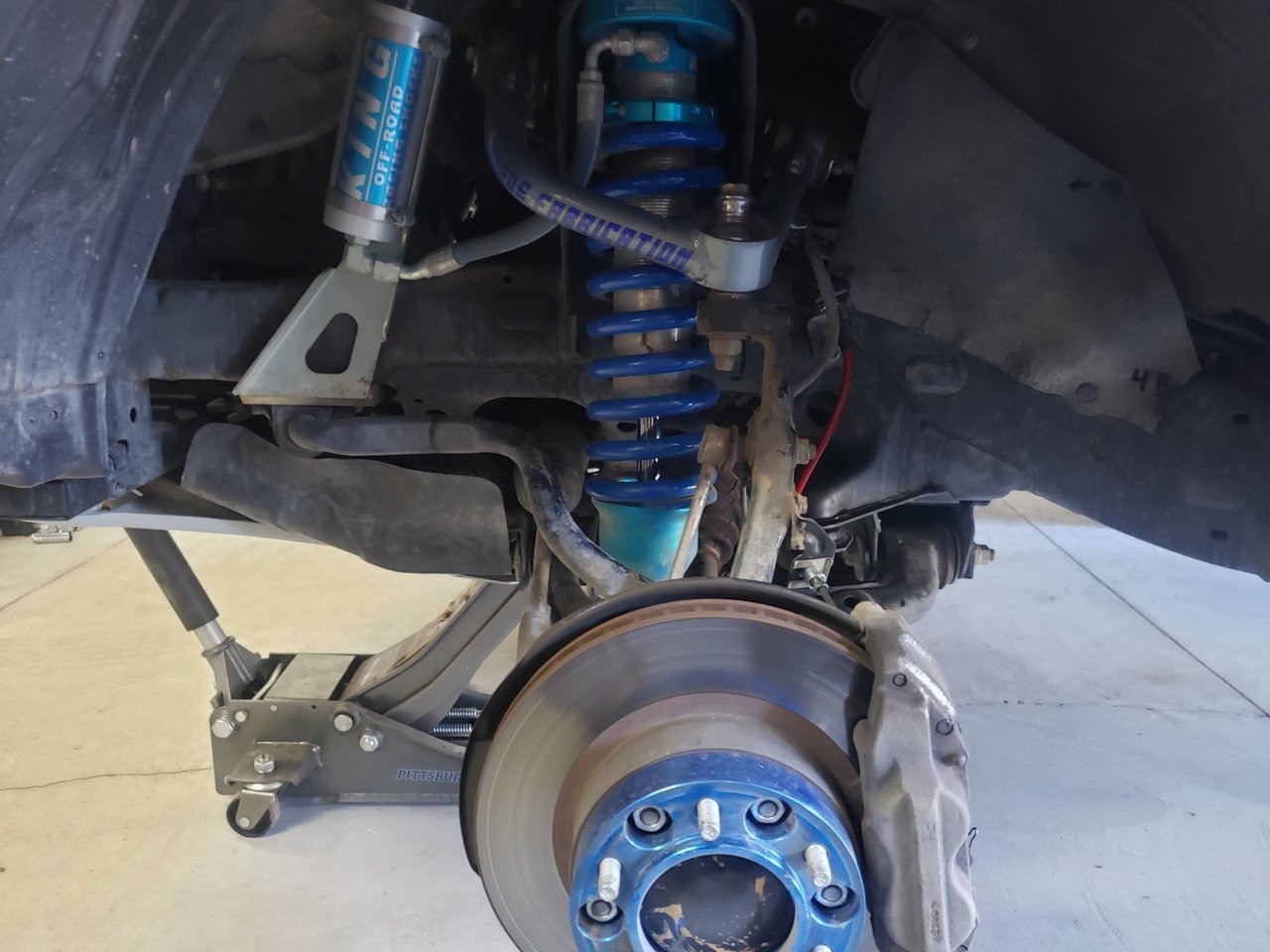

    About a week after installing the suspension I noticed a significant decrease in height the front as it settled and the rear decided it wasn't going to budge. So I threw her up on the local self serve lift on base and raised the coil overs up about 3/4 of an inch. I also decided to ditch the 1/2 inch overload leaf in the rear since I wont be loading it more than a few hundred pounds for short periods of time.
    Before removing the overload
    After
    A side shot of the rig in JT national park after adjusting it. Leveling it out made a huge difference, and the rear has settled a little more since this pic. These Old man EMU medium duty leafs do what they're meant to.

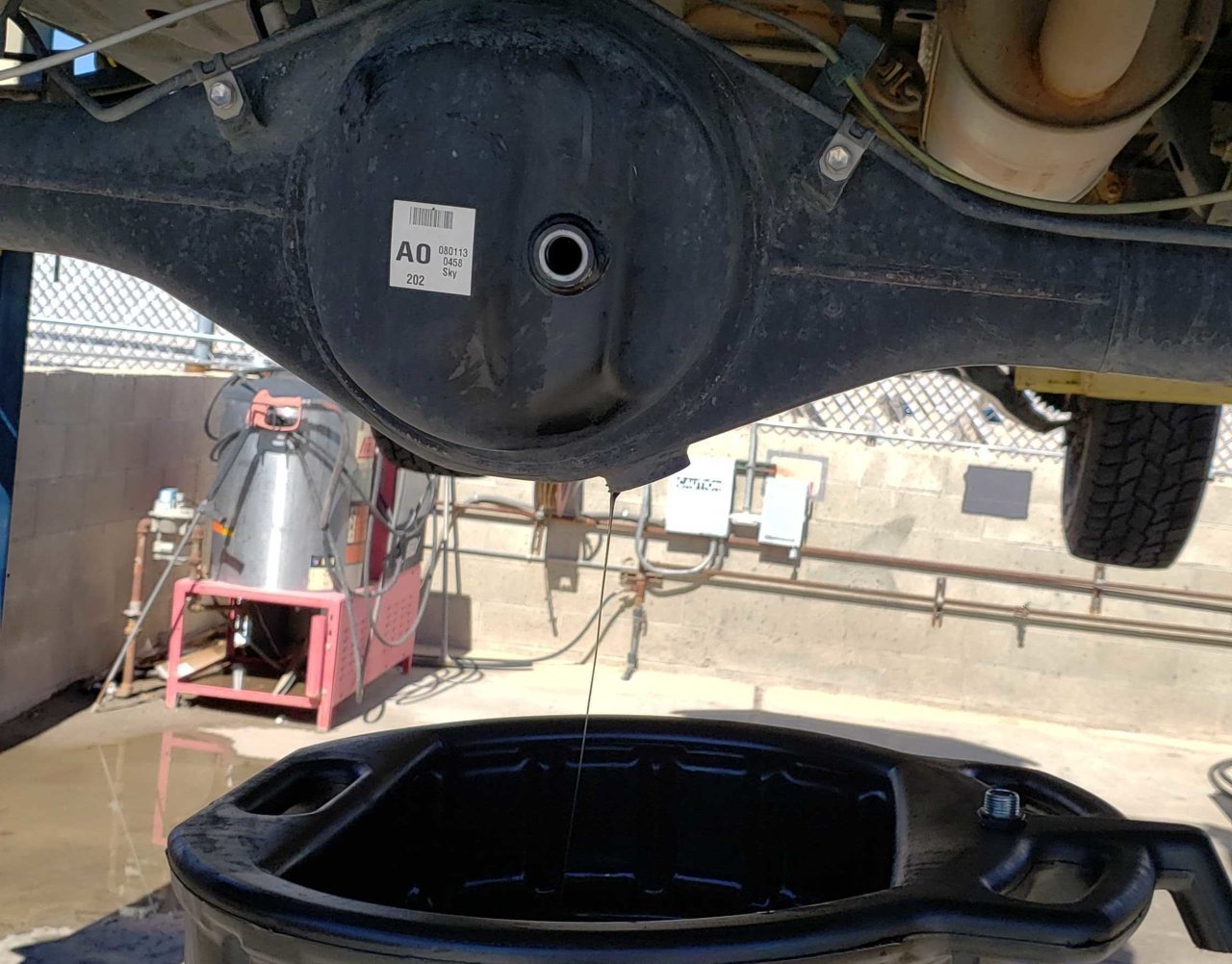

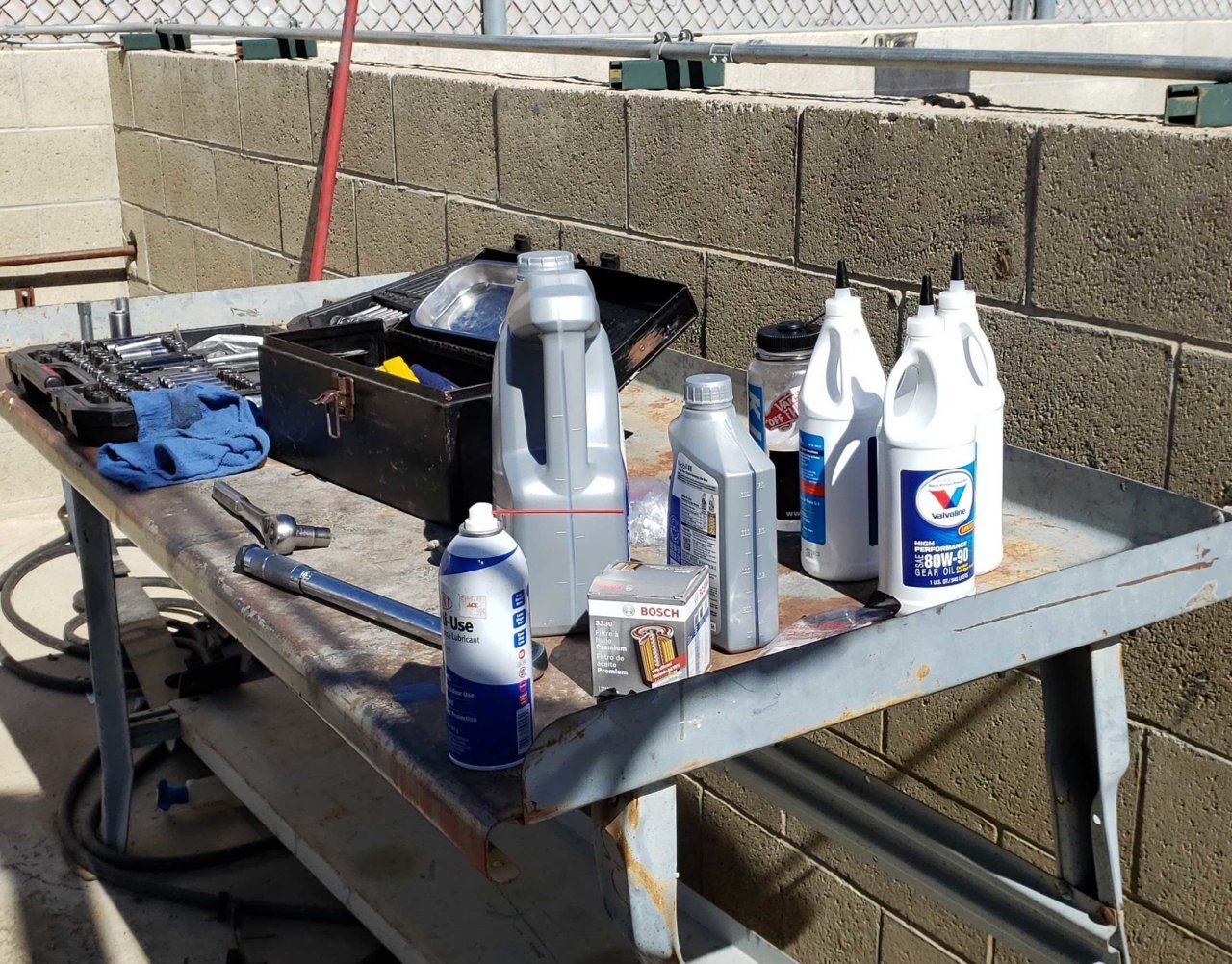

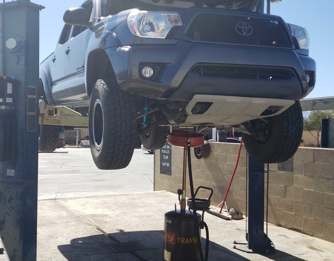

    Some routine 60k maintenance

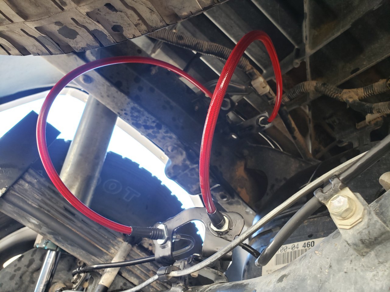

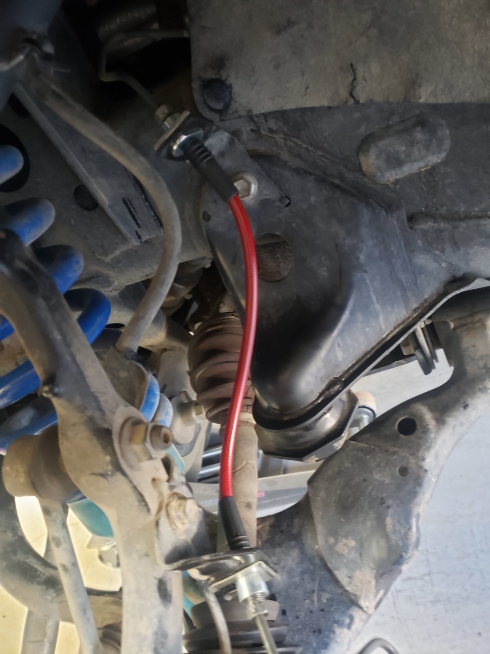

    More recently I installed some Wheelers offroad EXT brake-lines that I bought with the suspension but never put on. Ask me why and I couldn't explain what took me so long :lalala:

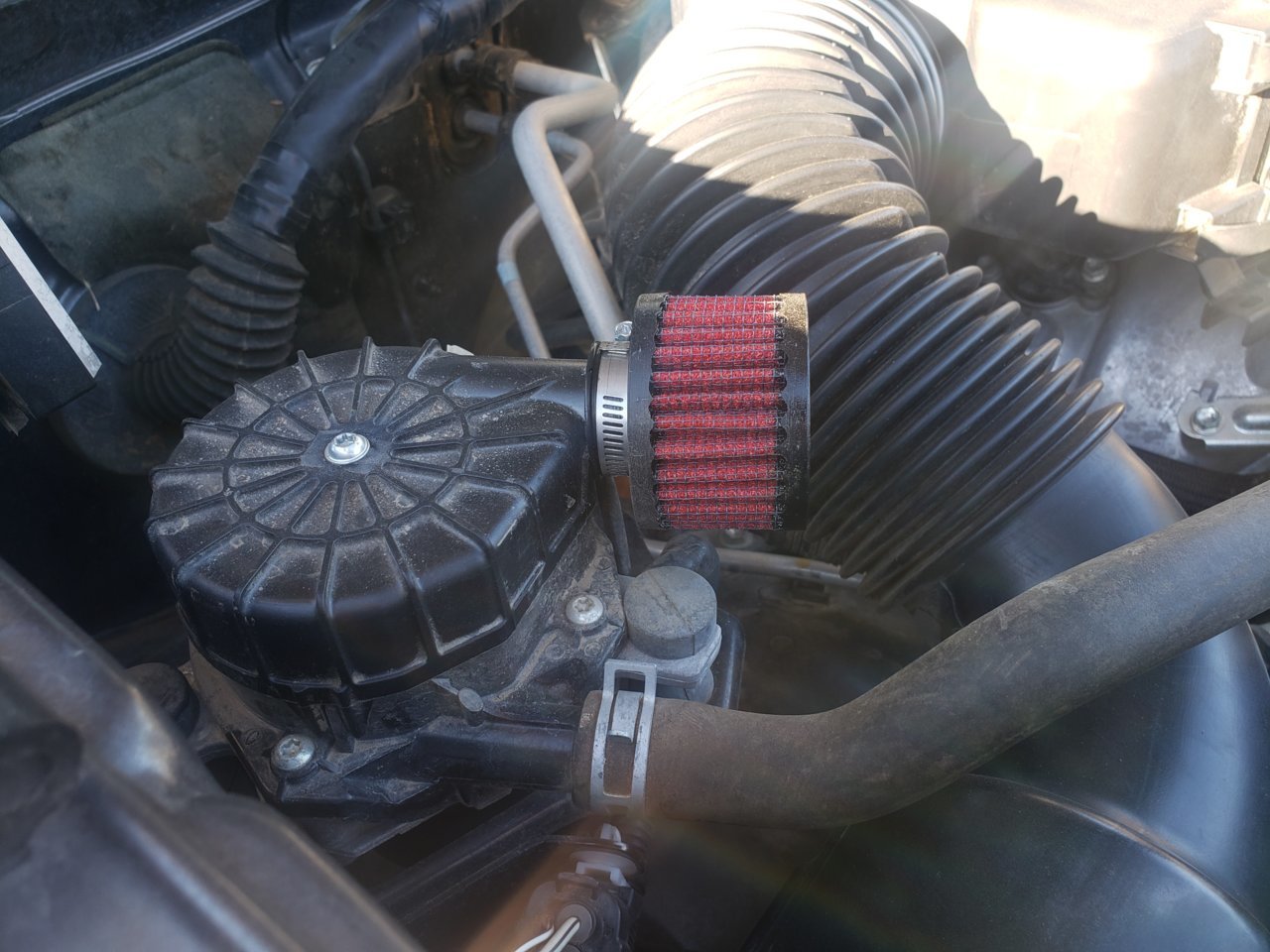

    Also installed the notorious Uni-filter as well as the super easy to use rear diff breather kit made by Blais Bros Tacos thanks to @Blais03 and @LivinLoud
