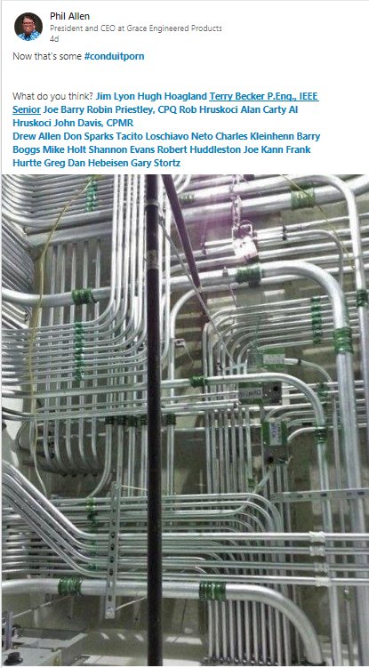

    How about this for conduit installation? :eek:

    Penthouse type stuff right there

    They fucked up their parallel offsets in the lower left.

    All things considered this easily could have turned a mess like this:
