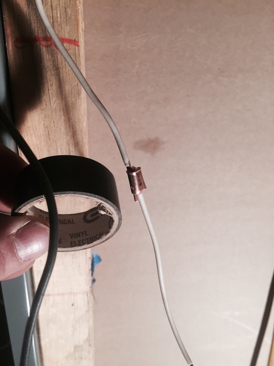

    There's no way you could pull wire through that mess. I think incorrect connectors are more likely than a 1000' reel of 2" greenfield in attempt to steal the record for biggest code violation.

    They make MC connectors for every size MC cable.

    I’ve personally ripped it before. It’s ridiculous.

    Use a wire nut. KISS.

    Ha! I see what you did there! But ya using a ground grimp and tape to connect two nuetrals together isnt generally an acceptable method.
