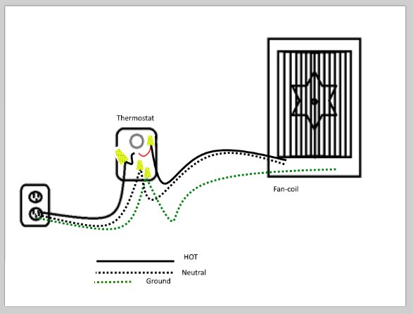

    So I want to replace my garage hyrdonic heater. I can do the plumbing part. The current thermostat is is plugged into an outlet and then the heater is wired to the thermostat. Fan in heater kicks on based on temp. I'd like to replace it with something similar. I've searched and haven't found anything. Most of what I find invloves wiring a low voltage thermostat back to the boiler. This heater isn't on a zone that's controlled by a circulator pump - it's a straight loop from the boiler so there's always hot water in it and the fan kicks on based on the temp. I don't mind that setup as I've always got a little heat output. Any help is appreciated. Oh - I only run this heater from Nov-April. When it's not used, I simply unplug the unit and shut off the supply & return valve near the boiler.

    What you're looking for is something along the lines of this: https://www.amazon.com/dp/B00KRJLX5K which would require a box for the unions to be made within.
    This might be a more simple solution if the new unit comes with a cord: http://a.co/b42RGC6 Plug in and go!

    I'd imagine it would be like this. Usually they come with a wiring diagram. Essentially the thermostat is just a temperature controlled switch. The picture on Amazon only shows a black and red wire so this is my assumption.

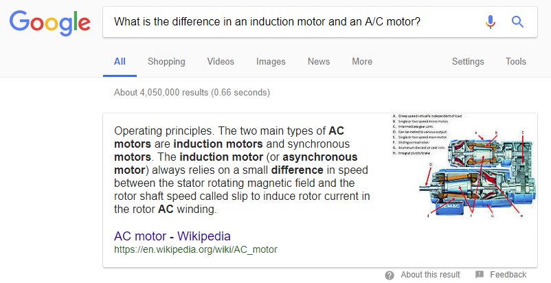

    What is the difference in an induction motor and an A/C motor?
