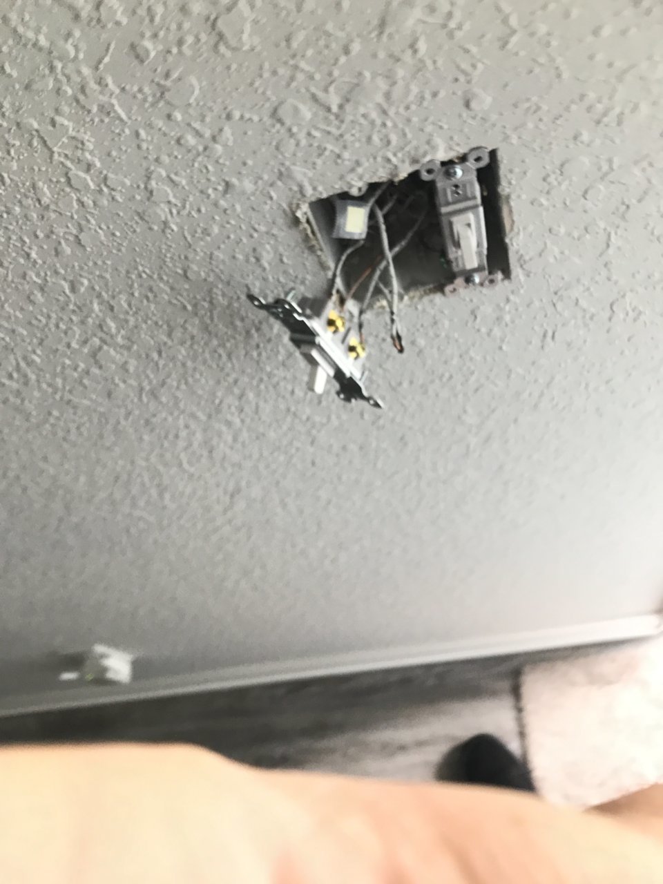

    Hopefully an ok-ish photo. Trying to figure out which wire is which. I am replacing switch with one that is timed and every wire is black. The random one on the right that is looped was around the bottom screw and going from the back bottom hole of the switch next to it.
    New switch has black, blue and white. Black is line, White is neutral, Blue is load according to diagram and can’t figure out why I am not getting power.
    Lastly, where do I connect the ground? New switch doesn’t have one.

    Is it a three way switch? The wire that was looped to the other switch is probably the power.

    My ground wire was bundled with the rest of the grounds in the box.

    it's a single switch as far as I know, only thing it controlled was the porch light.

    can you check voltage with meter? are you installing a smart switch that needs ground?

    checked voltage, top one came out as 122 or so. it's a plain old fashioned timer switch, not smart in any way other than following a schedule, just saw an extra wire that the new switch didn't have a spot for.

    Black wire on the new switch to the wire coming from the other switch. It’s most likely the power. Blue wire to the other wire from the old switch. Tie in the neutral from the new switch to your neutrals in the back of the box. Weird that the new switch doesn’t have a ground. You’ll be fine without it tho
    If you have a meter and know how to use it turn off the switch and see which wire is giving you a voltage reading. That will be your power. The wire not showing a voltage is the one going to the light

    nope. got put it back to original...aint gonna mess with it. this house is p****g me off.
