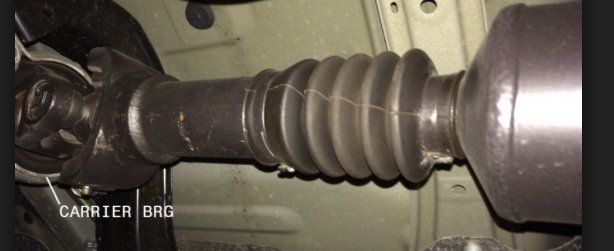

    Unfortunately no this would require you taking apart the back half of the drive shaft. You would need to unclip the rubber spline boot around the rear drive shaft -this is where the splines are on rear drive shaft that are binding up, and unbolt the rear of the drive shaft from the differential and slide the rear portion of the driveshaft off. From there you would apply a thin layer of the Teflon lube on the splines and slide it back into place.
    Take Note:
    1) you will want to make sure that the rear of the truck is on jack stands and on level ground with front wheels chocked so the truck doesn't roll away.
    2) Make sure to mark on the drive shaft of exactly where the back portion of the drive shaft aligns with the yoke, since these driveshafts are balanced and if you don't put the rear of the driveshaft back on in the same spot could throw it out of balance. I just used some of my wifes finger nail polish to make these marks on the driveshaft and yoke.
    3) you can simply use a zip tie to re-attach the boot back onto the clip you had to remove.
    picture of spline boot
