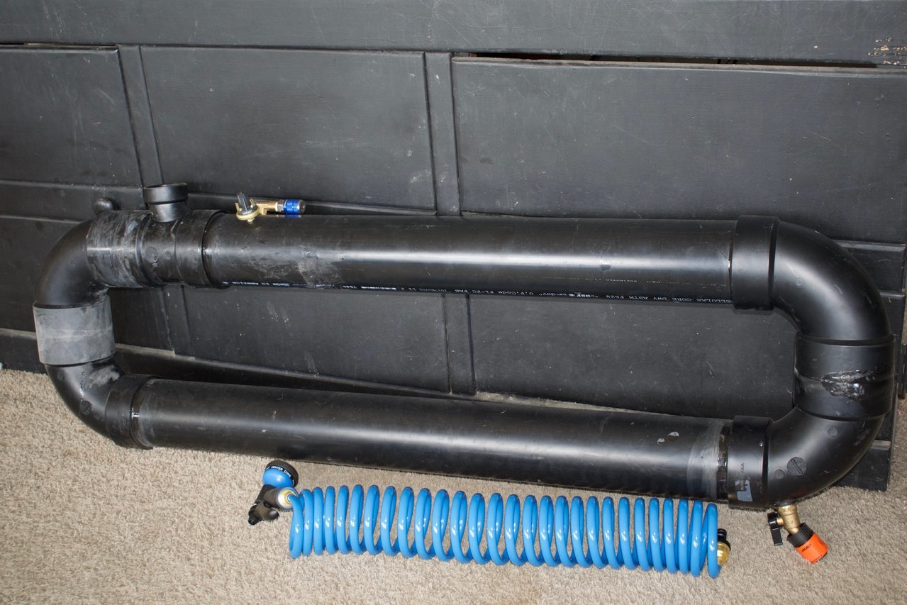

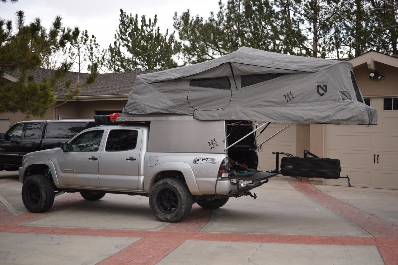

    Couple recent pictures, not camping but I had tent up while installing interior L track... Speaking of that the rivet nut setter I posted earlier in the thread ( https://www.amazon.com/dp/B073VK3B7S ) is amazing. Literally takes seconds to set each rivnut.DSC_1889.jpg
    And here is a teaser of the On board water I have been working on. Will do some more sanding and paint in rustoleum textured black...It will be hung on the passenger exterior wall using Ltrack. Hopefully it will pick up quite a bit of solar heat when in sunlight. Im also working on developing some sort of heat exchanger to run on my coleman.
    In short, I hardmounted a Viair 450 in engine bay, ran a line to the rear bumper with quick connect, that will pressurize the tank, It can also be used as gravity feed. I have a 20psi shutoff switch installed now, we will see how I like the pressure with that. Im terrible at math but Im pretty sure capacity should be at ~7 gallons which is great for us.
    Im also trying to figure out how I can utilize the space between the pipes for mounting the coil air hose and coil water hose. Any ideas?
    Ill try and do a more in depth write up when I get it all up and running.
